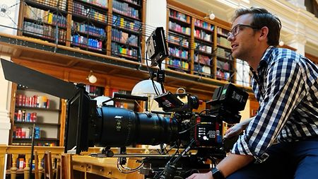

2-arri-signature-zooms-mini-lf-logan-schneider-arnold
DP Logan Schneider and Signature Zooms in Vienna
Not wanting vintage lenses that felt too different, Schneider relished the opportunity to utilize cleaner, more modern glass, which emphasized his subject. The series’ main interviews with Arnold Schwarzenegger featured Signature Zooms of 65-300 mm and 45-135 mm, which created the sense of intimacy that Schneider and director Chilcott so desired, and in turn, allowed for more flexibility in movement in addition to the optimal visual characteristics. The DP explains: “This is the only set of zooms I’ve ever seen on digital cameras where you feel like there’s not a difference between the zooms and the primes. The primes’ only major advantage now is that besides size, they are a stop faster, but outside of that you really can’t tell without a chart, and even then, it’s subtle. They were exceptional. The last time I’ve seen a match like that is when the original Optimo zooms and the S4s were on 35 mm celluloid. 15-20 years ago, you could put those on film and it would feel seamless, so it’s been more than 15 years waiting for that to come to digital, and the Signature Zoom is the only one to have pulled it off.”

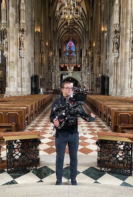

While a large portion of the shoot did center on the sit-down interviews, there was a component built into the series’ recreations of Schwarzenegger’s stories and memories, otherwise referred to as “original photography” by Schneider. The “original photography” and verité (or interviews) were separate and very different. The verité scenes were usually handheld or easy rig, but the “original photography” was constructed like a narrative shoot, with specifically directed shots, often on a dolly or Steadicam. Additionally, some aspects of the interviews with Schwarzenegger featured peaks and valleys of energy from the subject, and Schneider knew that interrupting the constant activity of Arnold would all but derail the documentary’s honest and intimate nature. With a c-force motor attached to a left-hand Master Grip, Schneider enabled himself to pull focus with the feeling of having an experienced AC on set giving the documentary the refinement of high-end remote focus. “If I hadn’t had the Master Grips, it would not have functioned the same at all,” he recalls.

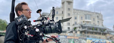

While the shoot ran without much of a hitch, Schneider did recall a certain instance that presented itself as a challenge initially, though the use of ARRI Signature Zoom lenses aided in alleviating all concern in matching during post. “It’s difficult to keep up with Arnold. We filmed [Arnold] in a tank with me inside and then on top of his vehicle with 16-32 mm Signature Zoom. It was so tight in there, I couldn’t have the camera fully built. I had a battery belt made to support all the accessories, so I could jump off, and put it on a tripod with a  65-300 mm on the camera in about 40 seconds with AC John Parson. Arnold just kept going until we got all this great tank footage. The two of us raced as fast as we could enjoying the freedom those two lenses provided. I didn’t have to worry about whether it would match the sharpness of the primes. We just really shot on those two lenses and got everything and had a dynamic sequence without waiting.”
3-arri-mini-lf-master-grips-logan-schneider-cathedral-ARNOLD
DP Logan Schneider utilizing Master Grips and Mini LF

4-arri-mini-lf-signature-logan-schneider-tank-Arnold
DP Logan Schneider embraced an energetic and dynamic approach to filming the documentary’s live elements
