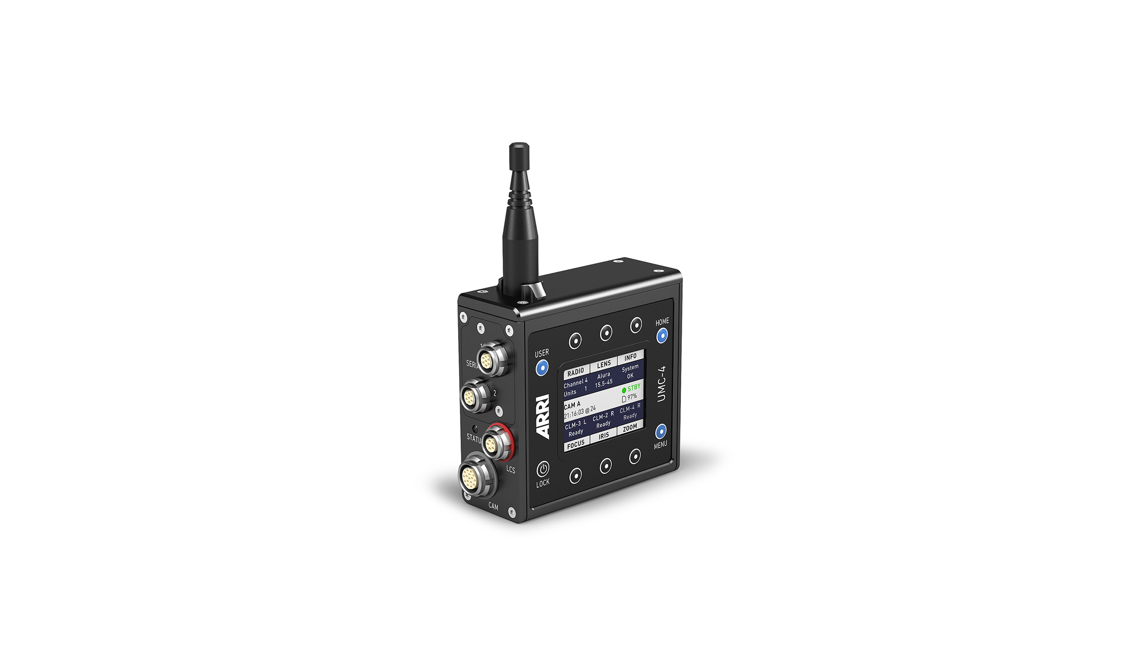

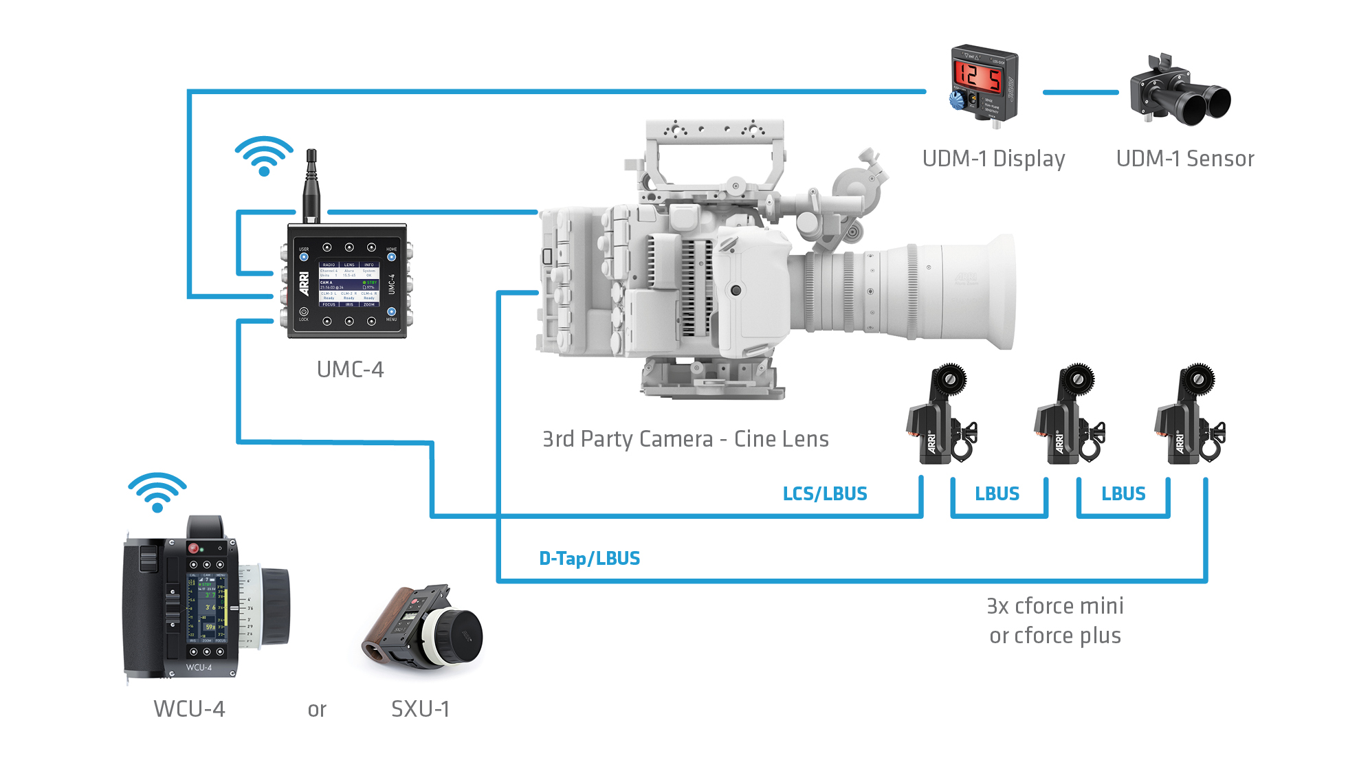

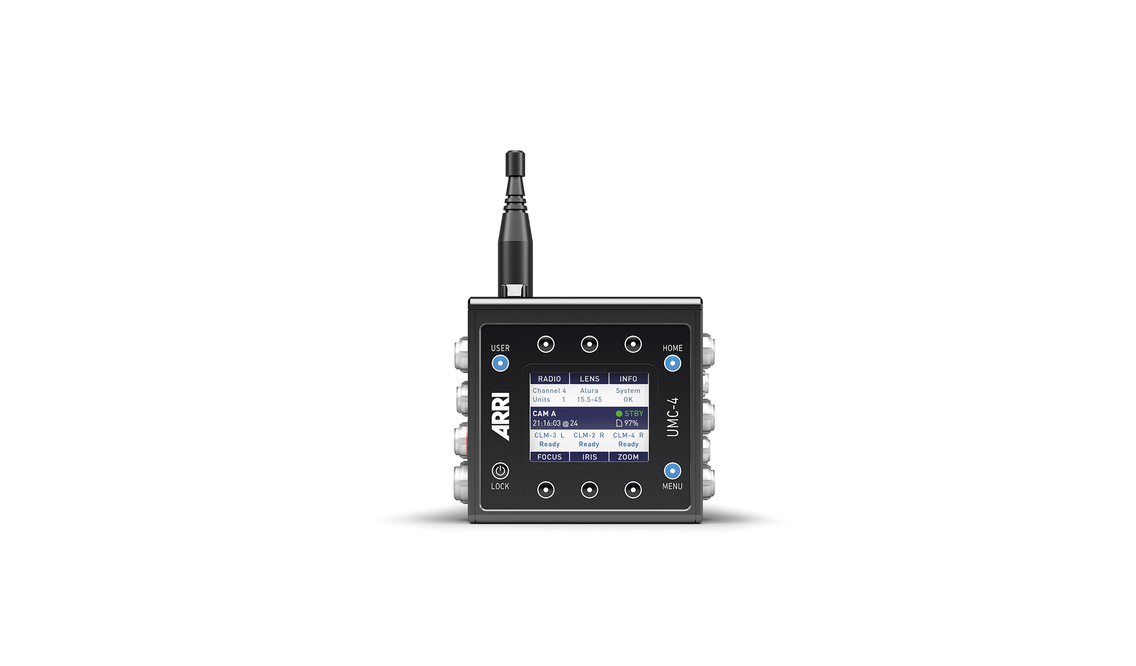

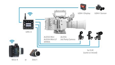

The Universal Motor Controller UMC-4 controls focus, iris and zoom on any camera and provides vital lens data and tilt-and-roll information for set and VFX postproduction.
Features
Best overall production value UMC-4

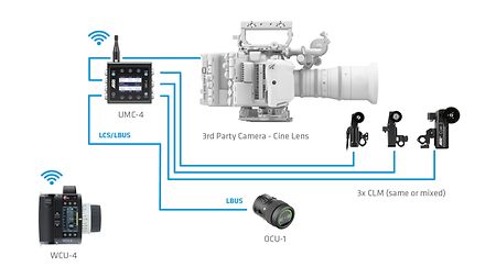

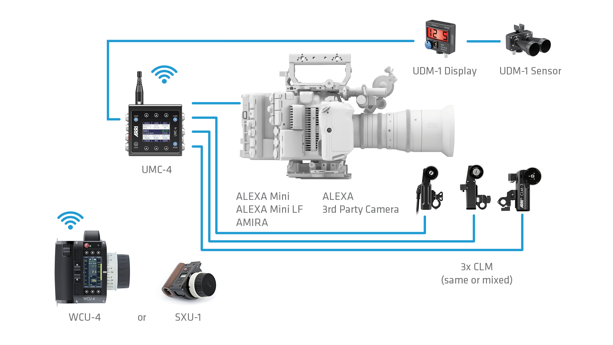

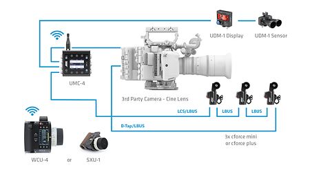

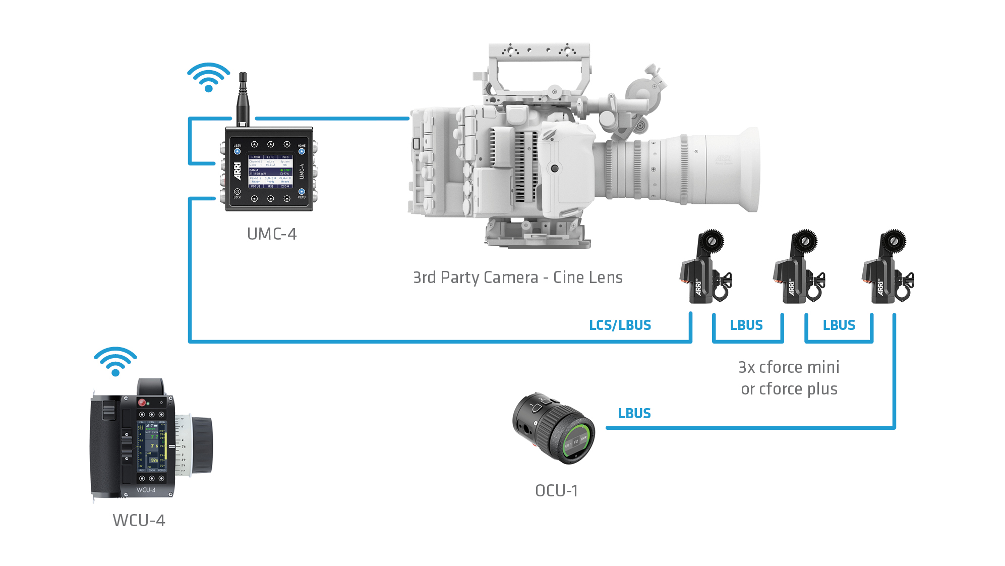

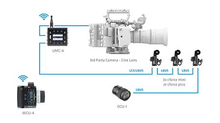

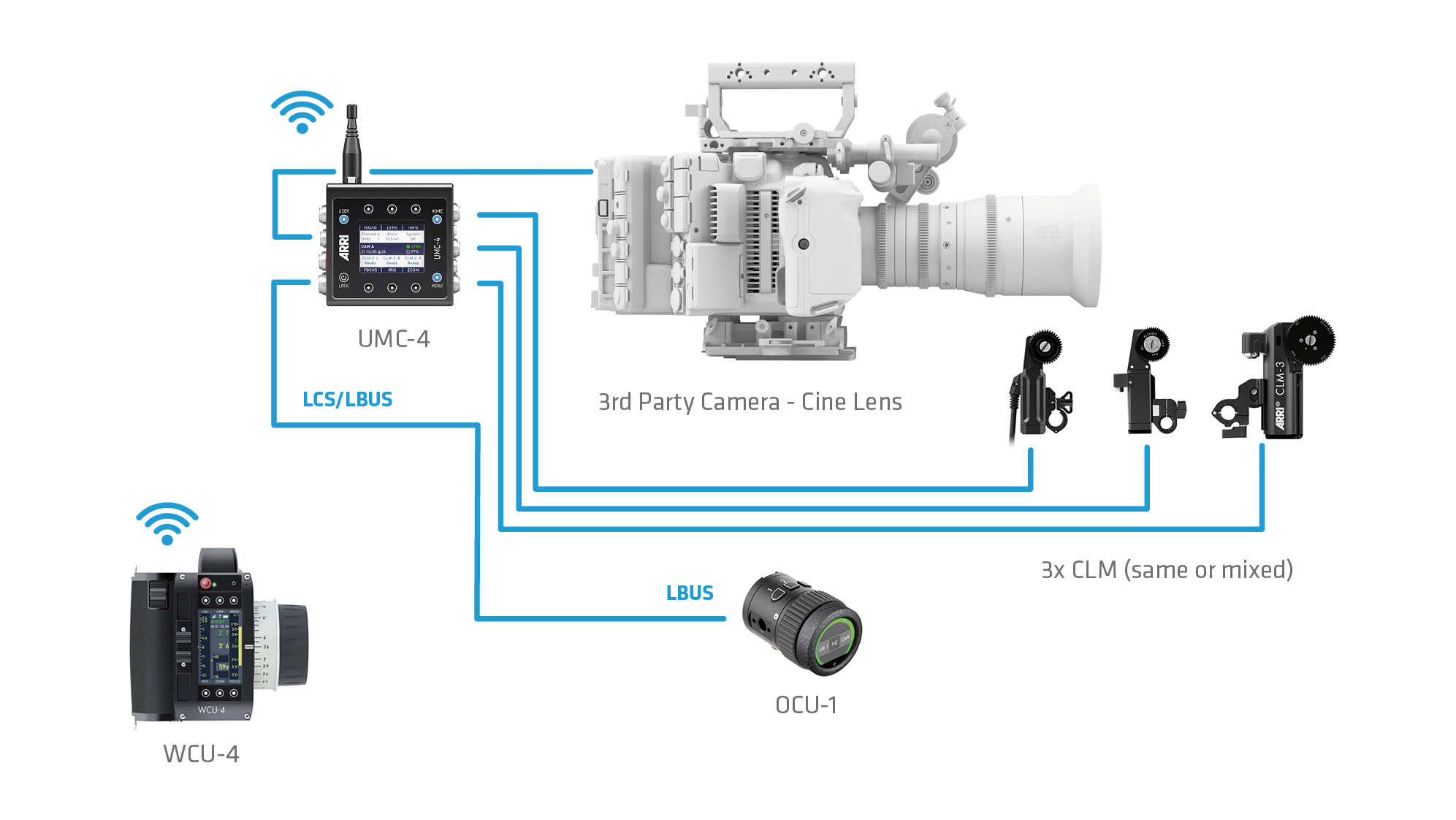

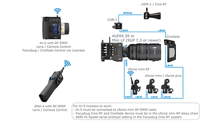

  • 3 Axis Lens Control: The Universal Motor Controller UMC-4 is an advanced 3-axis motor controller. Up to three different hand units can connect to the UMC-4 at the same time, controlling focus, iris and zoom on any camera.
  • Lens Data: The UMC-4 incorporates the LDS Lens Data Archive and generates frame-accurate lens data with any lens. Lens data is used for lens mapping to pre-marked focus rings and depth-of-field display on the Hi‑5 and WCU‑4 hand unit.
Useful features UMC-4
  • Timecode: The UMC-4 supports internal and external timecode that is recorded with frame-accurate lens data onto SD card, making the lens data usable for postproduction. The internal timecode clock can be jam-synced from external devices, but can output LTC timecode as well.

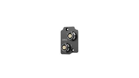

  • Multiple Interfaces: The UMC-4 includes multiple interfaces for maximum flexibility on set. Two serial interfaces connect peripheral equipment such as ARRI’s UDM‑1 distance measure or motion control systems.
  • Override Function: Supports the OCU‑1 and Master Grips lens control override feature of the Hi‑5 and WCU‑4 hand unit.

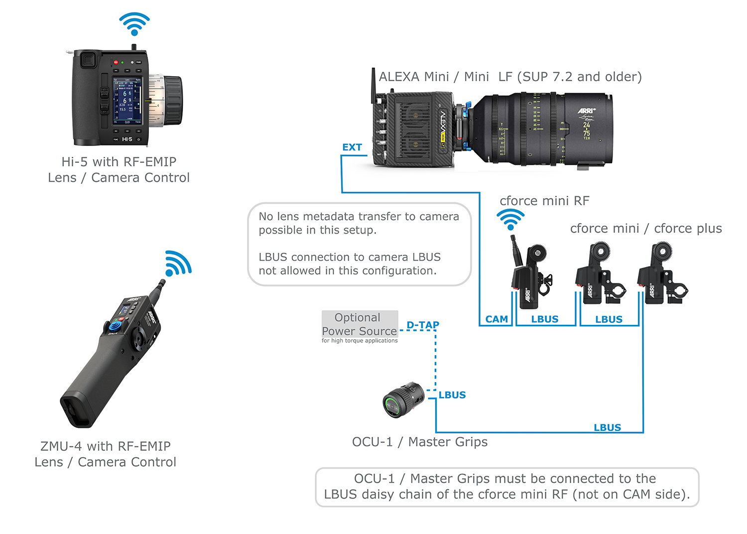

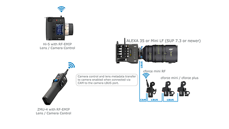

UMC-4 + CLM motors
Override Function available
UMC-4 + cforce mini/plus motors
OCU‑1 – UMC-4 + cforce mini/plus motors
OCU‑1 – UMC-4 + CLM motors

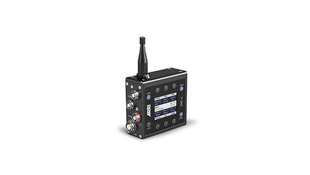

Three mini motor controllers provide optimal solutions for wireless setups where size and weight matter: the Single Motor Controller SMC-1, the ENG Motor Controller EMC-1 and the Active Motor Controller AMC-1.
Features

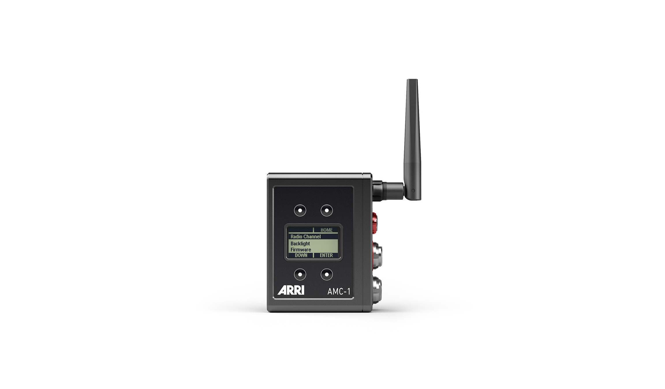

K2.0005872

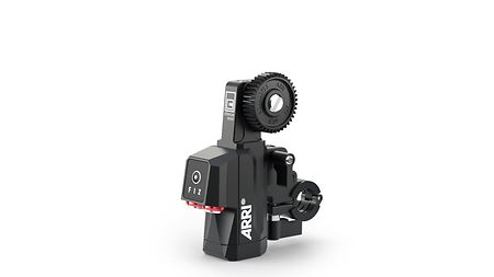

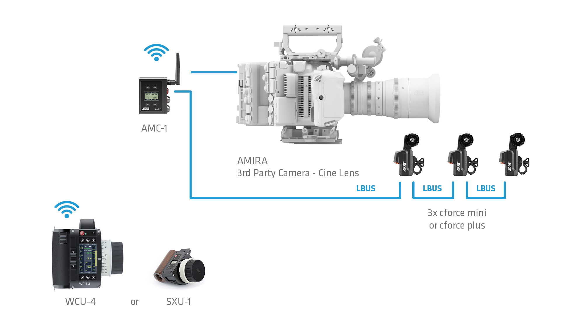

- Compact motor controller with an LBUS interface connecting to up to three daisy-chained cforce motors.
- Works with Hi‑5, WCU‑4, SXU-1, Master Grips and cmotion pan-bar zoom.

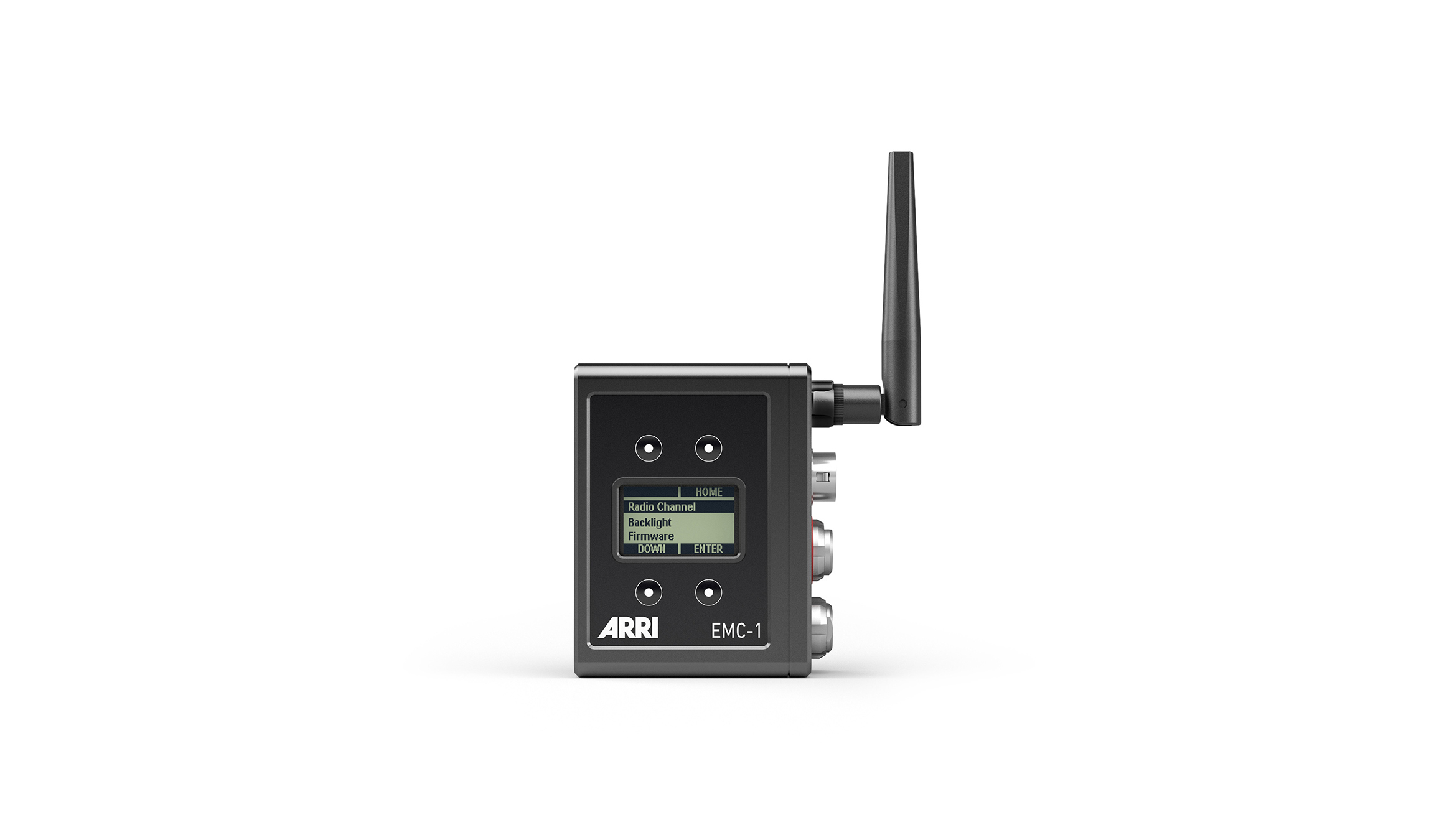

K2.0001474

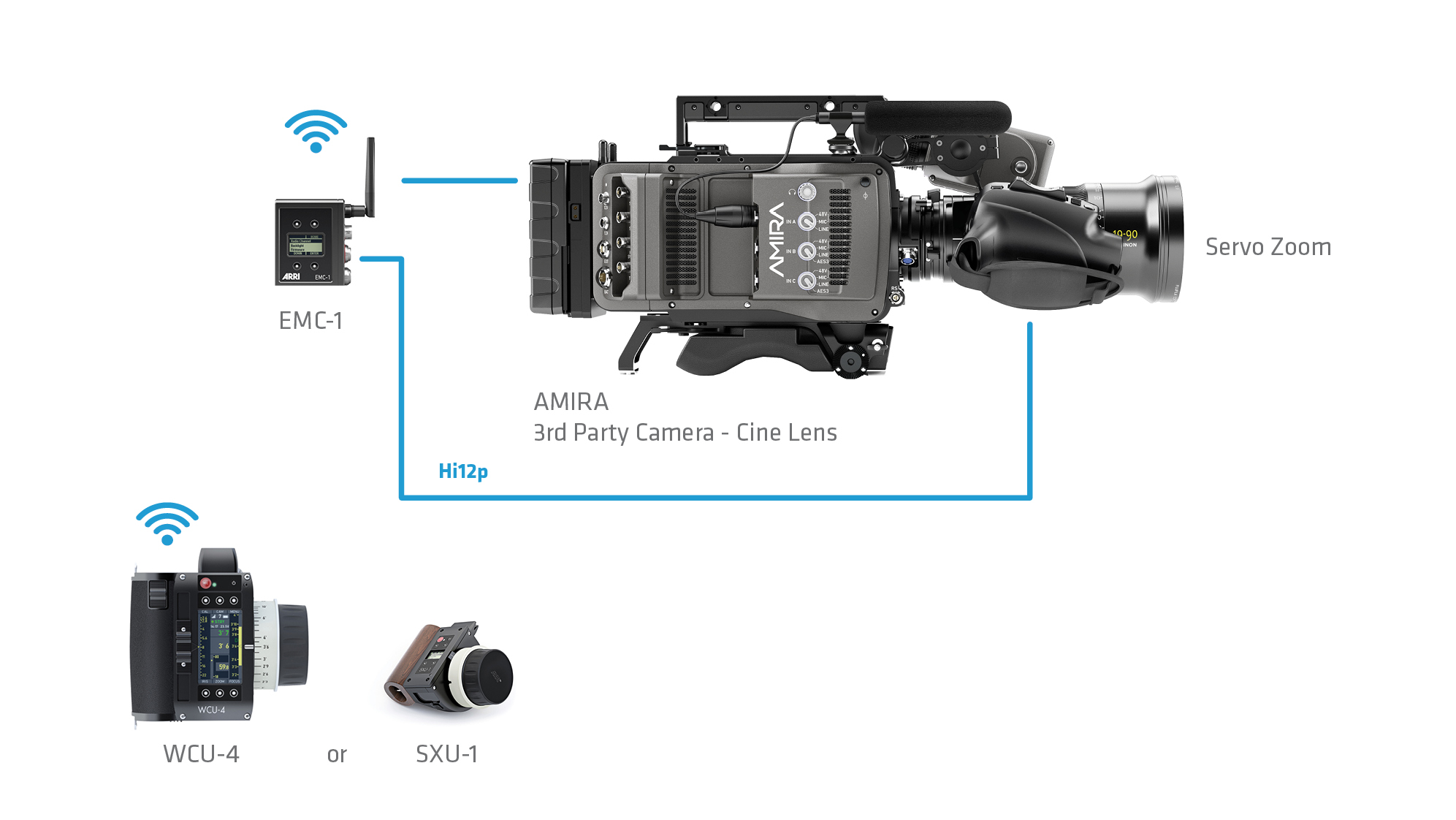

- Motor Controller for use with ENG-type lenses such as Fujinon Cabrio zooms.
- Controls the integrated focus, iris, and zoom motors of such ENG lenses and provides lens data for display on the Hi‑5 and WCU‑4 hand unit.

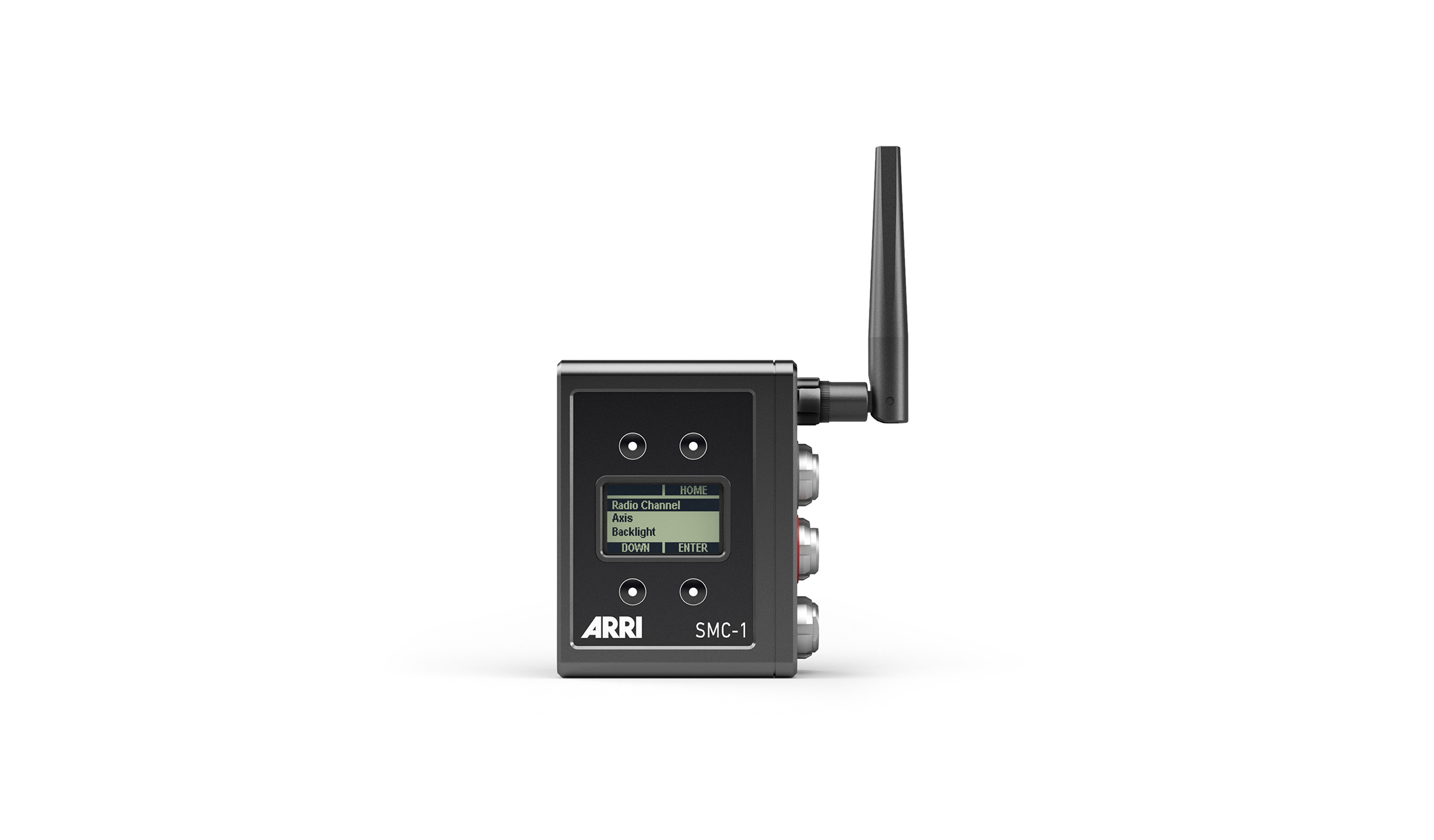

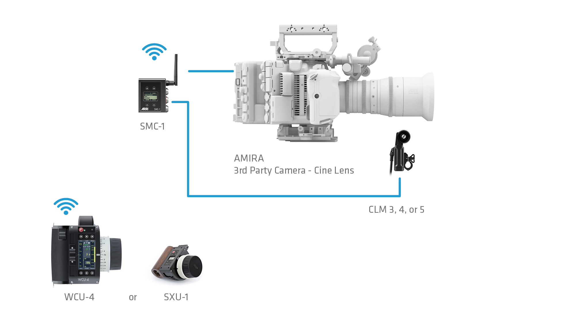

K2.0001469
- Compact 1-axis wireless motor controller designed for weight and size-critical setups such as Steadicam or camera drones.
- Drives a single CLM motor and is the perfect counterpart for the SXU-1 single-axis hand unit.
- Also works with Hi‑5, WCU‑4, Master Grips and cmotion pan-bar zoom.

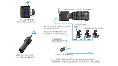

Compatibility
WCU‑4 or SXU-1 + EMC-1 + Servo Zoom lens
WCU‑4 or SXU-1 + SMC-1 + CLM motor
WCU‑4 or SXU-1 + AMC-1 + cforce mini/plus motor

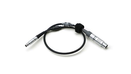

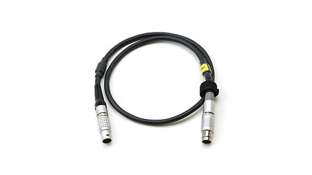

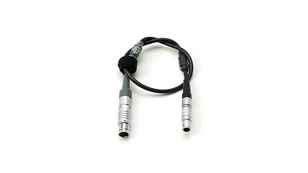

AMC-1 Cables
EMC-1 Cables
SMC-1 Cables

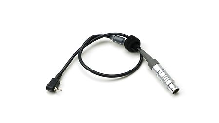

UMC-4 Cables
