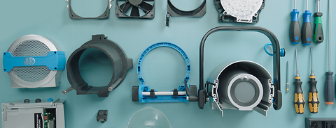

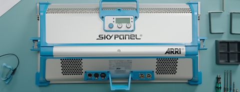

This pre-recorded online training is designed to transfer detailed knowledge about the service and maintenance of the SkyPanel S60 | S120 | S360. Participants will get step-by-step instructions on how to disassemble and reassemble the SkyPanel, learning every action they might be confronted with on set or in the workshop. After completing this training, attendees will be authorized to order tools and spare parts that are not available to others. You get permanent access to your personal online service training library, with pre-recorded videos, up-to-date service manuals, and software download links.
frame_113334
What you will learn
  • Step-by-step disassembly of the SkyPanel S60, S120 and S360
  • Identification and replacement of key components: light engines, fans, control boards, boost boards, and driver boards
  • Performing recovery updates after electronic component replacements
  • Proper reassembly techniques, including securing covers and screws
  • Initial checks and testing procedures to ensure SkyPanel functionality
  • Attendees will be authorized to order tools and spare parts that are not available to others

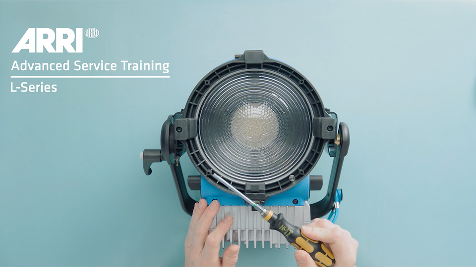

This pre-recorded online training is designed to transfer detailed knowledge about the service and maintenance of the L-Series L5 | L7 | L10. Participants will get step-by-step instructions on how to disassemble and reassemble the L-Series, learning every action they might be confronted with on set or in the workshop. After completing this training, attendees will be authorized to order tools and spare parts that are not available to others. You get permanent access to your personal online service training library, with pre-recorded videos, up-to-date service manuals, and software download links.
frame_113334
What you will learn
  • Step-by-step disassembly of the L-Series L5, L7 and L10
  • Identification and replacement of key components: light engines, fans and control boards
  • Initial checks and testing procedures to ensure L-Series functionality
