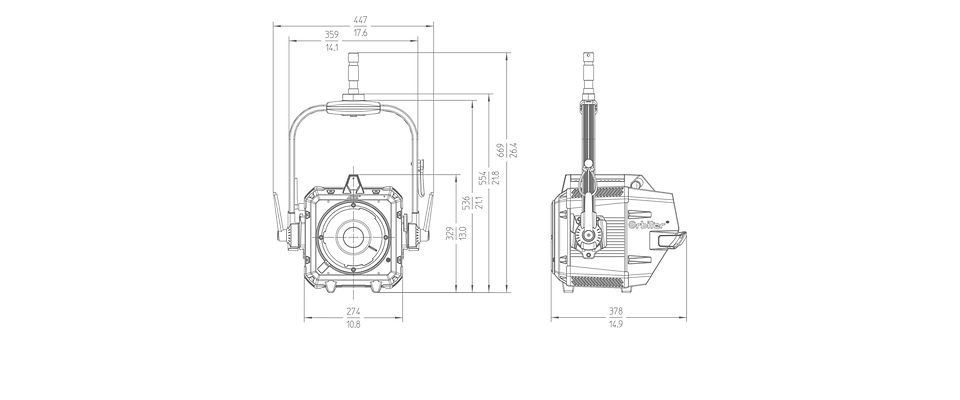

Weight
Fixture only: 11,7 kg / 25.8 lbs
Manual Version: 14,2 kg / 31.3 lbs
Pole Op Version: 14,9 kg / 32.9 lbs
Handling
Aluminum yoke with quick release, high strength tilt lock, pole operation option (pan and tilt)
Mounting
28 mm Spigot (Junior Pin)
Tilt Angle
+/-90° in dry location, +75° / -90° in wet location with rain cover

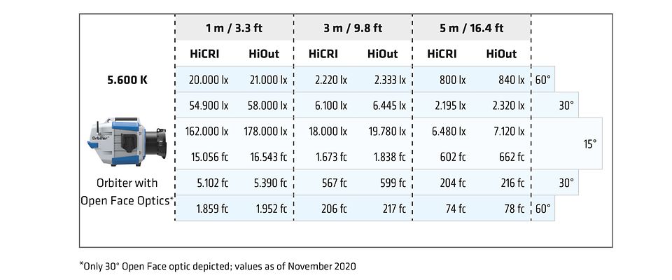

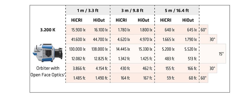

We prepared a photometrics overview with the Orbiter Open Face Optics but you can also download the ARRI Photometric App. It gives you the ability to quickly reference the photometric characteristics, technical specification and more of all the ARRI light fixtures.
