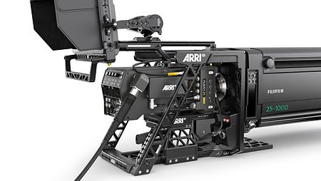

ALEXA 35 Live Xtreme - KeyVisual V4 - 15k - Webpage
Every moment matters
Xtreme frame rates via SDI
ALEXA 35 Live Xtreme delivers powerful high-speed capabilities that elevate live entertainment coverage to new heights. HFR (high frame rate) outputs of up to 8x in HD or 2x in UHD allow the emotion and drama of live events to be broadcast in stunningly beautiful slow motion via standard SDI workflows, enhancing creative options for producers and directors.

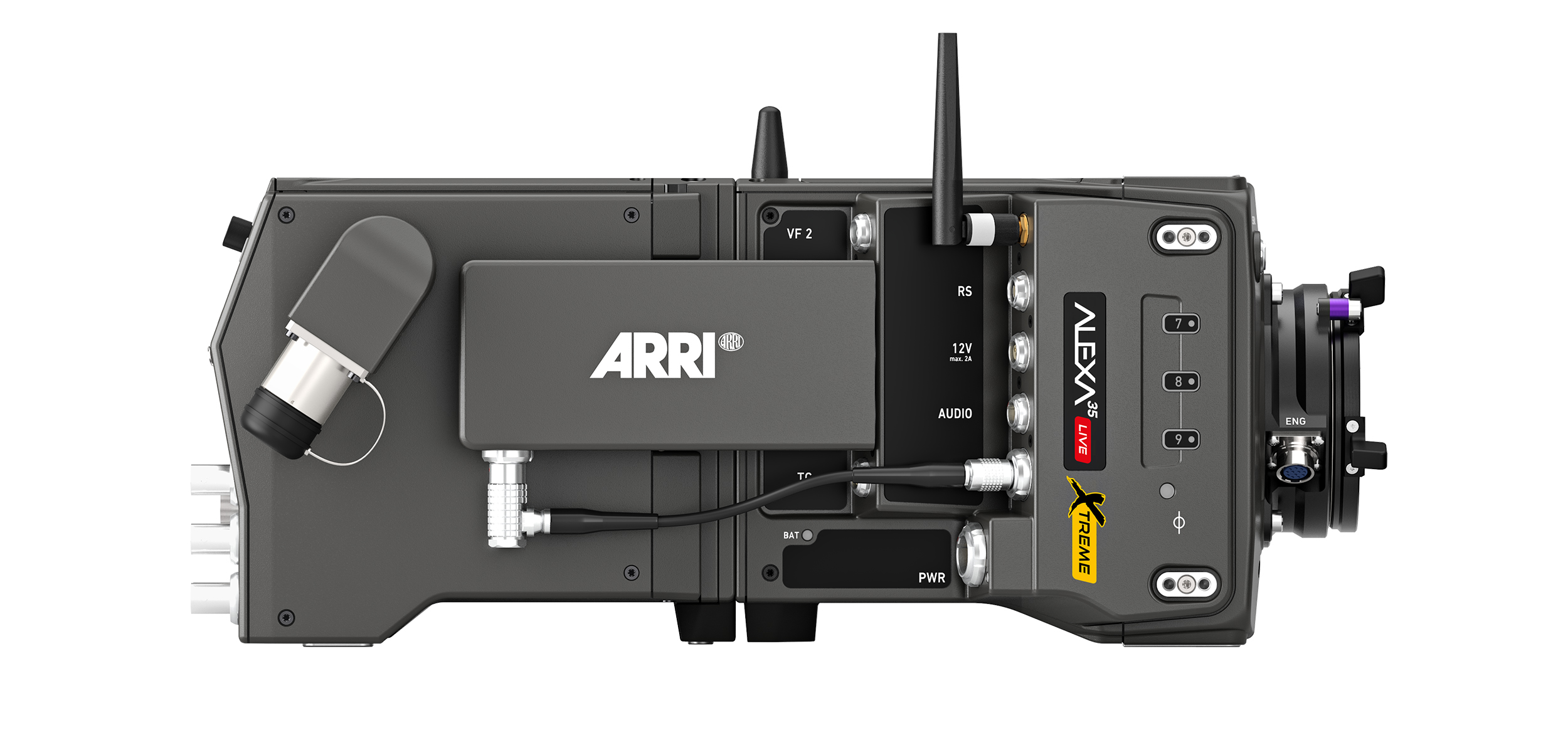

Model
Sensor Type
Super 35 format ARRI ALEV 4 CMOS sensor with Bayer pattern color filter array
Sensor Maximum Number of Photosites and Size
4608 x 3164
27.99 x 19.22 mm / 1.102 x 0.757"
Ø 33.96 mm / 1.337"
Sensor Frame Rates
0.75 - 660 fps
Weight
∼6.3 kg / 13.9 lbs (camera body with PL Mount (Hirose) and Fiber Camera Adapter)
