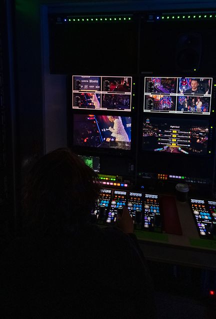

The powerful and customizable Skaarhoj RCP Pro ARRI V2B is offered through ARRI sales channels as part of the ALEXA 35 Live system. Extensive collaboration with Skaarhoj has optimized this bespoke RCP solution, which combines a flexible interface with classical shading control. With its standard Sony RCP form factor and PoE (Power over Ethernet) or AC adapter options, the Skaarhoj is quick and easy to install in OB vans or control rooms.
Since many customers switching to ALEXA 35 Live will want to leverage existing infrastructure, the system is also compatible with CyanView’s RCP.

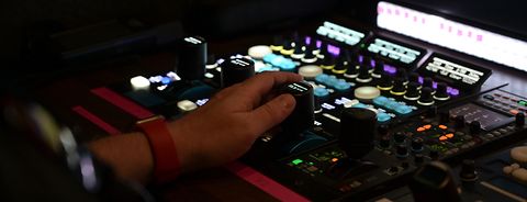

Take full creative control
By using ARRI’s Camera Access Protocol (CAP), the Skaarhoj RCP enables traditional live painting as well as full control over camera settings, including some not covered by other RCPs, such as REC start/stop, playback, and the selection of looks, ARRI Textures, multi-matrix color correction, and setup files.
SKAARHOJ RCP Pro ARRI V2B - front
Configuration features
  • 9 programmable 4-way buttons
  • 9 backlit encoders
  • Customizable joystick display
  • 18 customizable OLED screens
  • 1 large, tilted, customizable OLED screen
  • Simple, free-of-charge software updates
