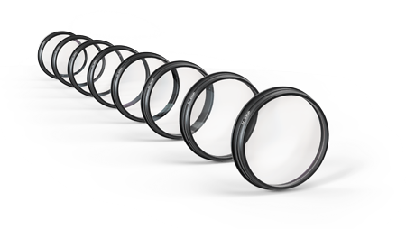

Impression V for vintage looks
Launching the new line of ARRI Impression Filters are eight Impression V Filters that give a vintage feel to Signature Prime and Zoom lenses. The four negative and four positive diopter filters incrementally shift the focus characteristics of the image, allowing a range of detuned looks to be created with one set of Signature lenses.
Ferrari meets Impression V Filter 330P – watch now
Impression V features
Exciting new creative option
  • Cost-effective way to achieve multiple looks with a single lens set
  • Positive and negative filters affect bokeh in different ways
  • Controllable, repeatable detuning of Signature lenses on set
  • Images can be made more glamorous, or grittier
  • Incremental deconstruction of the digital image

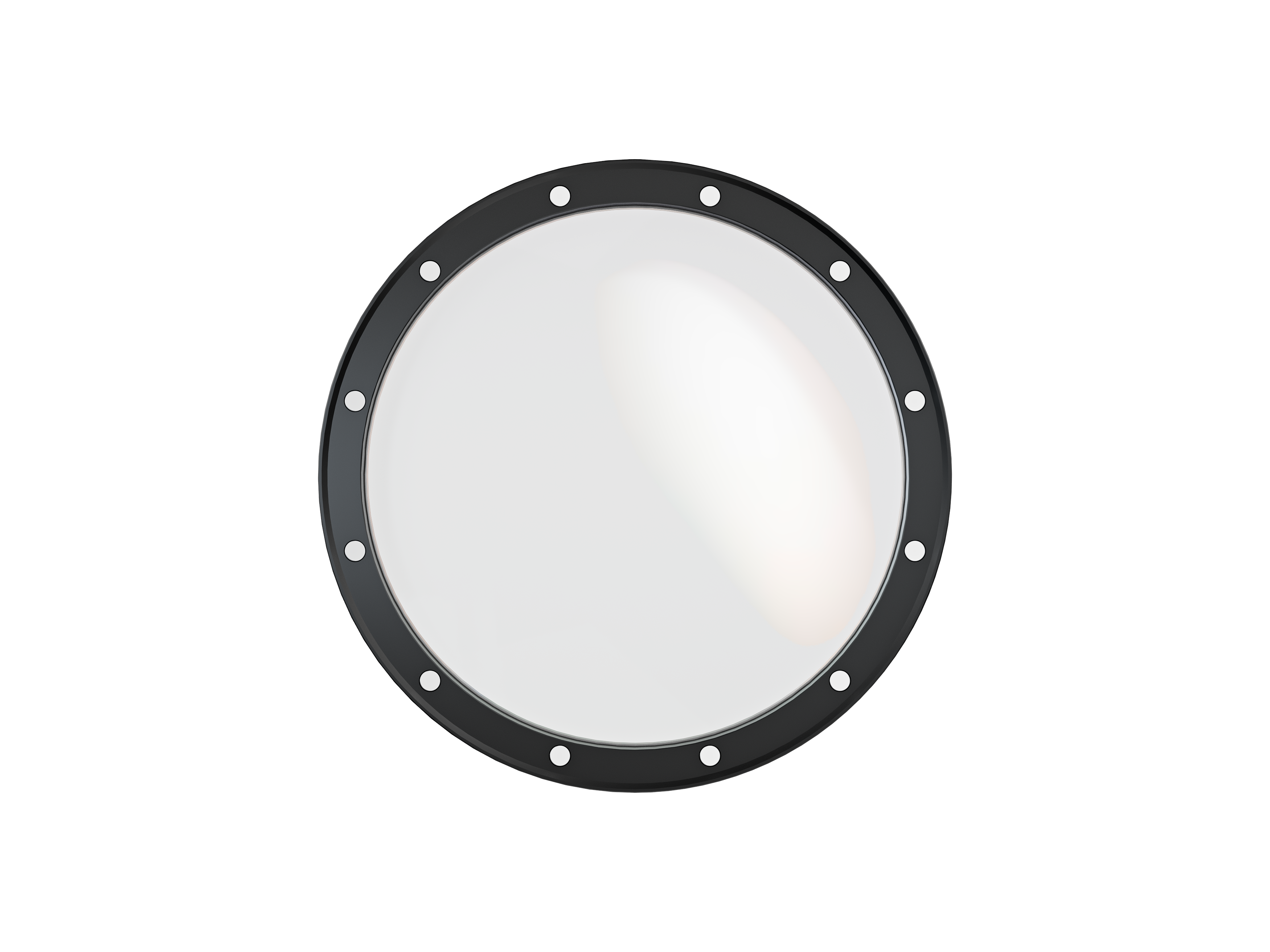

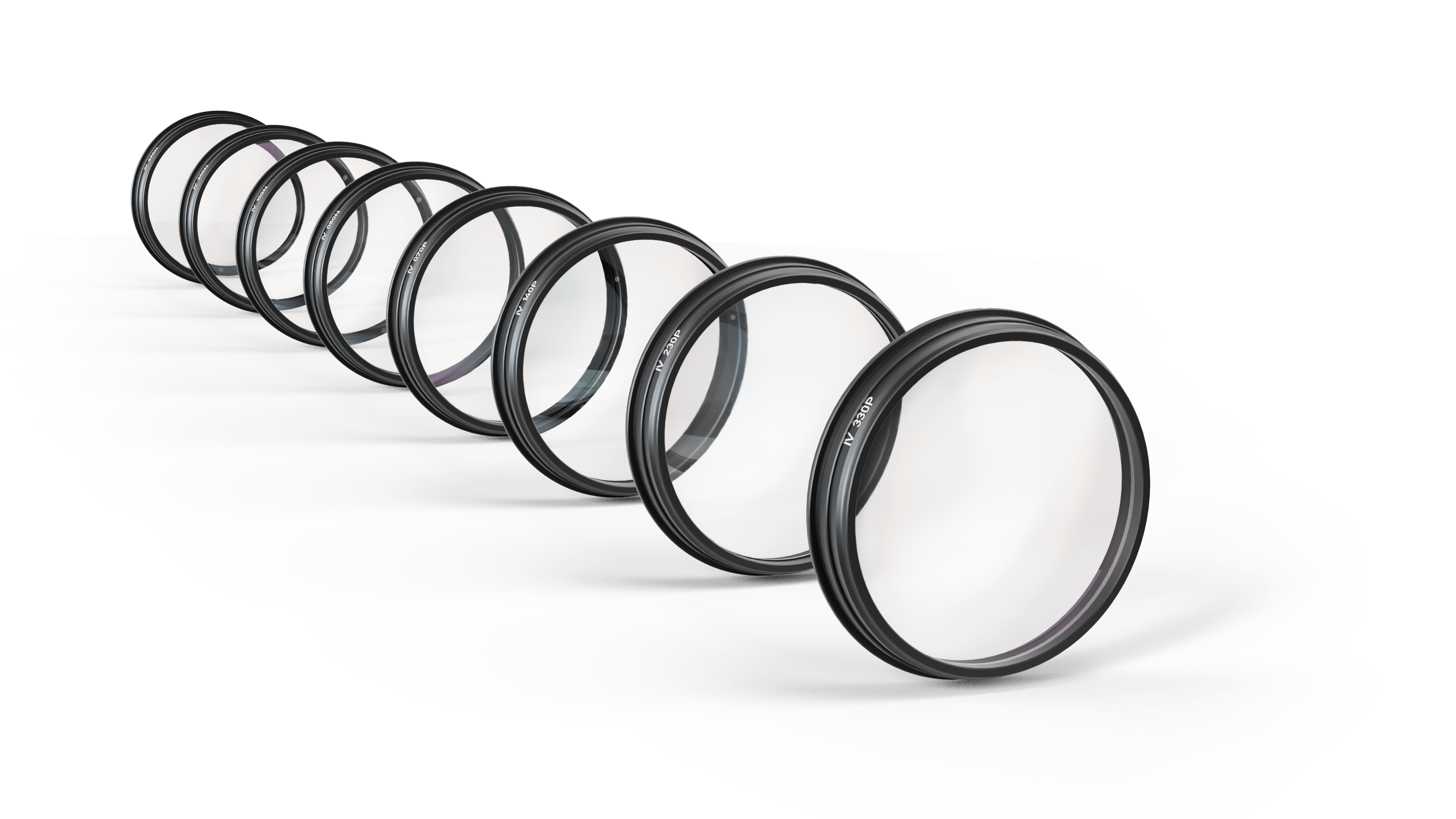

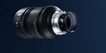

Easily exchangeable rear filters
  • Set of eight diopters: four positive and four negative
  • Fast to exchange via magnetic rear filter adapter on all Signature lenses
  • Rear filters have a different effect from matte box filters
  • Decide on a look in prep, or change the look on set
  • Signatures can be returned to their native look in minutes

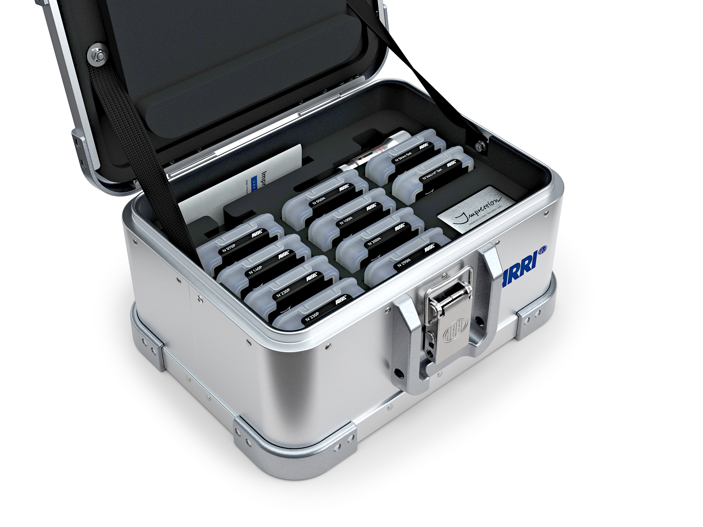

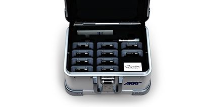

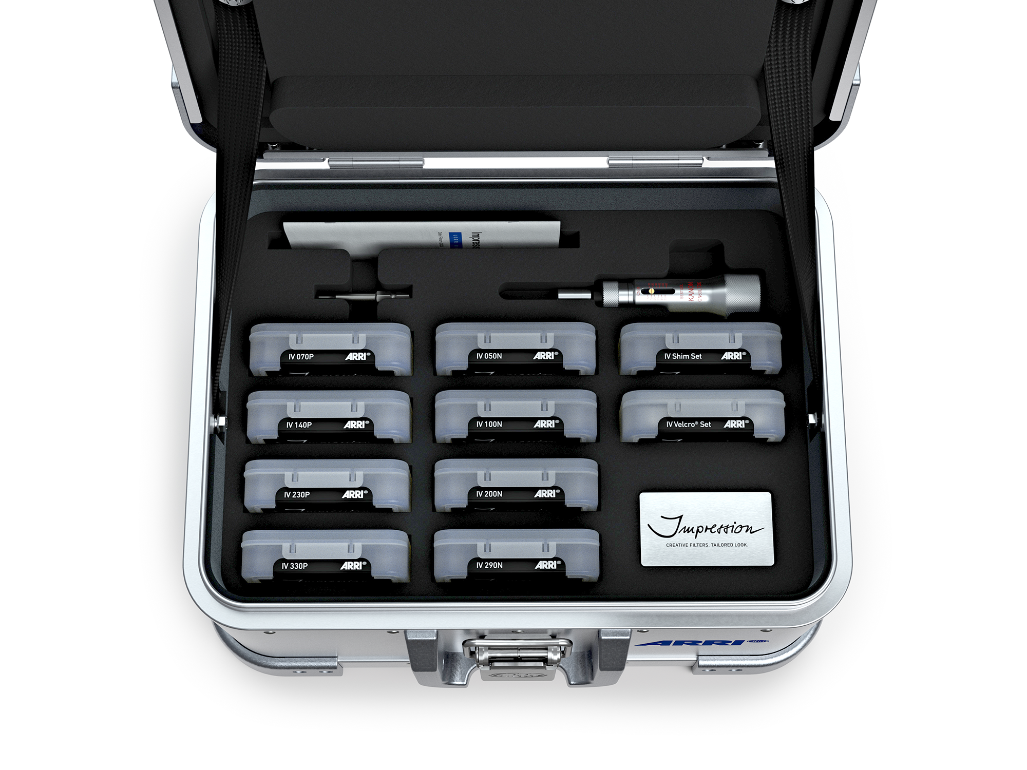

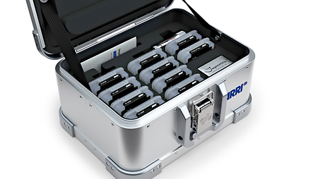

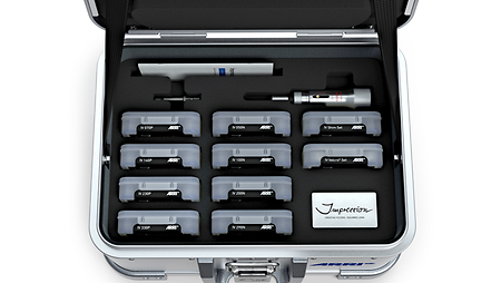

Kit includes everything you need
  • All eight filter strengths, plus shims for negative filters
  • High-end adjustable torque screwdriver
  • Inscribable Velcro tabs for labeling filtered lenses
  • Kit packaged in a specially designed aluminum flight case
  • Filters, shims, and Velcro tabs can be purchased separately

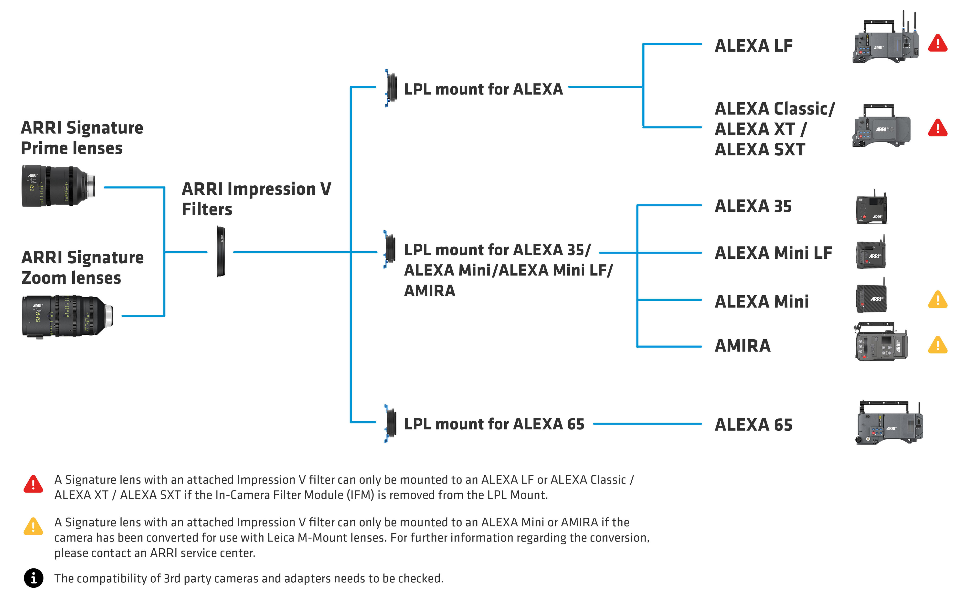

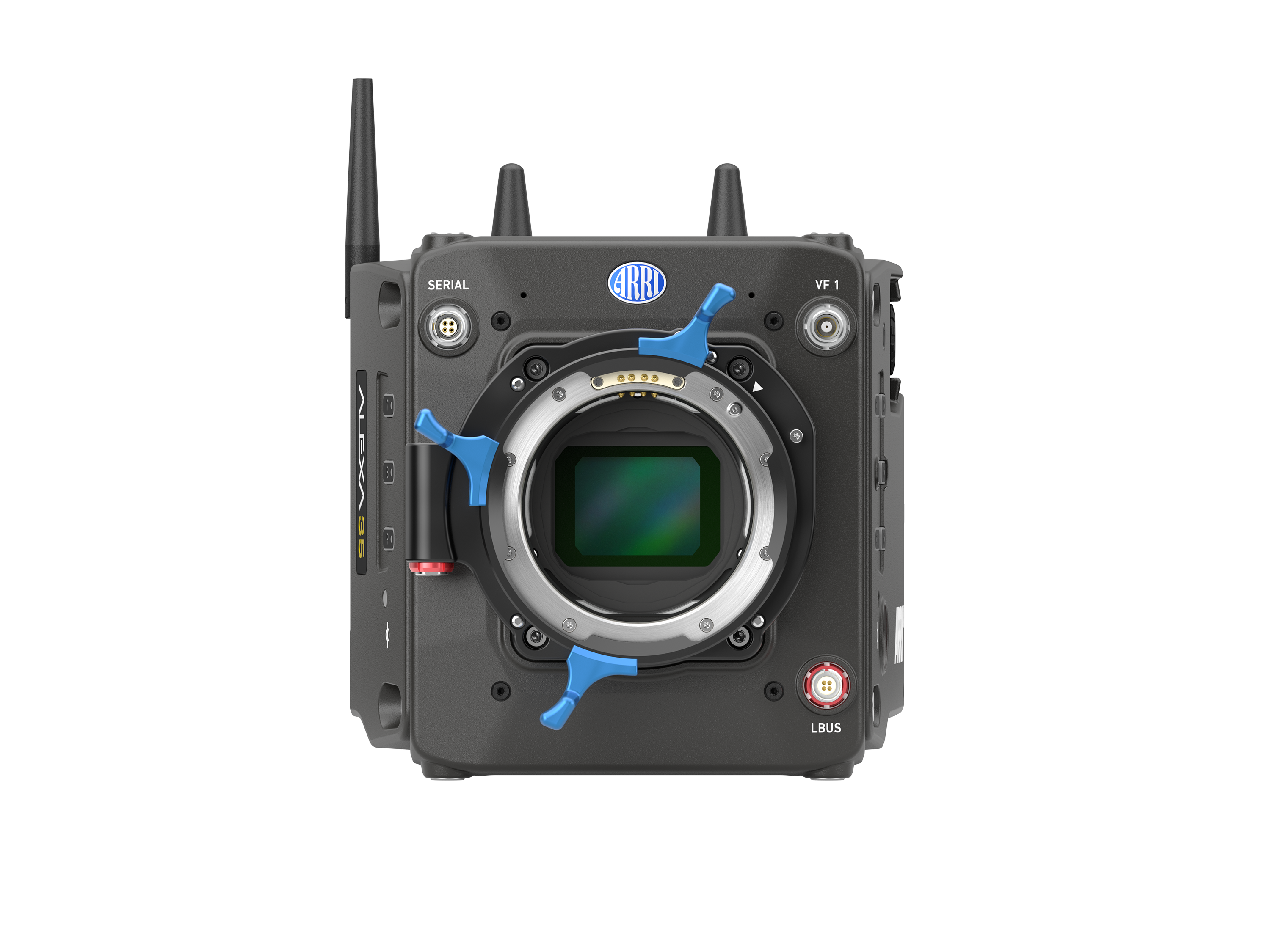

Compatible with most ARRI ALEXA cameras
  • ALEXA 35
  • ALEXA Mini LF / ALEXA LF
  • ALEXA 65
  • ALEXA Classic / ALEXA XT / ALEXA SXT
  • Third-party LPL adapters require testing

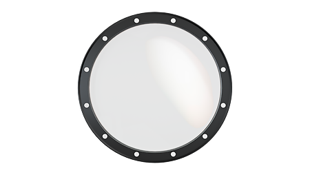

Precision-made optics
  • Manufactured from the highest-quality optical glass
  • Lens scales remain useable at T1.8 (negative filters must be shimmed)
  • Made to the most exacting standards and tolerances
  • Consistent optical performance
  • ARRI durability and reliability

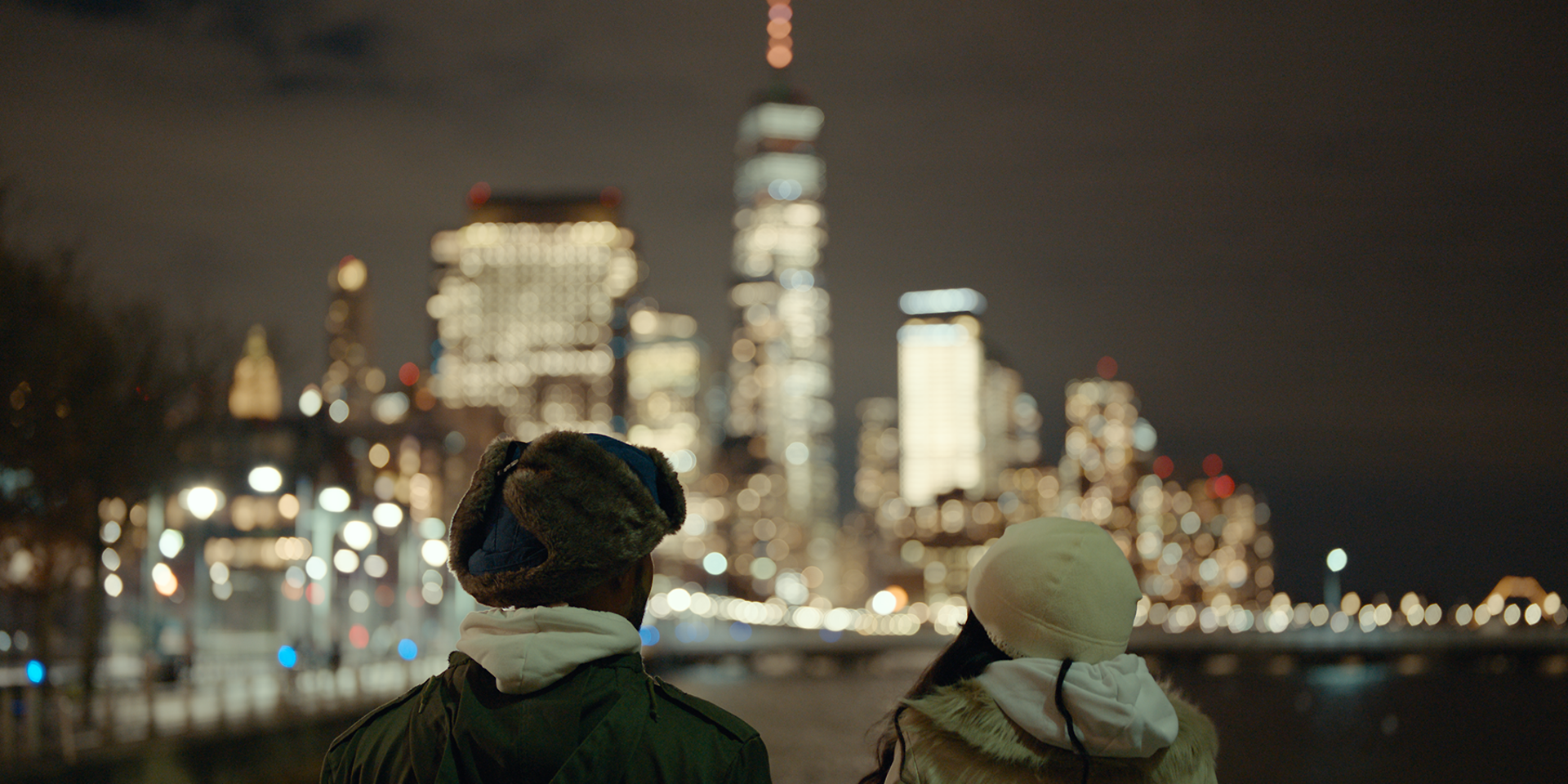

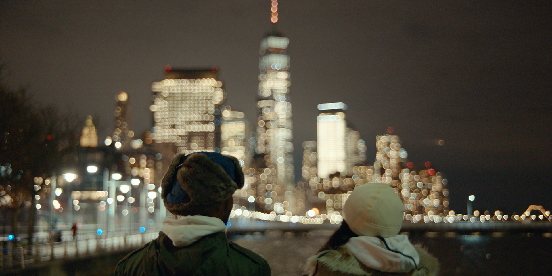

Positive filters
Drag the slider to compare a clean image with the strongest positive filter
ARRI Impression Filters example footage "The Impressionists" 2 people from behind NYC skyline in background With 330P filter
ARRI Impression Filters example footage "The Impressionists" 2 people from behind NYC skyline in background Without filter
Image without a filter on the LEFT and with Impression V Filter IV 330P on the RIGHT. Captured with an ALEXA Mini LF and 47 mm Signature Prime at T1.8.
Positive strength Impression V Filters produce 'bauble' bokeh in the background, where out-of-focus highlights are bright in the middle and blurry at the edges. Bokeh at the edges of the image becomes more stretched and pointier.
Positive filters

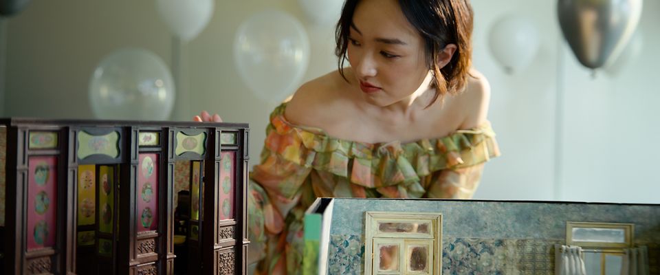

ARRI Impression Filters example footage "The Impressionists" HongKong woman looking at dollhouse parts

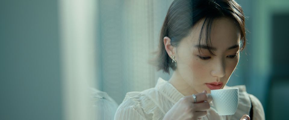

ARRI Impression Filters example footage "The Impressionists" HongKong woman drinking tea close up

Compatibility of Impression Filters

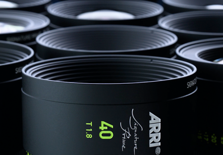

When using Impression V Filters with Signature Primes and Signature Zooms, some basic parameters of the lens system will change. Similar to using a weak extender, the focal length and aperture of the lens will be slightly altered. The factors by which parameters such as focal length have to be multiplied in order to obtain effective values are given in the table below. The table also shows the impact of the aperture change on the T-stop.

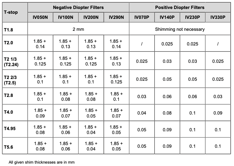

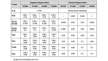

Shimming depending on T-stop
In case you only use the positive Impression V Filters at a T-stop of T1.8, no shimming is required. You can easily exchange between the different positive filter types with lens scales remaining accurate. In case you want to use the negative Impression V Filters at a T-stop of T1.8, you only have to shim once with the included 2 mm shim. After shimming you can also easily exchange between the different negative filter types.
When working in a stopped down configuration, the required shimming depends on which filter type and T-stop shall be used for the upcoming shoot. Please see the following table for detailed information on required shim thicknesses. In case of the negative filters, please note that for each T-stop / filter combination 2 values are listed. The first value refers to the LPL mount shim 1.85 mm which is provided in the Impression V Shim Set. The second value refers to the required thickness of individual shims.
  • IV stands for Impression V. The number 330 refers to the strength of the filter (in this case: 330 = 3.30 diopters). The letter behind the number tells you if it is a positive diopter filter (P) or a negative diopter filter (N).
  • ARRI is offering an Impression V Filter Kit that contains all eight filter types, 4 positive and 4 negative filters. All necessary shims and a torque screwdriver, as well as an inscribable Velcro set to label filtered lenses on set, are included in the kit.
    Each filter type can be ordered individually as an ARRI Impression V Filter Pack. Each of these packs contains 3 filters of the same type.
    As negative filters need to be shimmed with one additional shim when shooting at open aperture (T1.8), packs containing a negative filter type will also include a set of shims. In addition, both the negative and the positive filter packs also include sets of inscribable Velcro tabs.
    It is also possible to buy separate Impression V Shim Packs and Impression V Velcro Packs. Please see the product configuration overview in the download section for more information.
