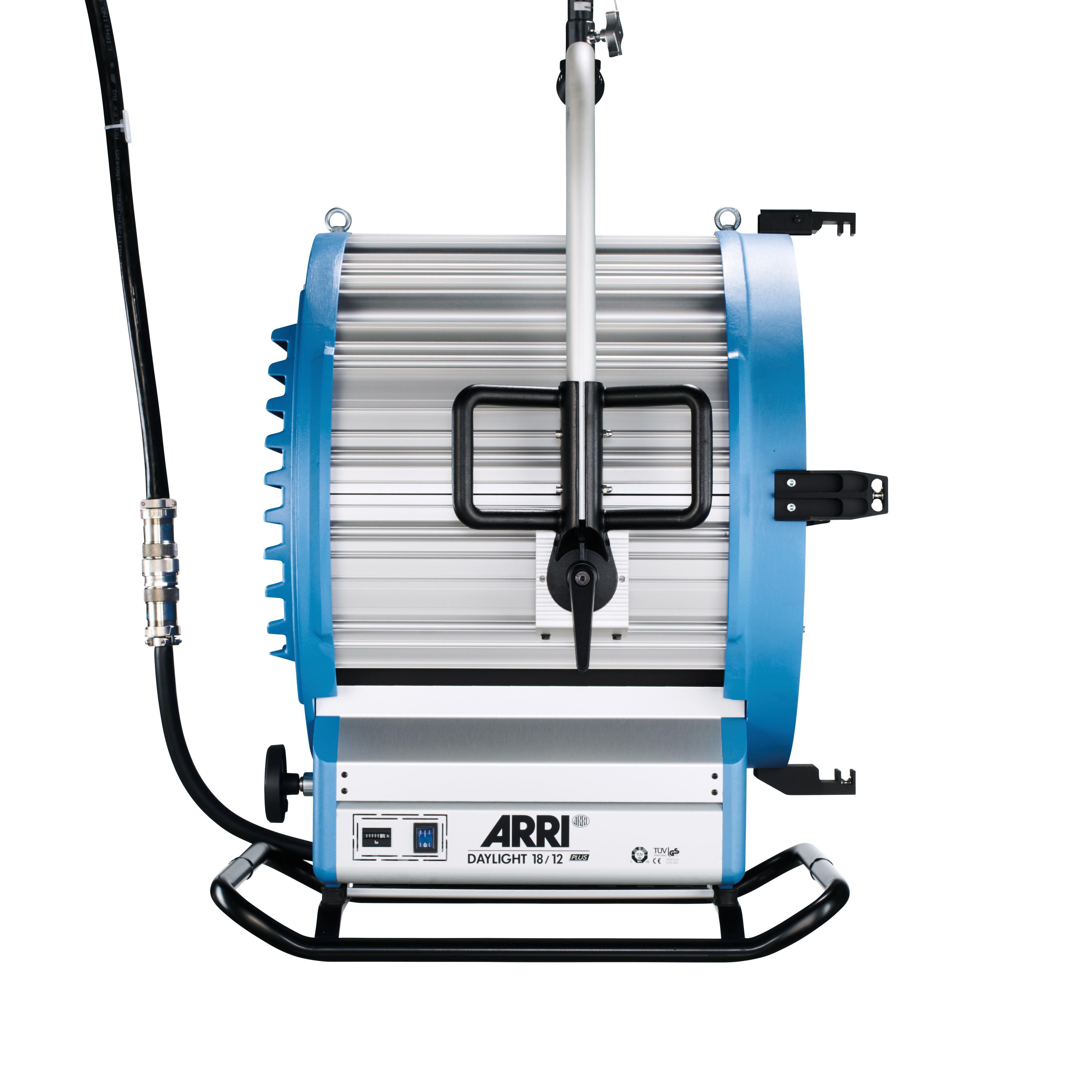

L1.71160.B Daylight 18_12-1
Ideal for all types of location lighting
Where a lightweight Fresnel spotlight using daylight characteristics with compact size and high efficiency is needed, ARRI Daylight Fresnels are the preferred choice. ARRI's elegant modular construction, using corrosion-resistant aluminium extrusions and lightweight die castings, offers great structural strength and weather resistance. Together with ARRI Electronic High Speed Ballasts, this rugged HMI Fresnel is ideal for all types of location lighting.
Features
  • Large, high efficiency wide-angle lenses
  • Corrosion-resistant aluminium construction
  • Extremely even light distribution
  • Focus knob on front and rear
  • Easy service access
