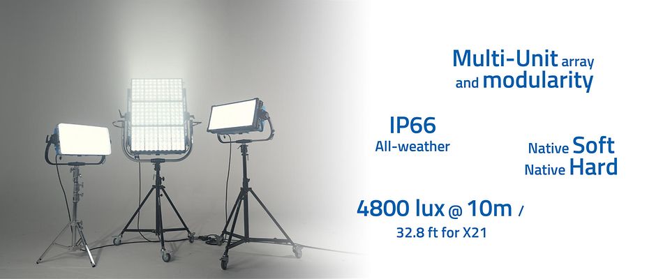

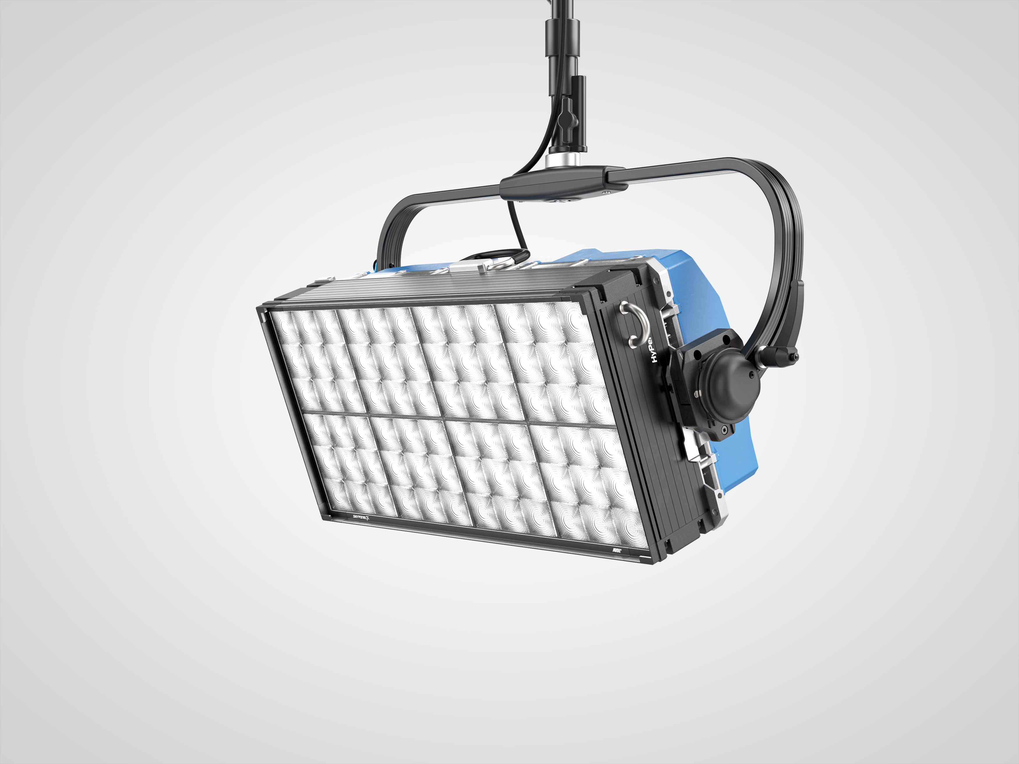

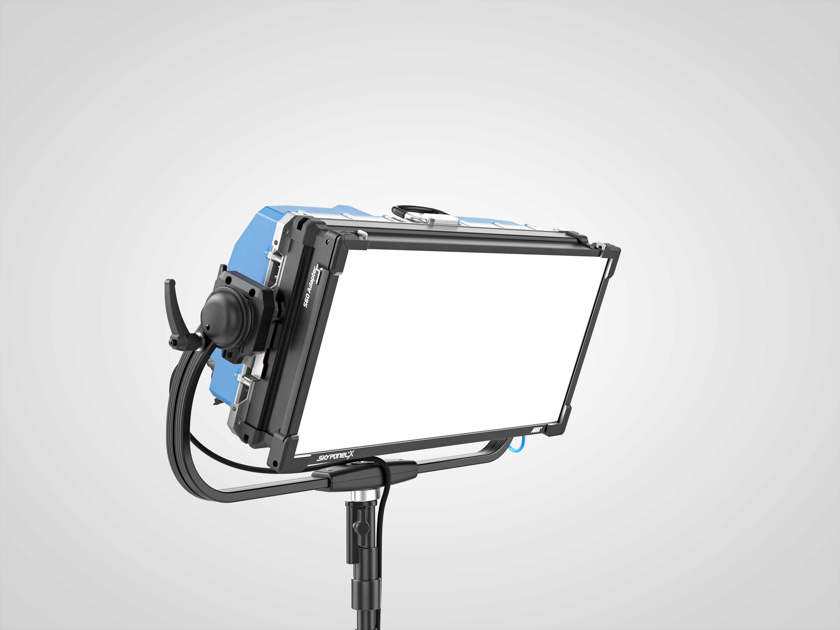

Introduced as a modular system and configurable into different sizes (X21, X22, X23), SkyPanel X offers native soft and hard light technology, setting a new bar not only in terms of dimming and color science, but also in light output and beam quality for medium to long throws. With up to 4,800 lux at 10 m / 32.8 ft and eight pixels per panel; dynamic CCT range of 1,500 K - 20,000 K; RGBACL full-spectrum color engine; wireless CRMX control; integrated power supply; advanced networking possibilities; and an IP66 rating, the SkyPanel X is an all-weather lighting solution tailored to existing workflows. It is available in two housing colors: iconic blue/silver and all-black.

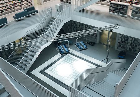

The SkyPanel X is your all-weather lighting solution. Engineered and IP66 certified for resilience against rain, storms, and cold water pressure washers, these lights embody innovation, reliability, and durability.

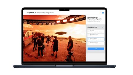

SkyPanel X - Recommended Configurations
Would you like to use a SkyPanel X for your next production, but don't know which configuration and accessories are right for it? Then use our Configurator. Based on your pre-selection, we will give you a recommendation that suits your application. At the end, you can simply save this configuration as a PDF or share it with your colleagues.
Try it out

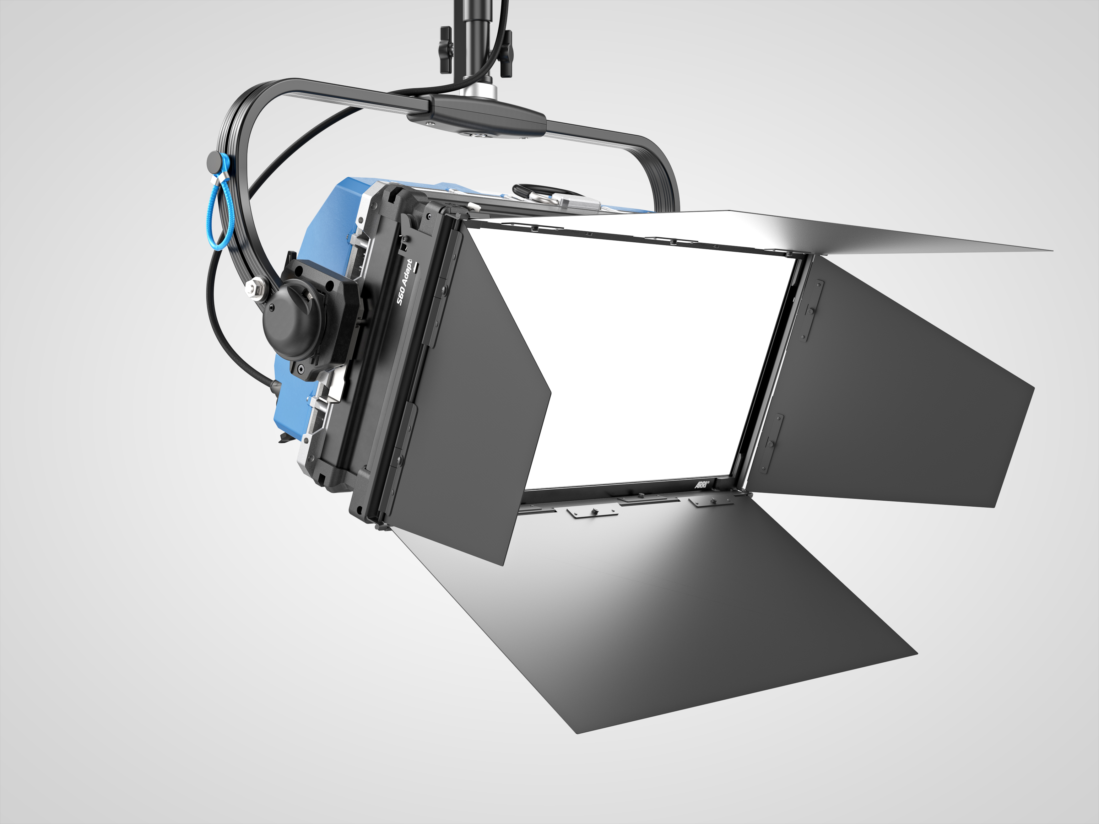

  • High lumen output
  • Flicker-free low end dimming from 100% - 0% for close-ups

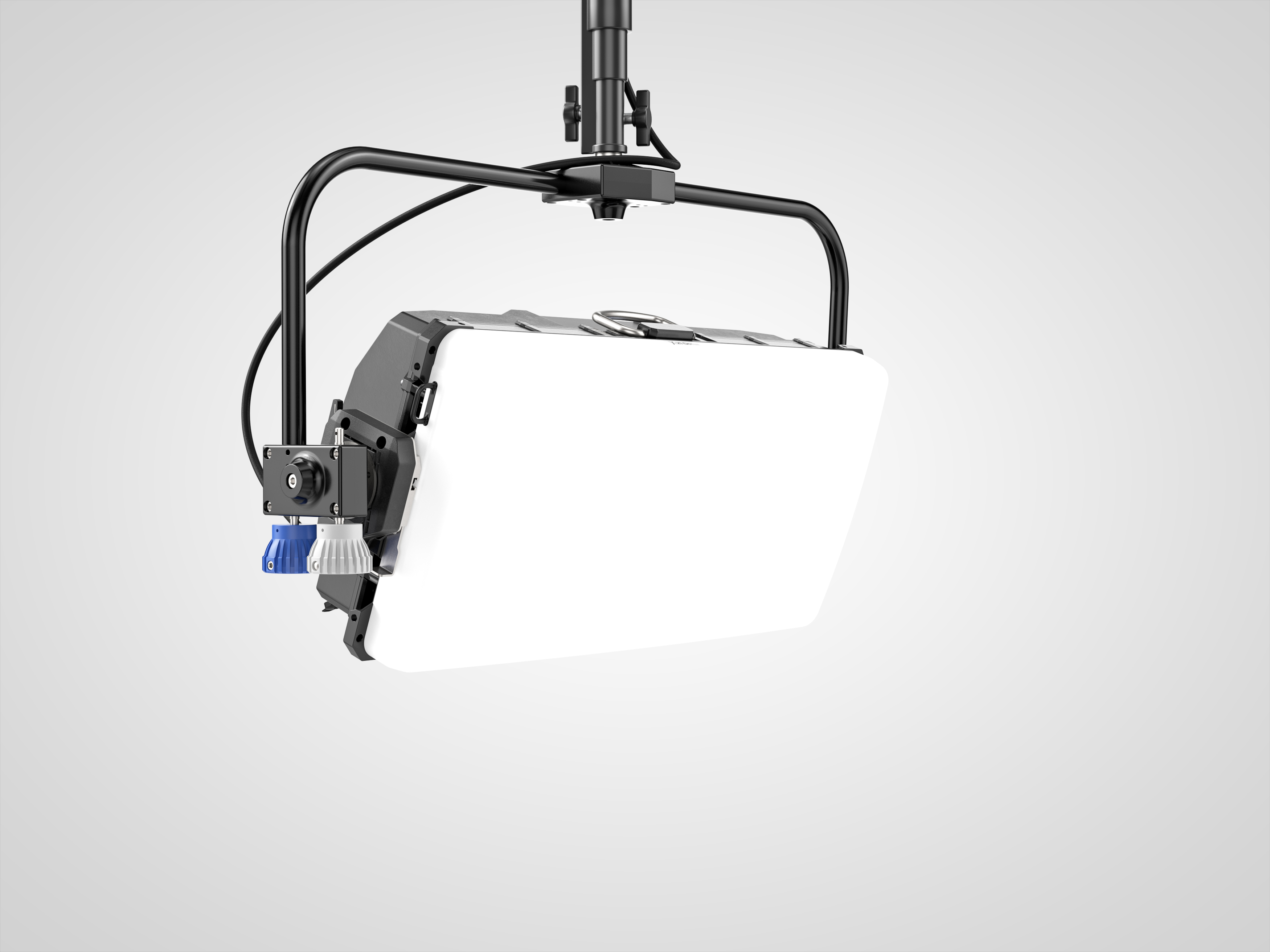

  • S60 Adapter for Classic SkyPanel accessories, plus the new X21 Dome
  • 8 pixels for mapping and effects
  • Efficient and simplified workflow for quick and easy set up

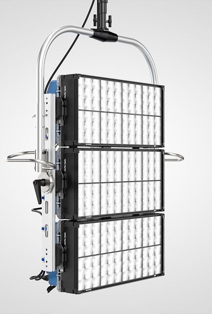

  • Optimal rounded beam with maximum punch and quality
  • Create a long throw fixture with the powerful HyPer Optic
  • Higher output than a 2.5 kW open-face HMI lamp when used as X23
  • Unique, bold color pixel look
  • Ideal on a cherry picker, through windows, or bounced

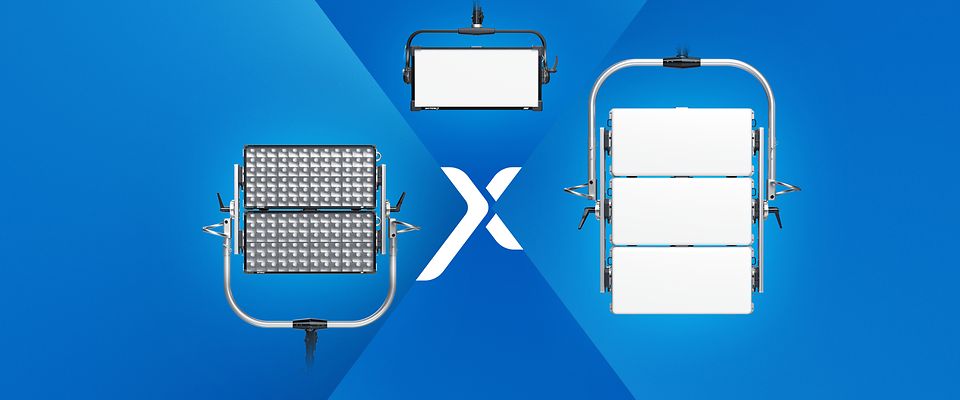

Modular experience

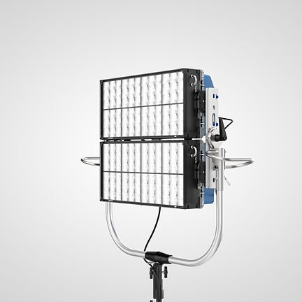

  • Upgrade your lighting easily with modular SkyPanel X units
  • Fast and easy setup with just one single power cable
  • Benefit from tool-less frames with quick-lock system
  • Seamless control with just one DMX profile or ALL-WEATHER Control Panel
