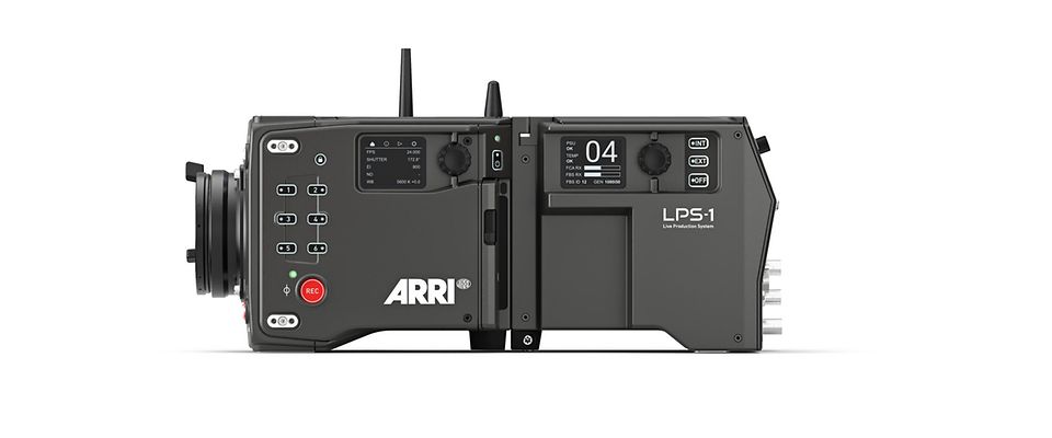

Comprising ARRI's Fiber Camera Adapter and Fiber Base Station.
ALEXA 35 Live Body + FCA LPS-1 -0007-3
A powerful hub
Providing familiar controls for operators and all standard broadcast interfaces, the Live Production System LPS-1 consists of the Fiber Camera Adapter and the Fiber Base Station. They can be connected either with a hybrid fiber cable that delivers both power and uncompressed 4K video over distances up to 2 km, or with a tactical fiber cable up to 10 km in length. An extra fiber tunnel and Ethernet tunnel increase the system's flexibility with additional video, audio, or control signals.

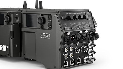

LPS-1 Fiber Camera Adapter controls
CALL   Signals camera operator wants to talk
PROD  Volume of production intercom
ENG   Volume of engineering intercom
PGM   Volume of program audio on intercom
TRACKER    Volume of tracker intercom
PRD    Enables intercom production channel microphone
ENG    Enables intercom engineering channel microphone
REL    Push release button to make a change with A OUT button
A OUT    Switches between AES or analog line level for A OUT when REL is pushed
REL    Push release button to make a change with A1 IN button
A1 IN    Switches between MIC 48V/MIC/LINE/AES for A1 IN when REL is pushed
REL    Unlocks (releases) the A2 IN button
A2 IN    Switches between MIC 48V/MIC/LINE/AES for A2 IN once unlocked
SEL    Selects one of the four return in channels for allocation to RET2 button
RT2    Switches from PGM video to the selected return in channel
SEL    Selects one of the four return in channels for allocation to RET1 button
RT1    Switches from PGM video to the selected return in channel

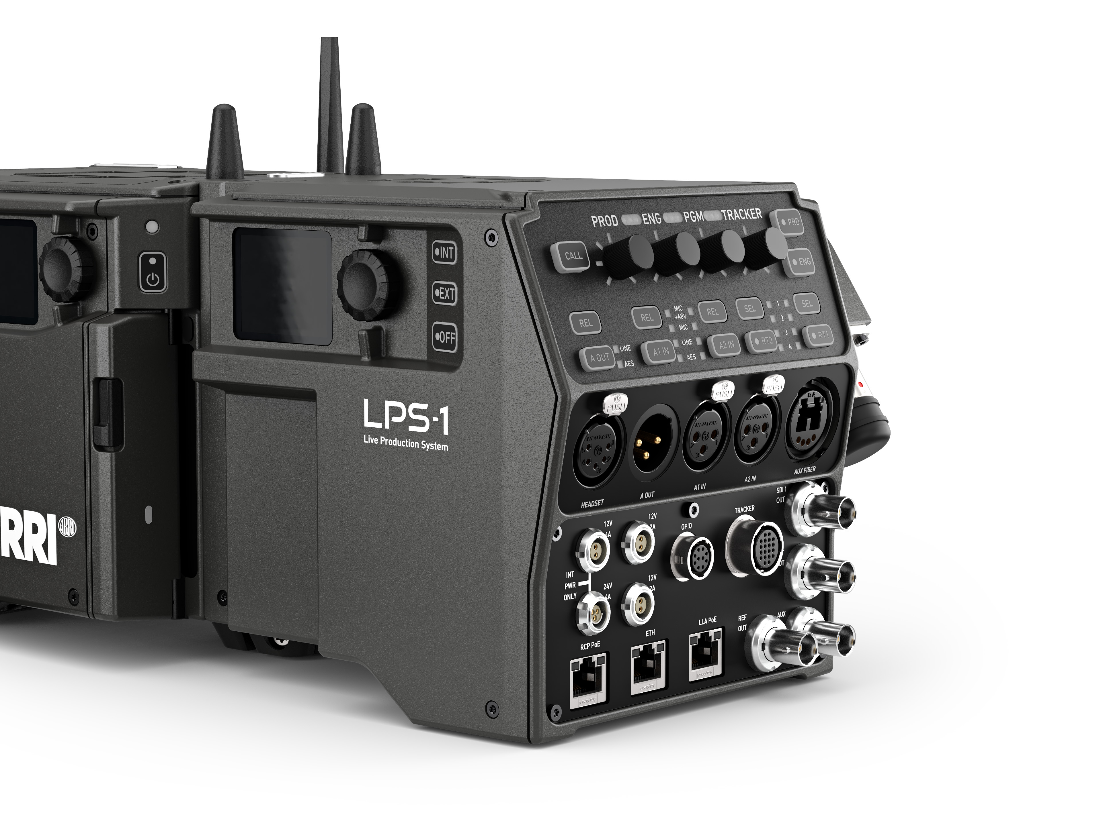

The range of connectors adorning the rear of the LPS-1 Fiber Camera Adapter will be instantly recognizable to camera operators.
LPS-1 Fiber Camera Adapter interfaces
HEADSET    XLR 5-pin socket for intercom headset
A OUT    XLR 3-pin plug for AES or analog line audio out
A1 IN    XLR 3-pin socket for audio input 1 (MIC 48V/MIC/LINE/AES)
A2 IN    XLR 3-pin socket for audio input 2 (MIC 48V/MIC/LINE/AES)
FIBER    Lemo 3K SMPTE 311M fiber connector (socket)
AUX FIBER    Neutrik Opticon connector for auxiliary fiber tunnel
12V/4A    Lemo EGG socket for 12V accessory power output*
12V/2A    Lemo EGG socket for 12V accessory power output
24V/4A    ARRI RS Lemo socket for 24V accessory power output*
GPIO    Hirose 10-pin HR10A connector
TRACKER    Hirose 20-pin HR10A connector
SDI1 OUT    BNC Monitor out (= ALEXA 35 SDI 1 out)
RET OUT    BNC Monitor output of return video in from Fiber Base Station
RCP PoE    RJ45 Ethernet for direct RCP connection
ETH    RJ45 for auxiliary 1 Gbit/s Ethernet tunnel
LLA PoE    RJ45 Ethernet for Large Lens Adapter interface module for future use
REF OUT    BNC Genlock out
AUX    BNC Auxiliary/Teleprompter SDI out
*Only available when system is powered by SMPTE 311 fiber (INT)

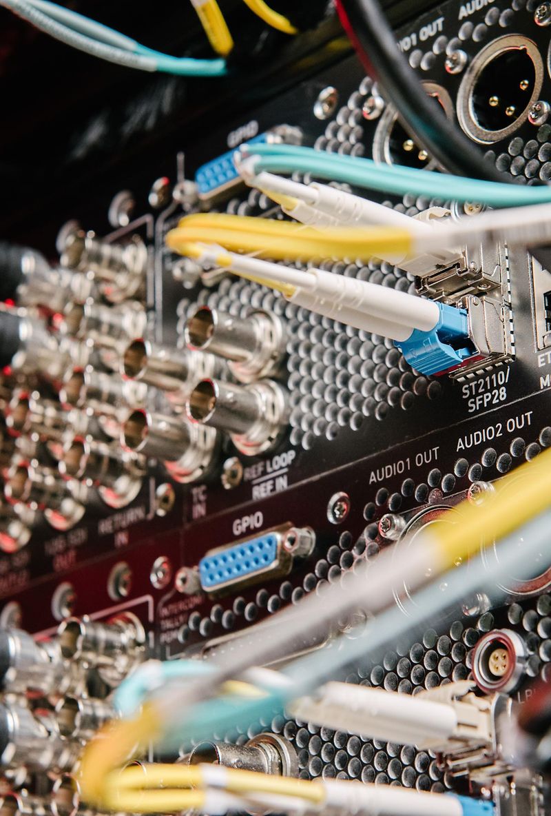

LPS-1 Fiber Base Station interfaces
Connectors & Controls (front)
RCP/MGM PoE    RJ45 for RCP connection (PoE) or web interface
TALLY    Red, green and yellow tally indicator
Connectors (back)
PSU 1    IEC 320 Universal AC mains power input (100 – 240V, 50/60Hz)
PSU 2    IEC 320 Universal AC mains power input (100 – 240V, 50/60Hz)
CAMERA    Lemo 3K SMPTE 311M fiber connector (plug)
AUX TP IN    BNC input auxiliary/teleprompter (SDI up to 12G)
MON    BNC output with status overlay (SDI up to 3G)
HD OUT 1/2    2x BNC outputs for down converted HD signal (SDI up to 3G), progressive or interlaced
3G-SDI OUT (1) 1-4    4x BNC outputs for 4x single link 3G or 1x quad link 12G
3G-SDI OUT (2) 1-4    4x BNC outputs for 4x single link 3G or 1x quad link 12G
12G-SDI  4x BNC outputs for up to 4x single link 12G or 2x dual link 6G
RETURN IN 1-4  4x BNC inputs for return video (up to 3G)
GPIO  D-sub 15-pin for general purpose I/O
INTERCOM/TALLY/PGM  D-sub 25-pin for Intercom audio in/out, PGM audio in and Tally control (SONY style connector and pin-assignments)
REF OUT  1x BNC output for active genlock (black burst or tri-level sync) derived from PTP or analog REF IN
TC IN  1x BNC input for linear timecode
REF LOOP  1x BNC loop output of genlock input signal (black burst or tri-level sync)
REF IN  1x BNC input for genlock signal (black burst or tri-level sync)
AUDIO1 OUT  XLR 3-pin plug (line level or AES) for balanced analog or digital audio
AUDIO2 OUT  XLR 3-pin plug (line level or AES) for balanced analog or digital audio
AUDIO1 IN  XLR 3-pin socket (line level or AES) for balanced analog or digital audio
AUDIO2 IN  XLR 3-pin socket (line level or AES) for balanced analog or digital audio
LBUS  ARRI LBUS connector for future use
ST2110/SFP28  SFP28 transceiver modules with LC fiber connector (up to 25G)   for SMPTE 2110, primary or redundant
ETH TUNNEL  RJ45 for auxiliary 1 Gbit/s Ethernet tunnel
MGM PORT 2  RJ45 for multicam web interface
RCP PoE  RJ45 for remote control panels (with power)
MGM PORT 1  RJ45 for multicam web interface
