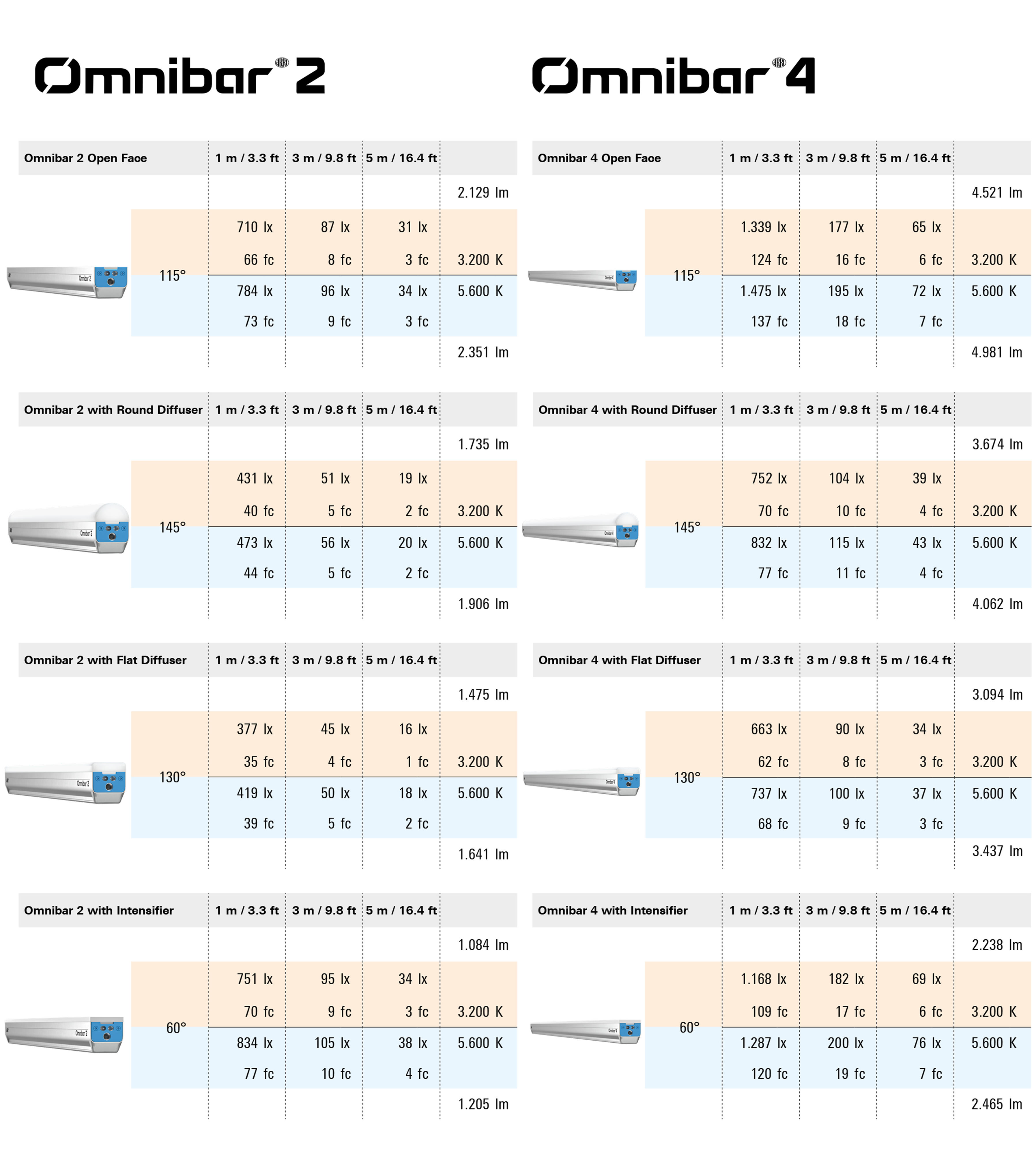

Find all essential technical and photometric data for Omnibar, including size, weight, and output. Easily access Omnibar technical data sheets, manuals, and more documents in multiple languages via the downloads section.
