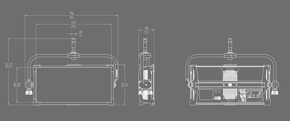

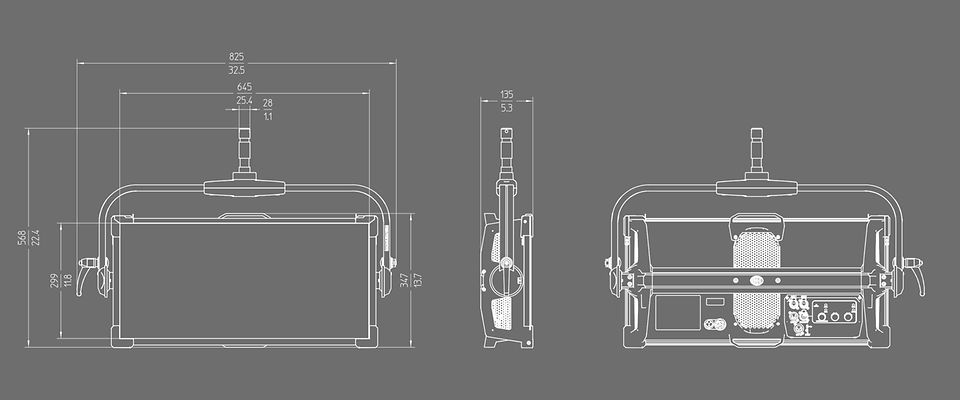

Mechanical
Versions
Manual
Pole Operated
Handling
Aluminum Yoke with High-Strength Tilt Lock
Steel Yoke for Pole Operation (Pan, Tilt)
Rail for Fixed and Center Mount Yokes
Mounting28 mm spigot (Junior Pin)
Housing ColorsBlue/Silver, Black
Tilt Angle+/- 90°
Weight - Fixture Only
Weight - with Manual Yoke
Weight - with P.O. Yoke
11,6 kg / 25.5 lbs (internal PSU)
approx. 14 kg / 30.5 lbs (Internal PSU)
approx. 15 kg / 33.4 lbs (Internal PSU)

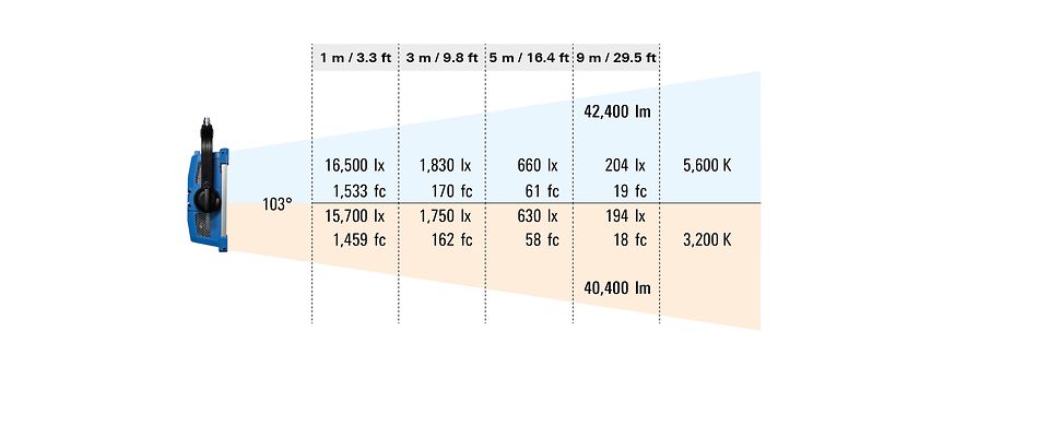

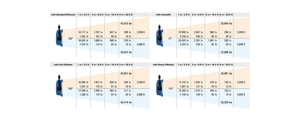

Photometrical Data
 @ 5 m / 16.4 ft
with Standard Diffusion (103°)
3.200 K: 647 lux / 60 fc
5.600 K: 680 lux / 63 fc
with Intensifier (71°)
3.200 K: 960 lux / 89fc
5.600 K: 1.001 lux / 93 fc
with Lite Diffusion (105°)
3.200 K: 659 lux / 61 fc
5.600 K: 684 lux / 64 fc
with Heavy Diffusion (114°)
3.200 K: 470 lux / 44 fc
5.600 K: 494 lux / 46 fc
