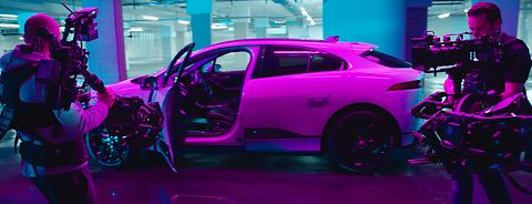

ARRI ARTEMIS 2 and TRINITY 2 in Action, filming a car commercial.

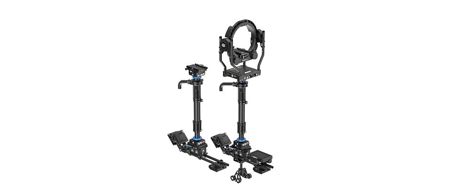

TRINITY 2 & ARTEMIS 2
One modular system, two stabilizers
ARRI ARTEMIS 2 and TRINITY 2 placed next to one another.
Designed by operators, for operators
ARRI introduces its second-generation camera stabilizers. The new modular system brings enhancements to camera movement, connectivity, power management, user interface, and balance options. A quick and easy upgrade transforms the purely mechanical ARTEMIS 2 into the hybrid TRINITY 2, which adds electronic stabilization for an even wider range of movements and angles.

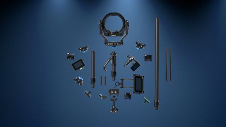

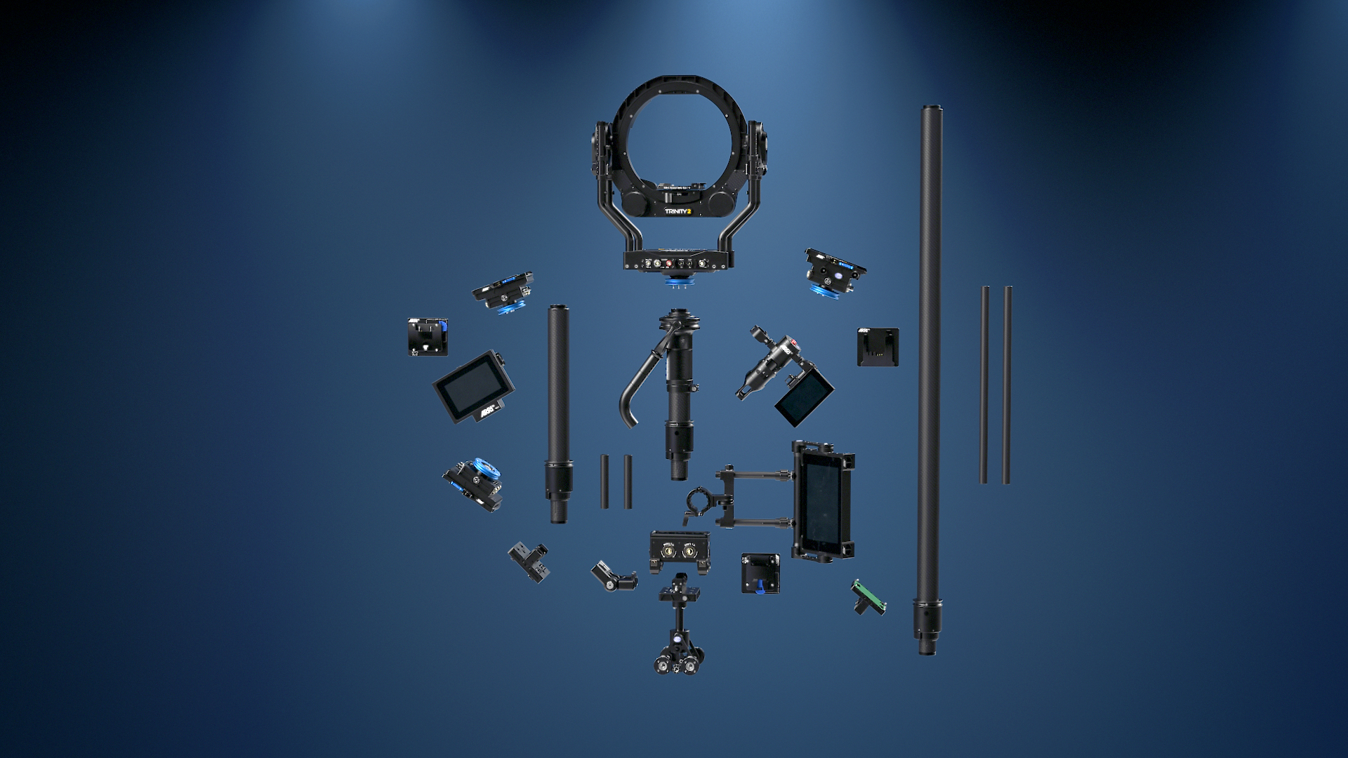

A single, shared system
  • Modularity is at the heart of the second-generation system
  • Both stabilizers share 80% of all new components
  • Easy transitions between ARTEMIS 2 and TRINITY 2
  • Quickly build whatever rig meets your on-set requirements

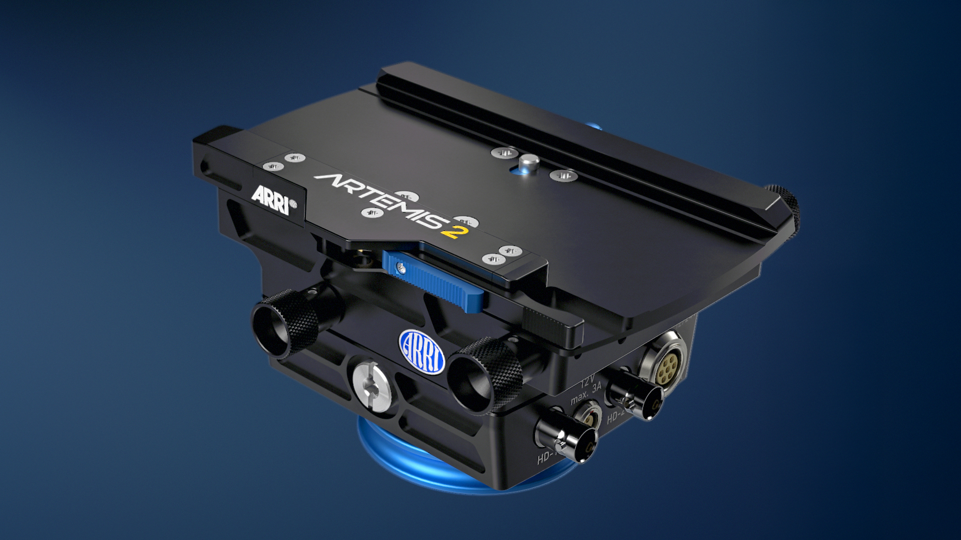

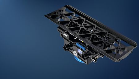

  • Redesigned top stage with fast but secure clamp mechanism
  • 2x 12G video connections for future resolution standards
  • New 16-pin main socket for faster data transfer

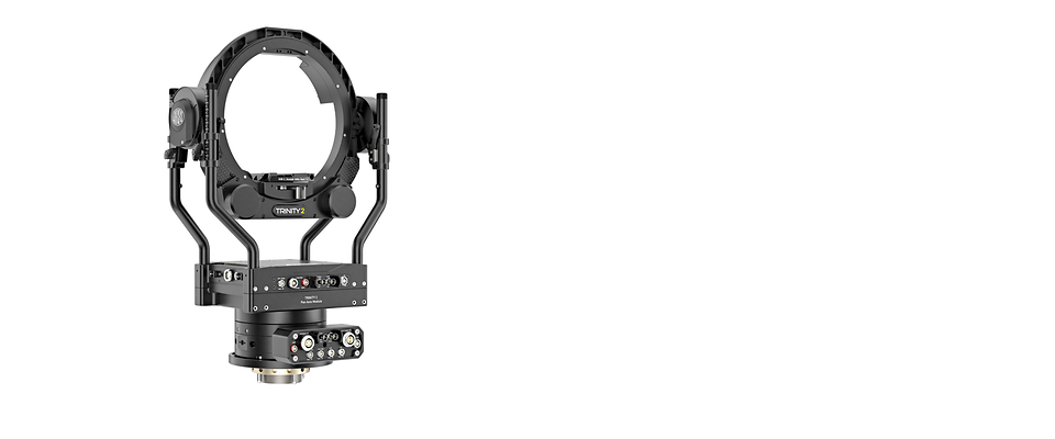

Improved gimbal
  • Special low-friction bearings, made in Germany
  • Rigid design and extremely precise manufacturing
  • Patented self-centering mechanism optimizes performance
  • Tool-free gimbal clamp allows quick positioning on center post

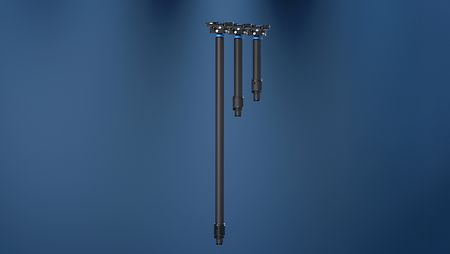

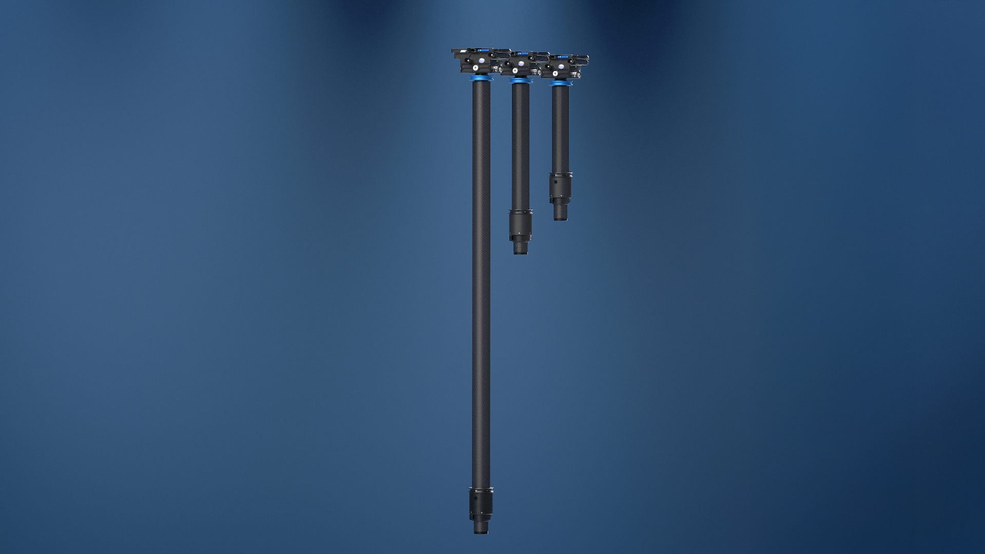

  • Two new post lengths now available
  • Super Post allows more extreme camera angles
  • Shorty Post suited to fast shots or space-constrained locations
  • Both new posts work with original TRINITY and ARTEMIS

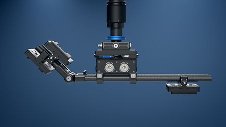

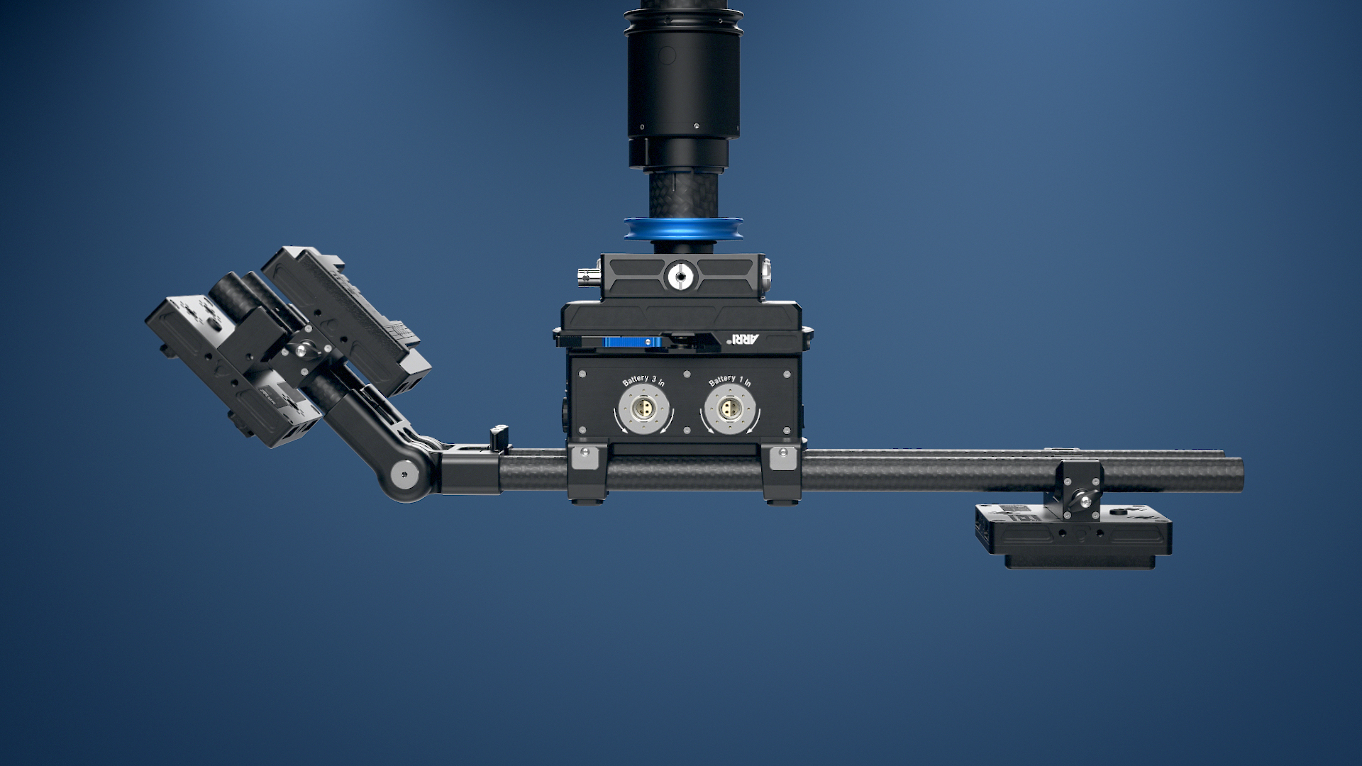

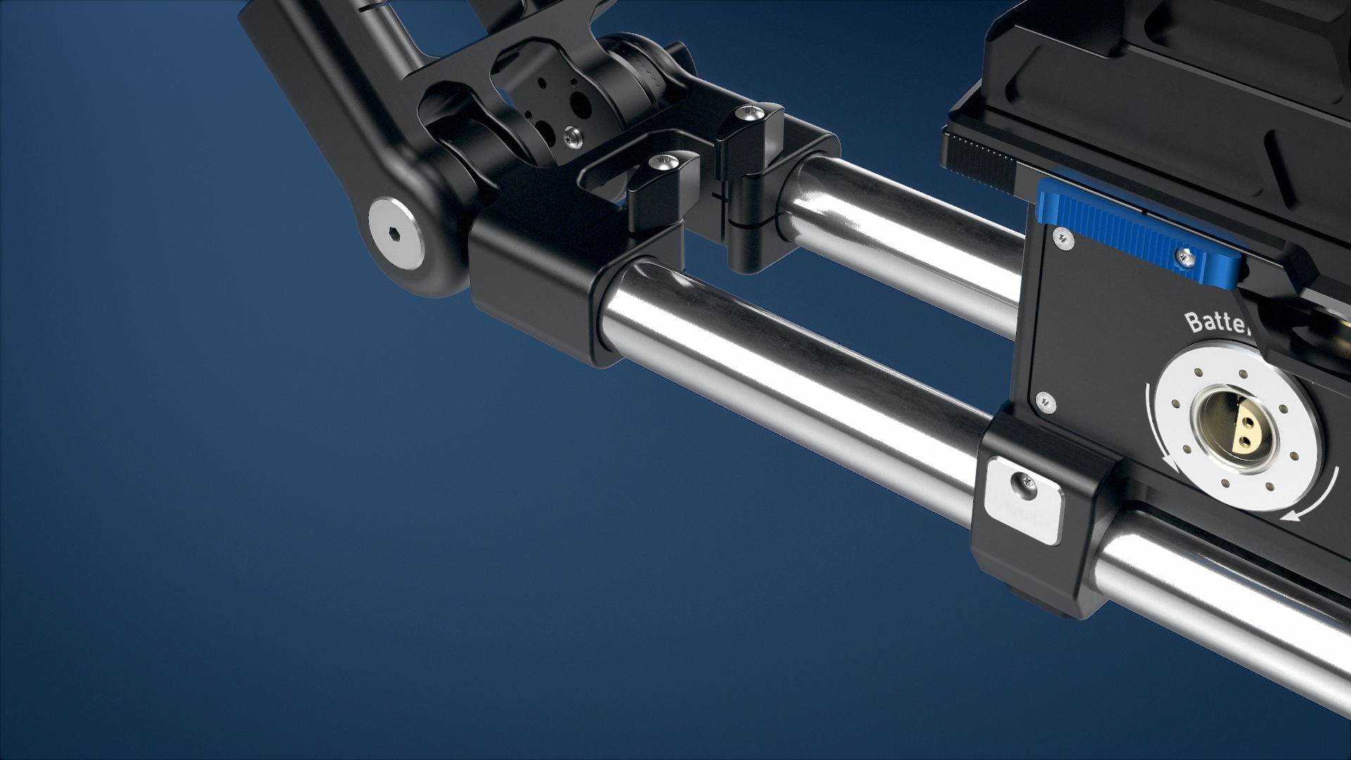

New sled design

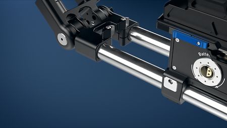

  • Rock-solid bottom stage and modular battery hanger

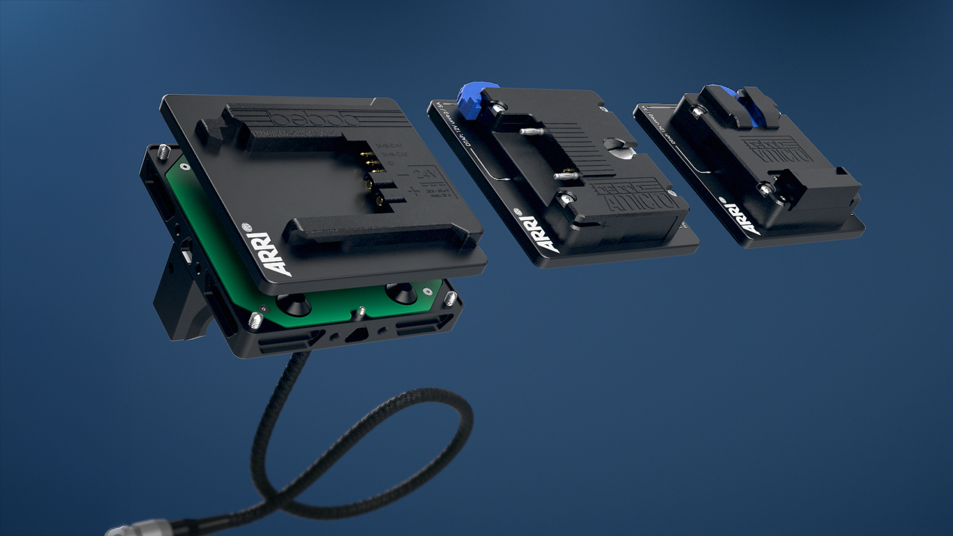

  • New battery mounts for B-Mount, Gold Mount, and V-Mount
  • 19 mm rods provide further stability
  • Carbon, aluminum, or steel rods for counterweight flexibility

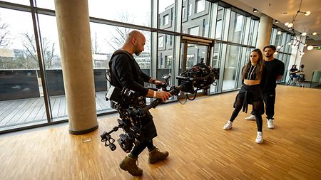

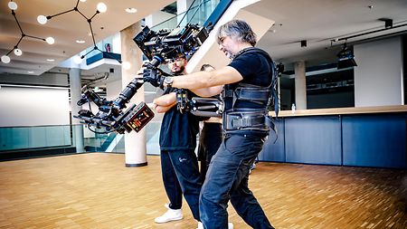

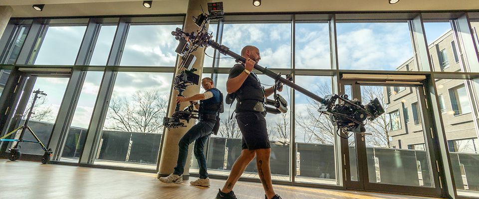

ARRI ARTEMIS 2 and TRINITY 2 in use as handheld steadicam and body-mounted camera stabilizer.
Modular and upgradeable
ARTEMIS 2 and TRINITY 2 are being held in the hand.

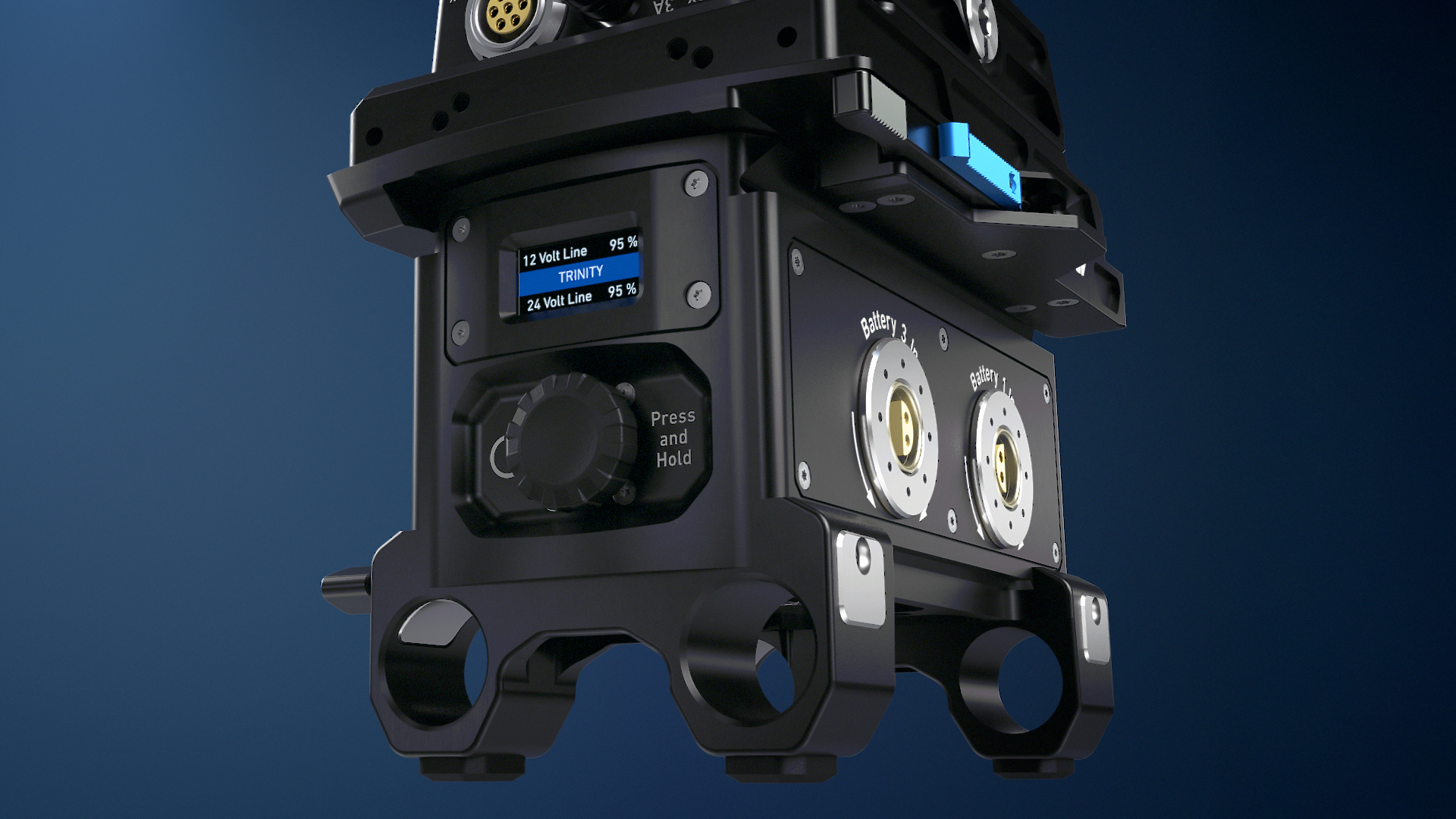

Versatile battery system
Reliable power supply
  • Intelligently regulated high-capacity power
  • Exact 12 V and 24 V power requirements calculated
  • Efficiency always remains at an industry-leading 95%
  • Settings visible on self-levelling display
Mix and match batteries
  • Up to three battery inputs
  • Use 12 V and/or 24 V batteries from any manufacturer
  • Source compatible batteries anywhere in the world
  • Freely combine B-Mount, Gold Mount, and V-Mount
Using batteries for balance
  • Position battery mounts anywhere on the 19 mm rods
  • Quick-release clamps make it fast to move battery mounts
  • Adjust the battery positions for counterweight balance
  • Rotating battery connectors help cable management

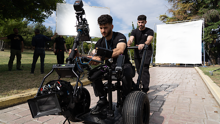

TRINITY 2 lets me offer directors different angles because I can easily change perspective from high mode to low mode, or show them a 360° roll. I've used the stabilizer in setups with a long broadcast zoom or a light mounted on the TRINITY head, and the motors were easily strong enough and very reliable. Operating TRINITY 2 from a Segway or rickshaw opens up further creative opportunities.
TRINITY operator Nikos Tzavaras
TRINITY 2 mounted on a rickshaw_Operator: Nikos Tzavaras

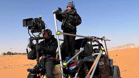

The upgrades of the TRINITY 2 really helped me on a week-long commercial shoot in Saudi Arabia, with tough locations and challenging demands from the director and DP. Little things like the clip-on system and rapid adjustments of tilt speed and roll – they all make putting the rig together less time consuming and the operating more efficient as well.
TRINITY and ARTEMIS operator Torben Meldgaard
TRINITY Operator Torben Meldgaard in the middle of the desert, holding ARRI stabilizer TRINITY 2 while sitting on a vehicle
Torben Meldgaard (left) and 1st AD Alyne Kabboul

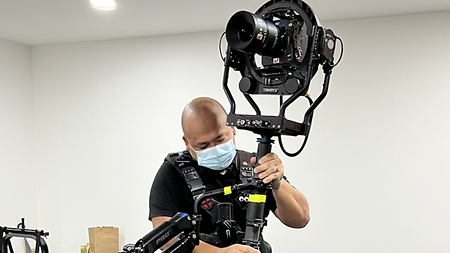

Having a TRINITY 2 in Singapore adds to the diversity of camera movement, offering more options to the demands of modern filmmaking. The expectation of camera movement evolves with trends, and the new TRINITY 2 is a tool that can fulfill my clients' vision.
TRINITY operator Christopher Ang
TRINITY operator Christopher Ang with his new TRINITY 2 at the ARRI Office
