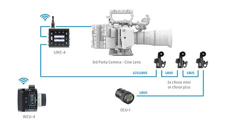

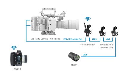

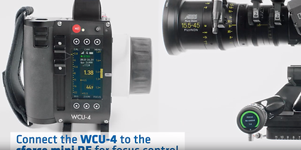

No, currently only the WUC-4 supports the override function.

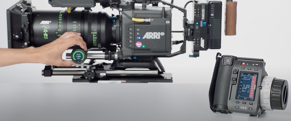

Yes, the OCU-1 works the same as the Master Grips.

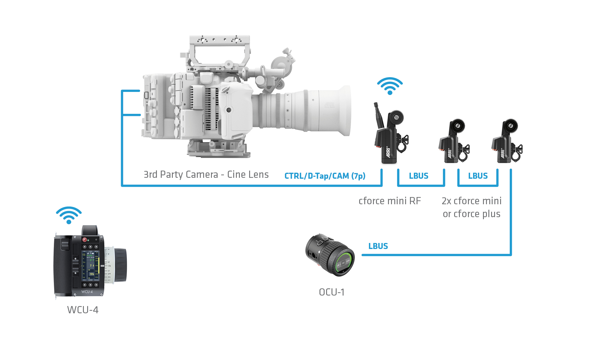

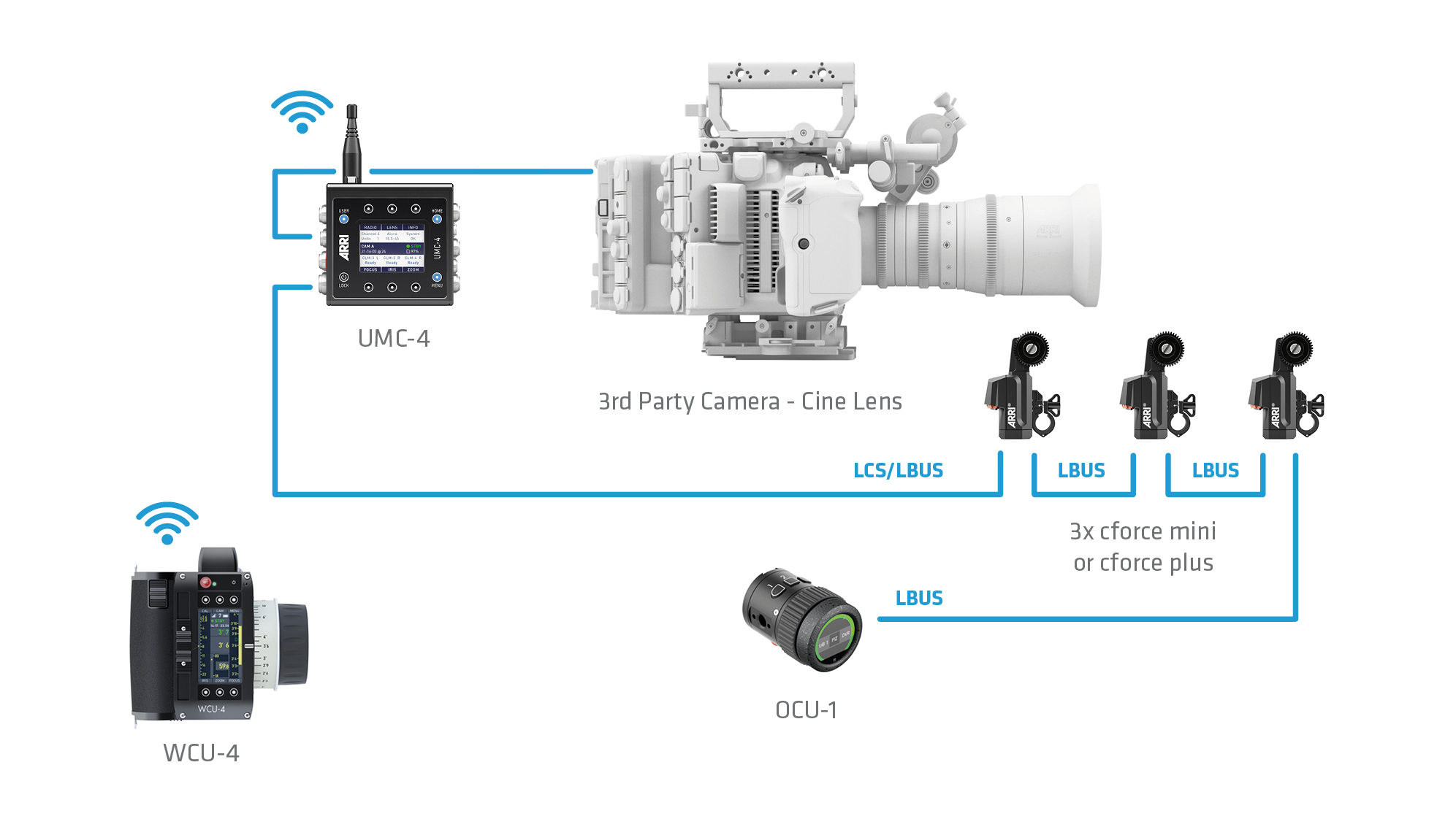

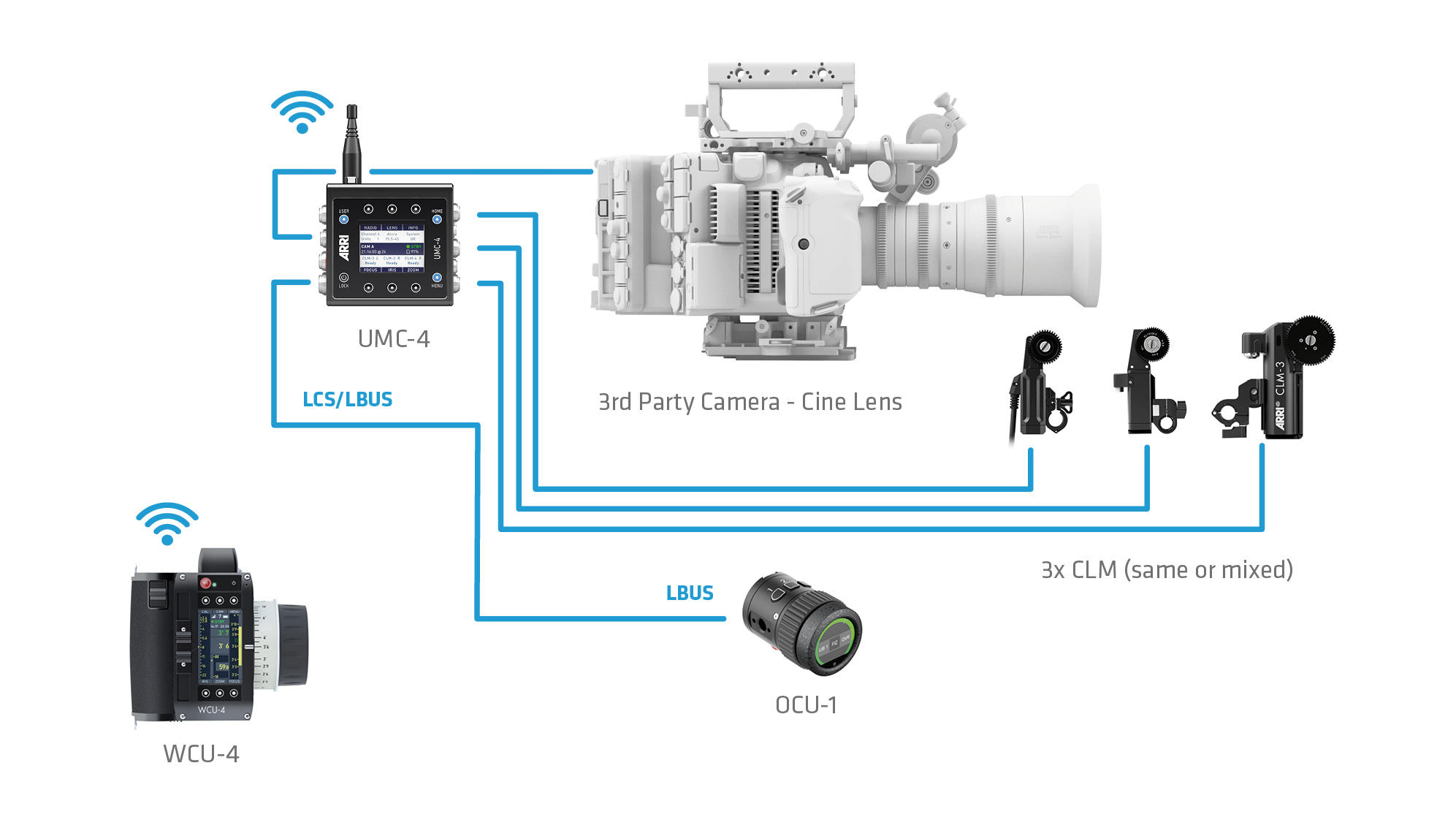

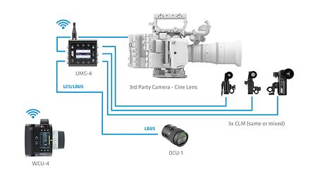

Yes, the OCU-1 can split lens axis control with the WCU-4.

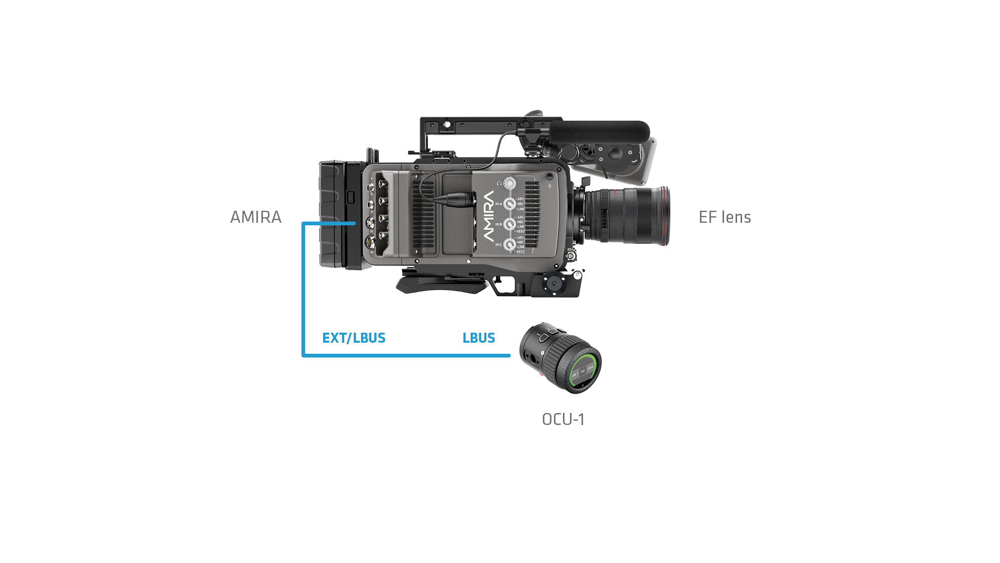

Yes, you need the LCUBE CUB-2 for it. With AMIRA it works like any other ENG lens.

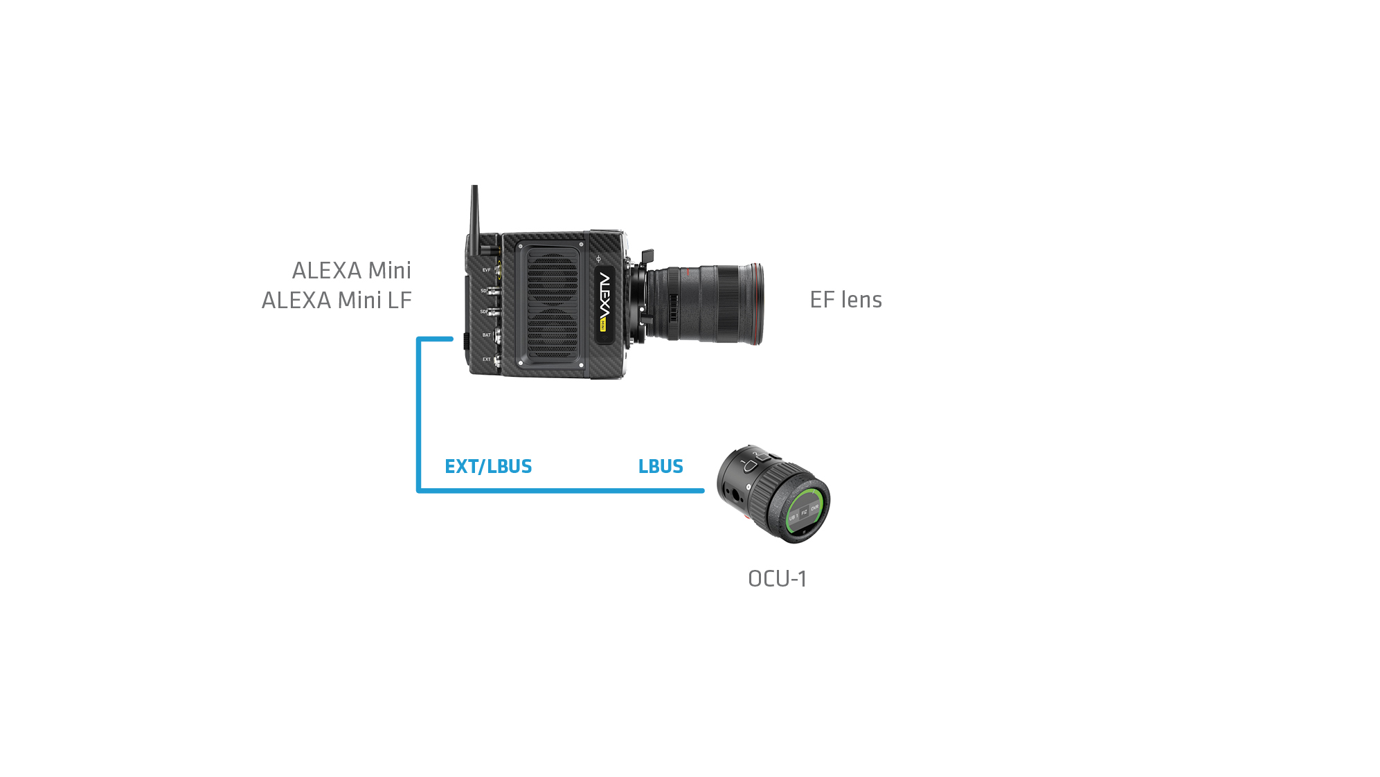

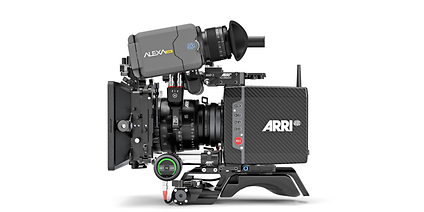

No, currently this override feature is only possible with the ALEXA Mini LF.

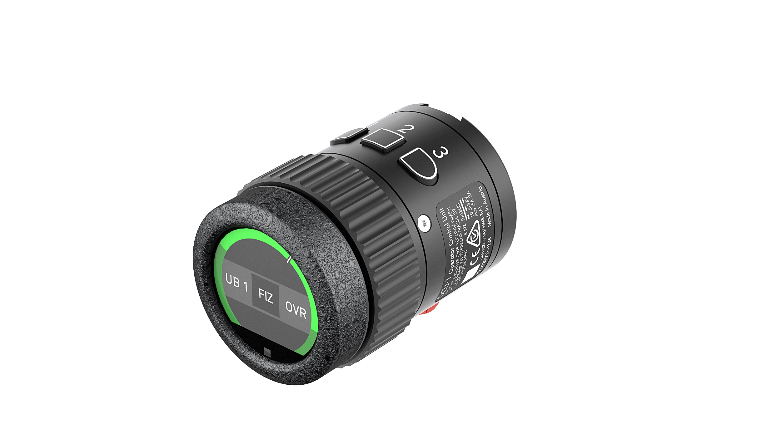

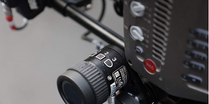

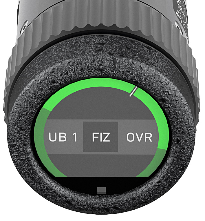

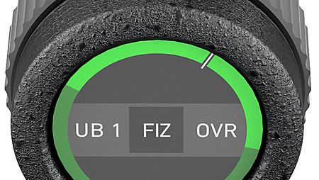

Yes, it is possible to assign camera user buttons to the OCU-1 and control up to 3 camera user buttons per OCU-1. The corresponding function of a user button can be set on the camera. Please check the designated camera user manual on how to set the user buttons.

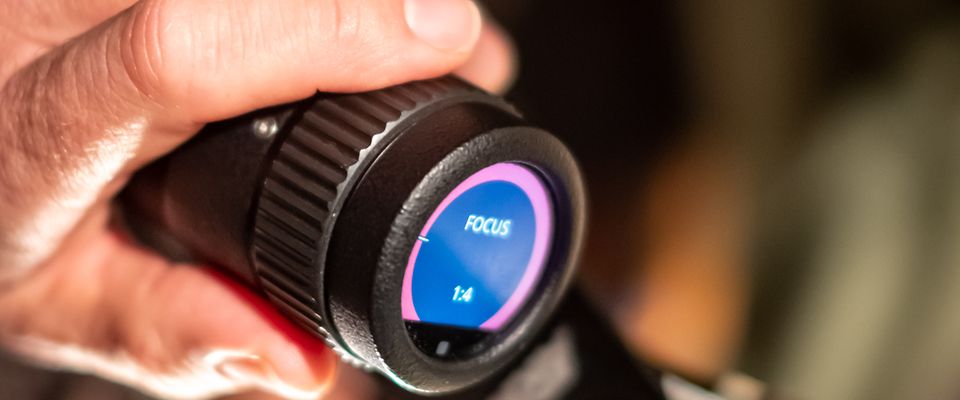

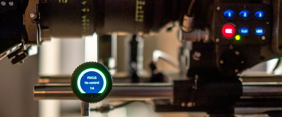

Yes, you can assign SPD+ (increase speed) and SPD- (decrease speed) to any of the OCU-1 user buttons and also set the motor speed from minimum to maximum within the motor screen. The speed is set as the ratio between lens range and wheel range (1:4, 1:2, 1:1, 2:1, 4:1).
No, the override function is only supported by the WCU-4.

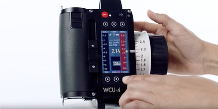

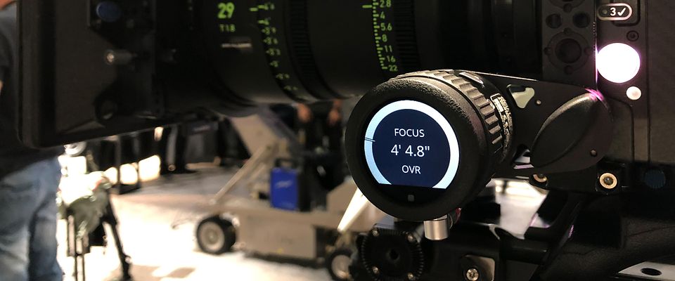

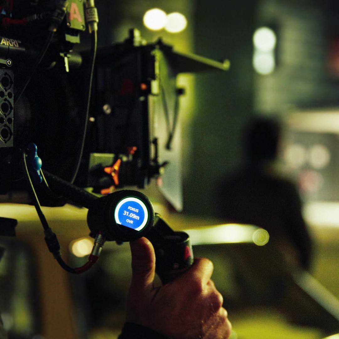

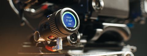

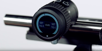

No, the WCU-4 indicates the override mode which is triggered by the OCU-1 and offers a re-engaged lens motor control method without a jump.
No. This function is not supported in the override mode only when the OCU-1 is used as a simple control unit which controls selected lens axis separately from the WCU-4.
Yes, you can use it on other cameras than ALEXA and AMIRA but with limited functions. For further details about extended compatibilities please check the designated OCU-1 user manual.

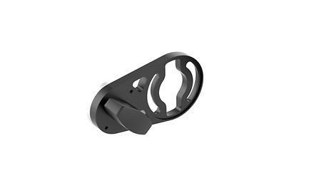

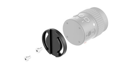

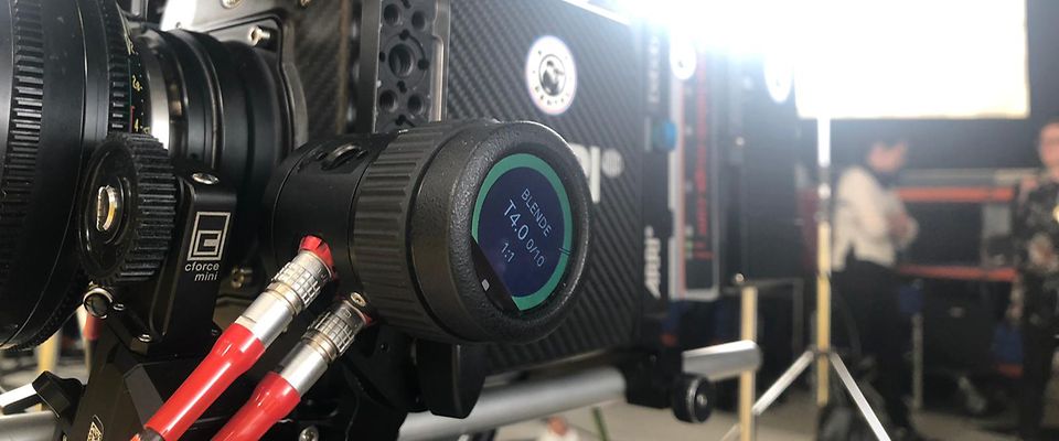

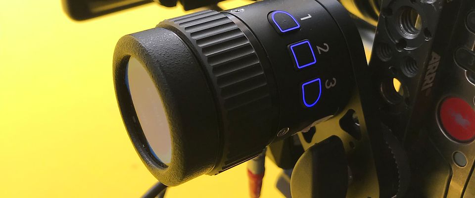

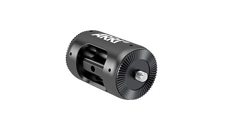

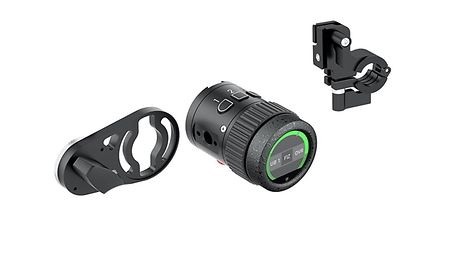

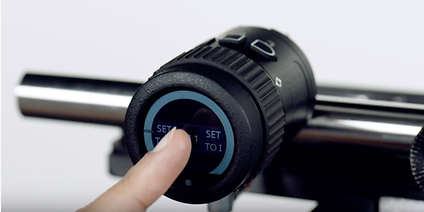

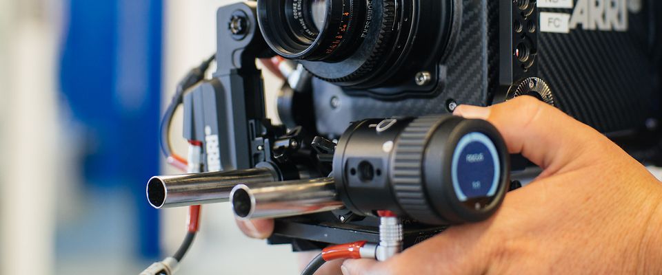

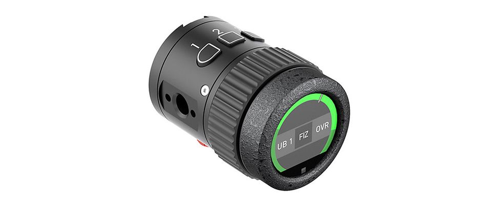

Small, solid and lightweight operator control unit with the ability to over-take and return control of lens axis of the WCU-4. It offers three assignable user buttons and flexible mounting options: 3/8-16 mounting point, dovetail mounting interface for CLM-5/cforce mini Clamp Console 19/15mm and optional ARRI rosette bracket.
