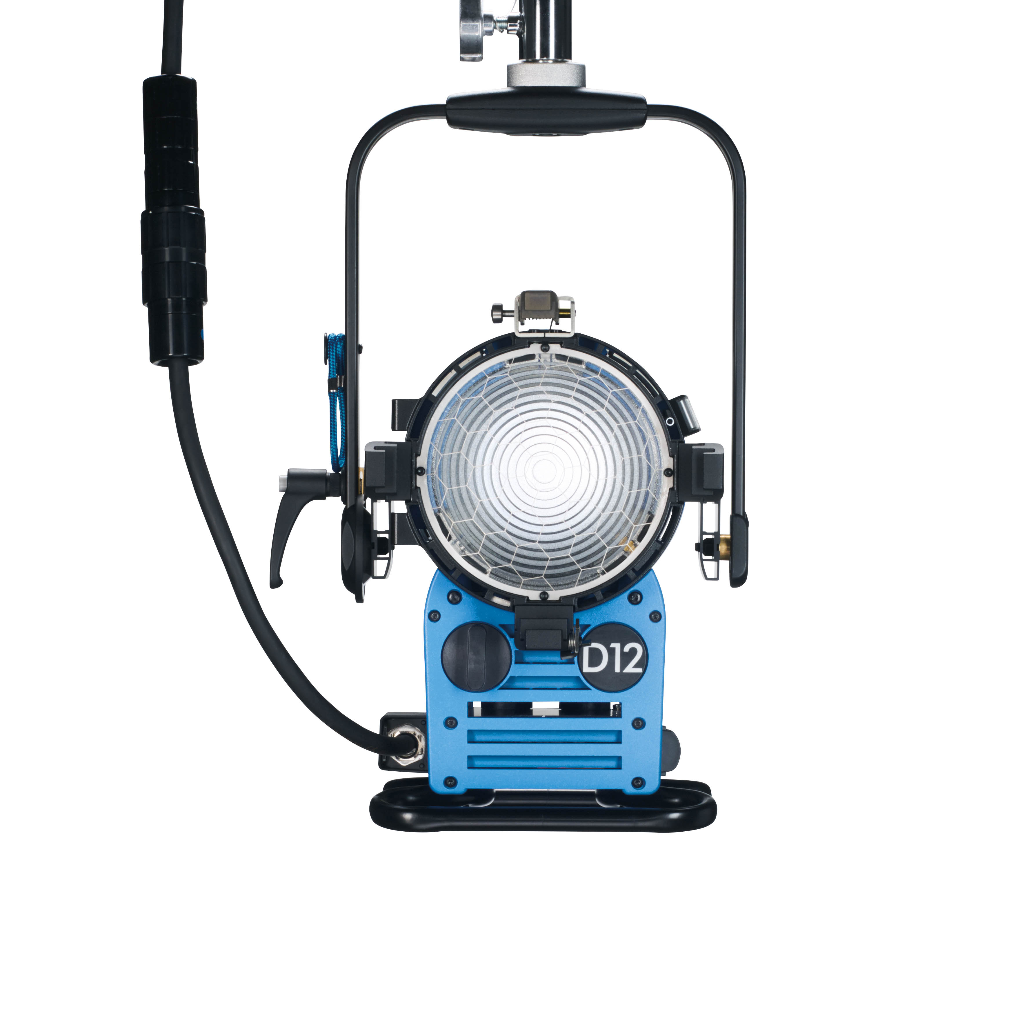

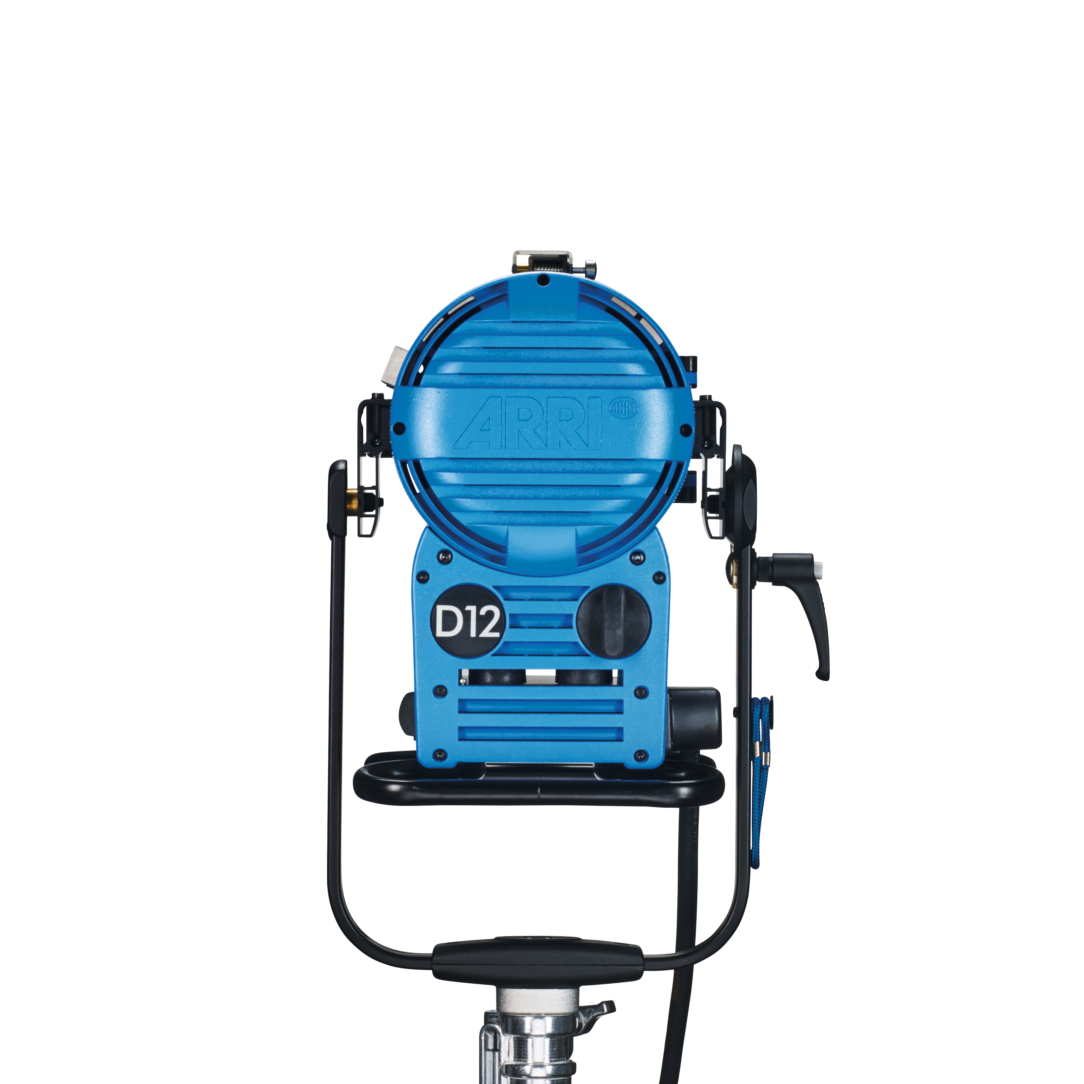

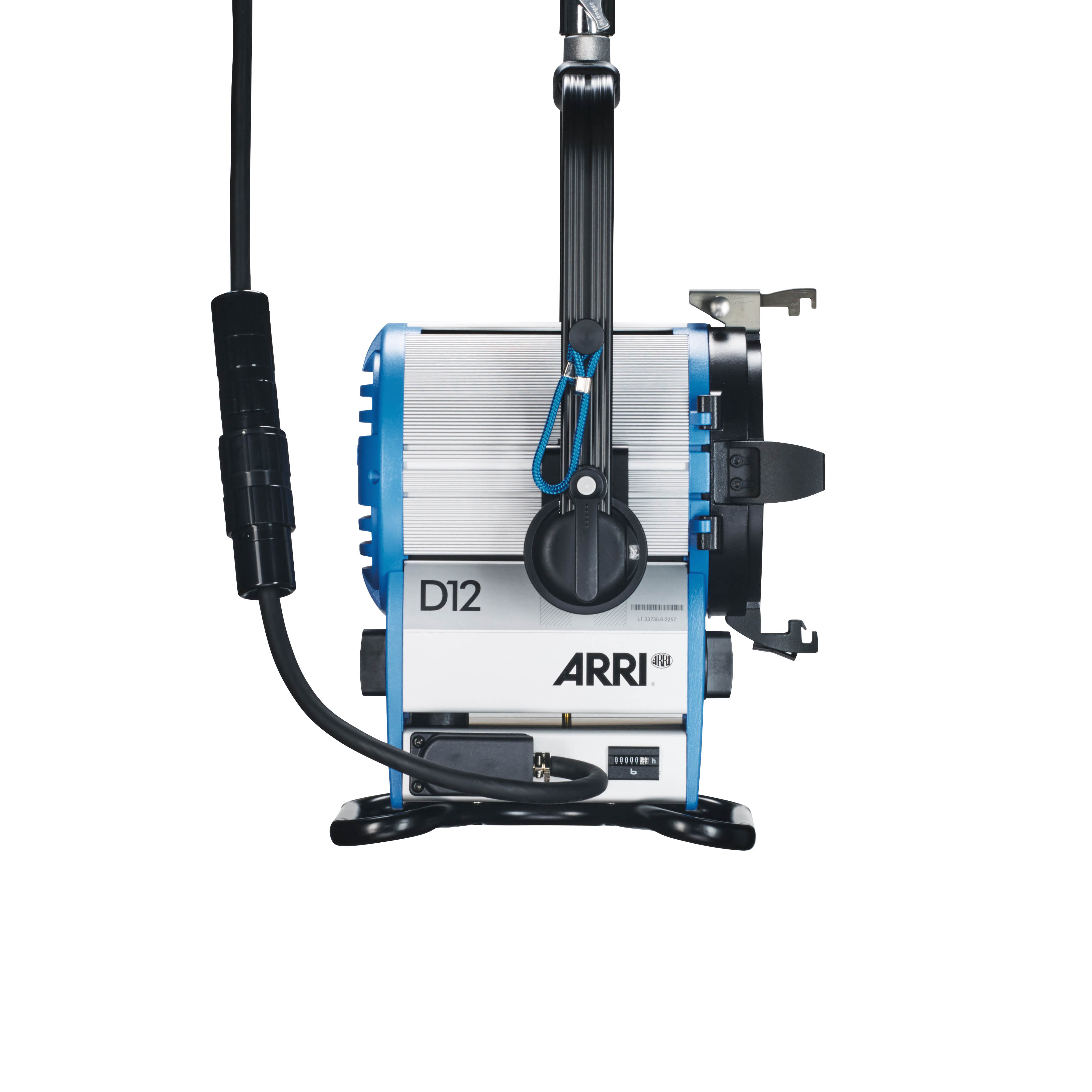

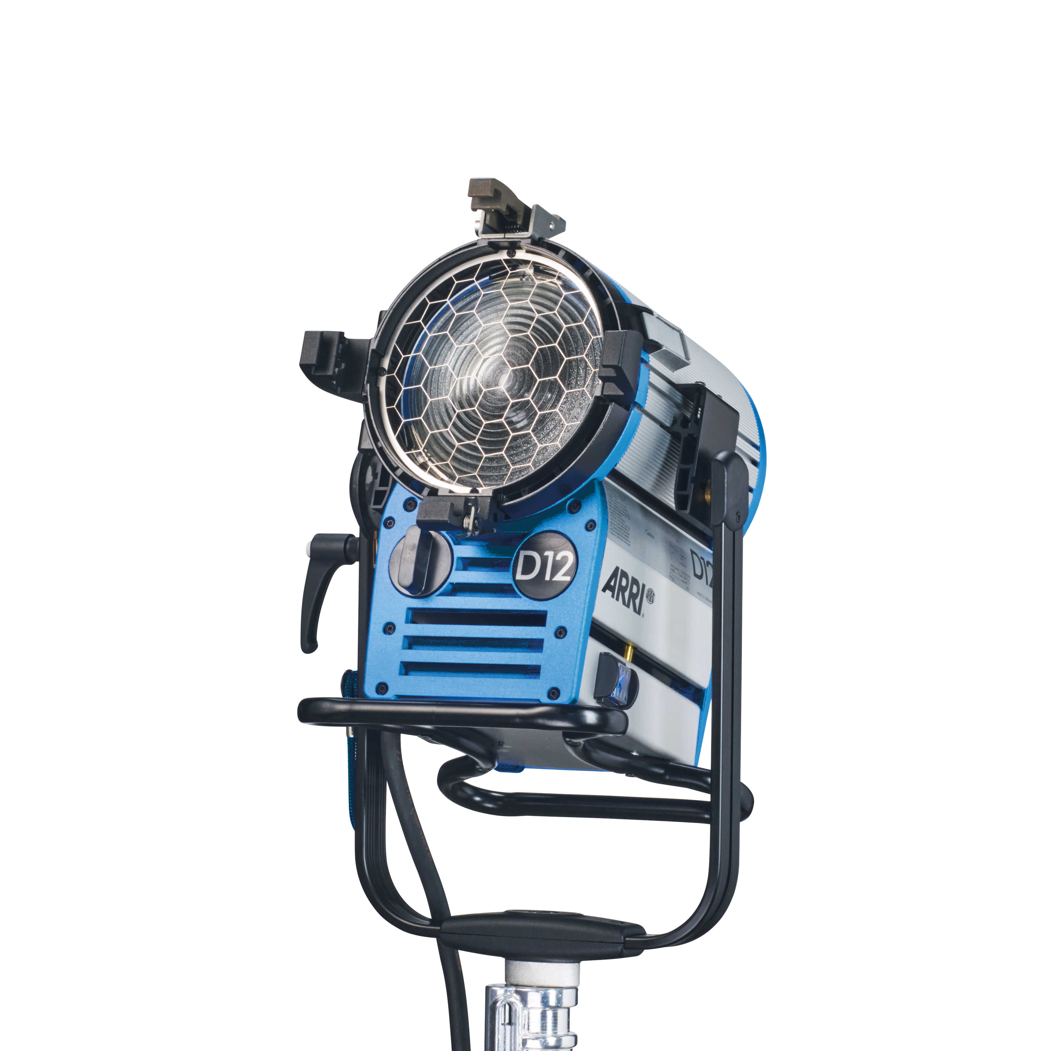

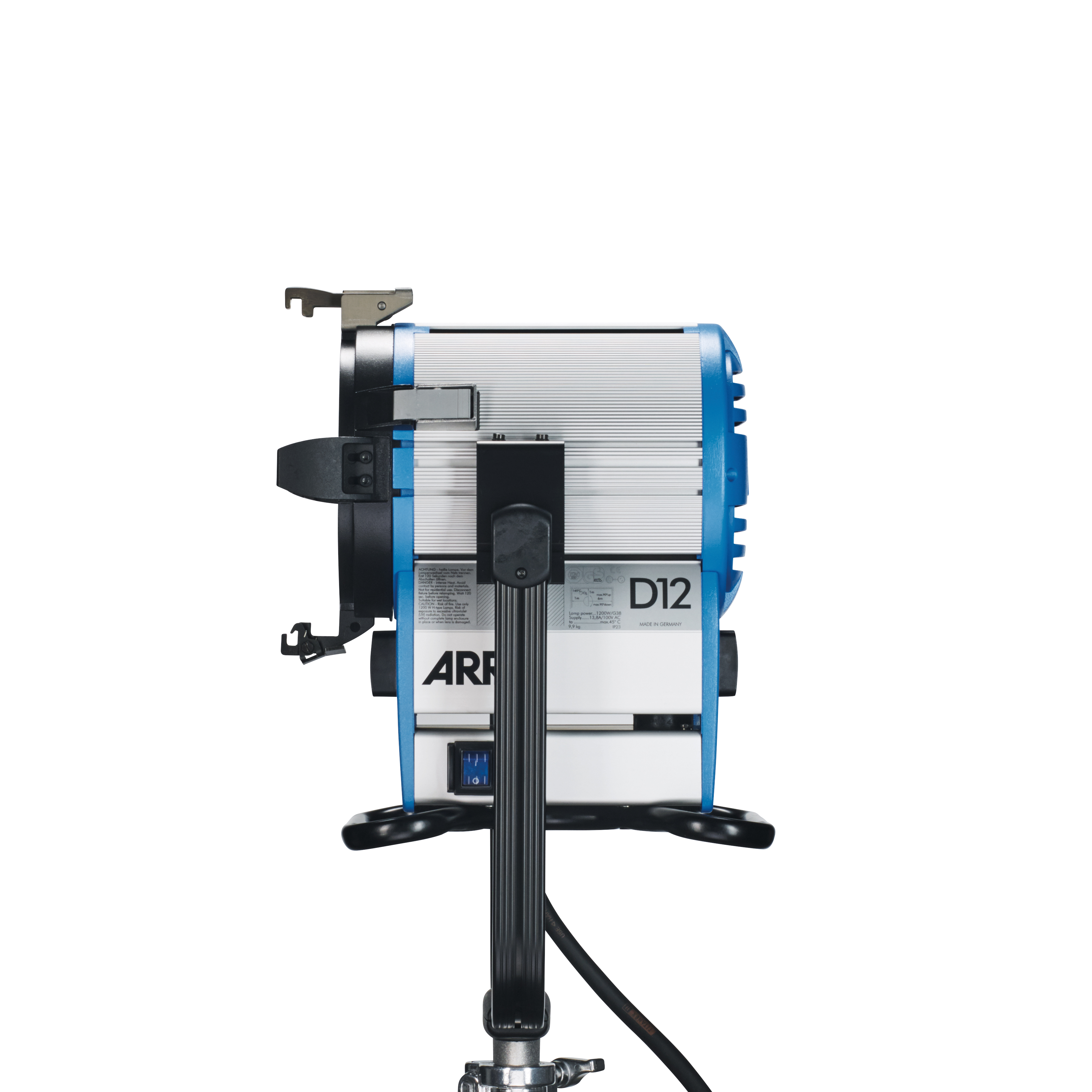

Highly innovative lampheads for studio and location lighting
Where a lightweight Fresnel spotlight using daylight characteristics with compact size and high efficiency is needed, ARRI True Blue D-Series Fresnels are the preferred choice. ARRI's elegant modular construction, using corrosion-resistant aluminium extrusions and lightweight die castings, offers great structural strength and weather resistance. Together with ARRI flicker-free Electronic Ballasts, the rugged True Blue D-Series is ideal for all types of location lighting.
Features
  • Cross-Cooling System
  • Easy Maintenance
  • Adjustable accessory brackets
  • Barndoor Safety Catch
  • Sliding and lightweight stirrup
  • Tilt lock with disc brake
  • Stainless steel lens protection
  • Robust True Blue barndoors
  • Robust Location Top Latch
  • IP Rating IP23
