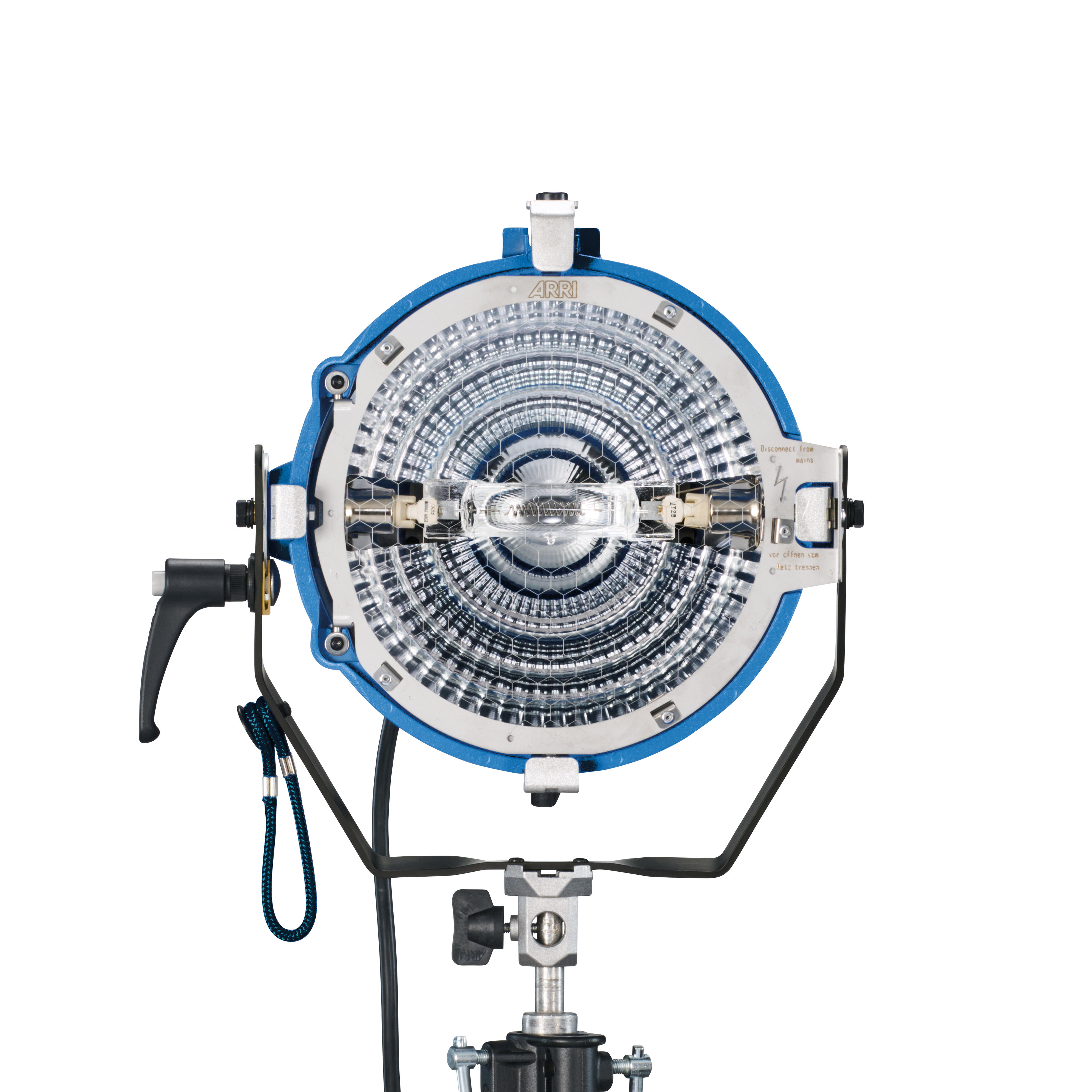

The continuing popularity of the ARRILITE 2000 has inspired ARRI’s lighting team to undertake a complete redesign and update of this traditional, open-faced lamphead. Incorporating a range of innovative features, the new ARRILITE 2000 Plus meets the exacting production demands of today’s film and television industries. By utilizing the ARRIMAX reflector and optical system, light efficiency is increased and light distribution improved.
The aluminum housing is more compact and about 400 g lighter than the previous model, while disc brake technology borrowed from the ARRI True Blue range holds the ARRILITE 2000 Plus steady even with heavy accessories attached. In order to change bulbs, the door opens in a similar way to the ARRI M18; no screws have to be removed and no tools of any kind are needed. Like the ARRILITE 750 Plus, the ARRILITE 2000 Plus features an improved focus mechanism and heat-proof handle at the rear of the housing that facilitates easy maneuvering.
Features
  • MAX Technology reflector enables higher light efficiency and better light distribution
  • No tools required to change the bulb
  • 400 g lighter and more compact housing than the previous ARRILITE 2000 model
  • Aluminum housing enables heat dissipation
  • True Blue disc brake technology
  • Heat-proof handle at rear of housing enables easy maneuvering
Category
Series
Model
ARRILITE 2000 Plus
Mains Plug
Schuko, Bare Ends
Lamphead Type
Open Face with parabolic facetted reflector, 2,000 W
Reflector
MAX reflector made of high purity aluminium
Lamp Type
FEX 2,000 W/230 V, FEY 2,000 W/120V
Power Consumption
2,000 W
Voltage Range
220 to 240 V
Lamp Base
RX7s
Dimming
yes, 0 to 100 % via external dimming system
Correlated Color Temperature
3,200 K
Beam Angle
24° to 63°
Weight in kg net*
approx. 3 kg
Weight in kg packed*
approx. 6 kg
Weight in lbs. net*
approx. 7 lbs
Weight in lbs. Packed*
approx. 12 lbs
317 x 355 x 241 mm
12.5 x 14.0 x 9.5"
375 x 345 x 320 mm
14.8 x 13.6 x 12.6"
215 mm
8.5"
Accessory Diameter in mm
254 mm
Accessory Diameter in inch
10.0" (Scrim)
Barndoor in mm
254 mm
Barndoor in inch
10.0"
Mounting
Socket 16 mm / 5/8" (0.6")
Housing Color
Blue
Protection Class / IP Rating
I / IP20
Certifications
CE, CB, ENEC, cNRTLus
