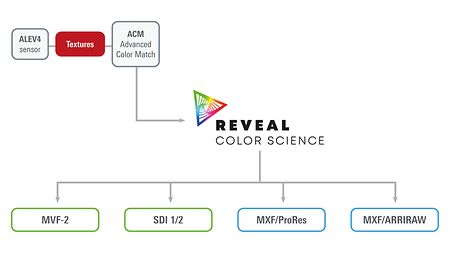

ARRI Textures are applied to the image before the EI setting, which controls the camera's sensitivity, and before REVEAL Color Science. Both determine the basic behavior of grain and contrast in your image.

Since ARRI Textures are settings for image processing steps that occur before the ARRIRAW image is created in the camera, ARRI Textures are always baked into ARRIRAW and ProRes.
