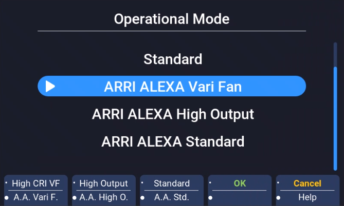

Various operational modes and settings allow SkyPanel X and Orbiter to adapt to any possible demand or application. Customizable choices include light quality and fan mode settings, as well as dimmer curves and transition types. Tungsten emulation, flicker-free high-speed mode, and an option to use external triggers are also built in.

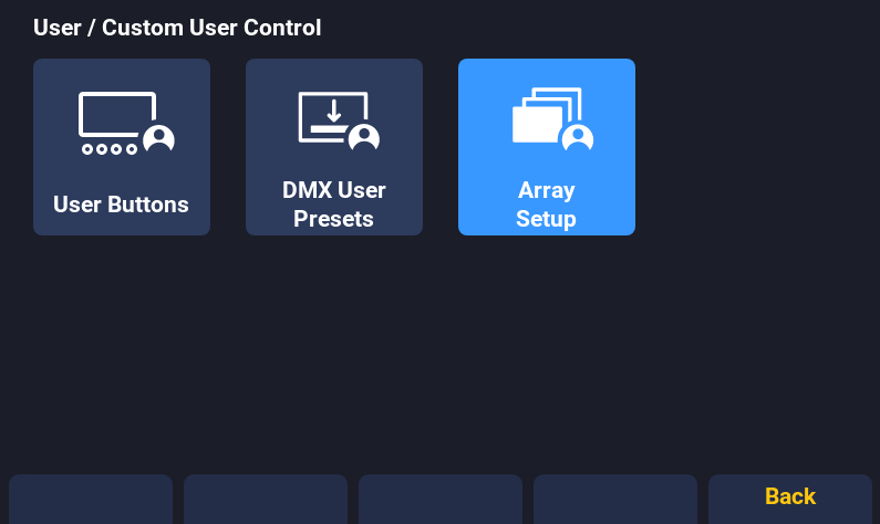

07-lios-user-buttons-area
User-programmable interface
Every user will find their own way to create fantastic lighting with their ARRI fixture. The User button is designed to give you quick access to your personal settings and workflow. Hold down the user button to program and store your own navigation menu.
