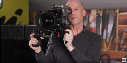

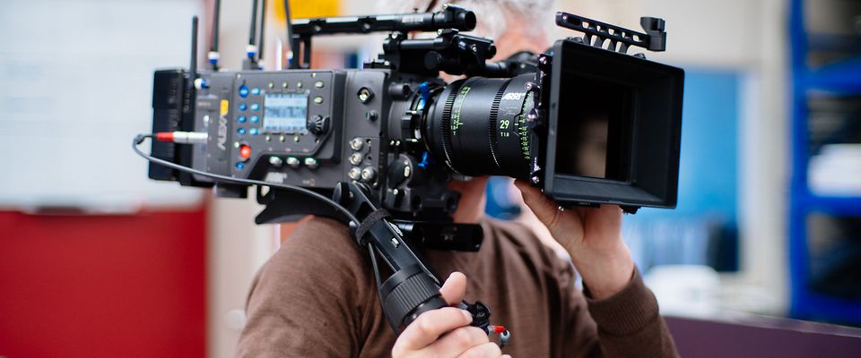

The Master Grips are useful …
… for crash zooms as a visual storytelling tool

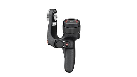

… as a zoom control unit for pan bars

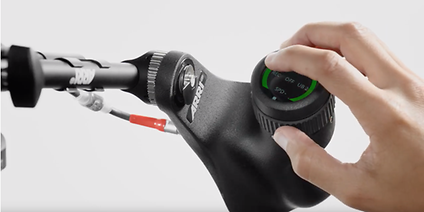

… when you need a solid grip with full control at the same time
… when you don’t know what’s happening next and you need to react quickly and flexibly
… when you shoot interiors of a car, helicopter or on any other tight locations
… when you shoot on a small speedboat with no focus puller

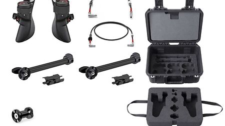

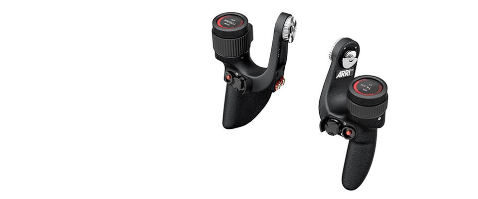

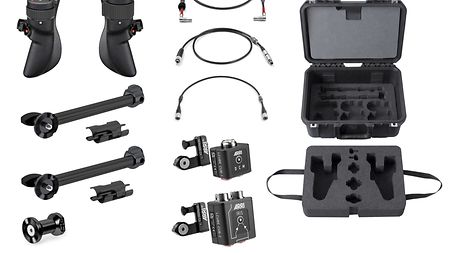

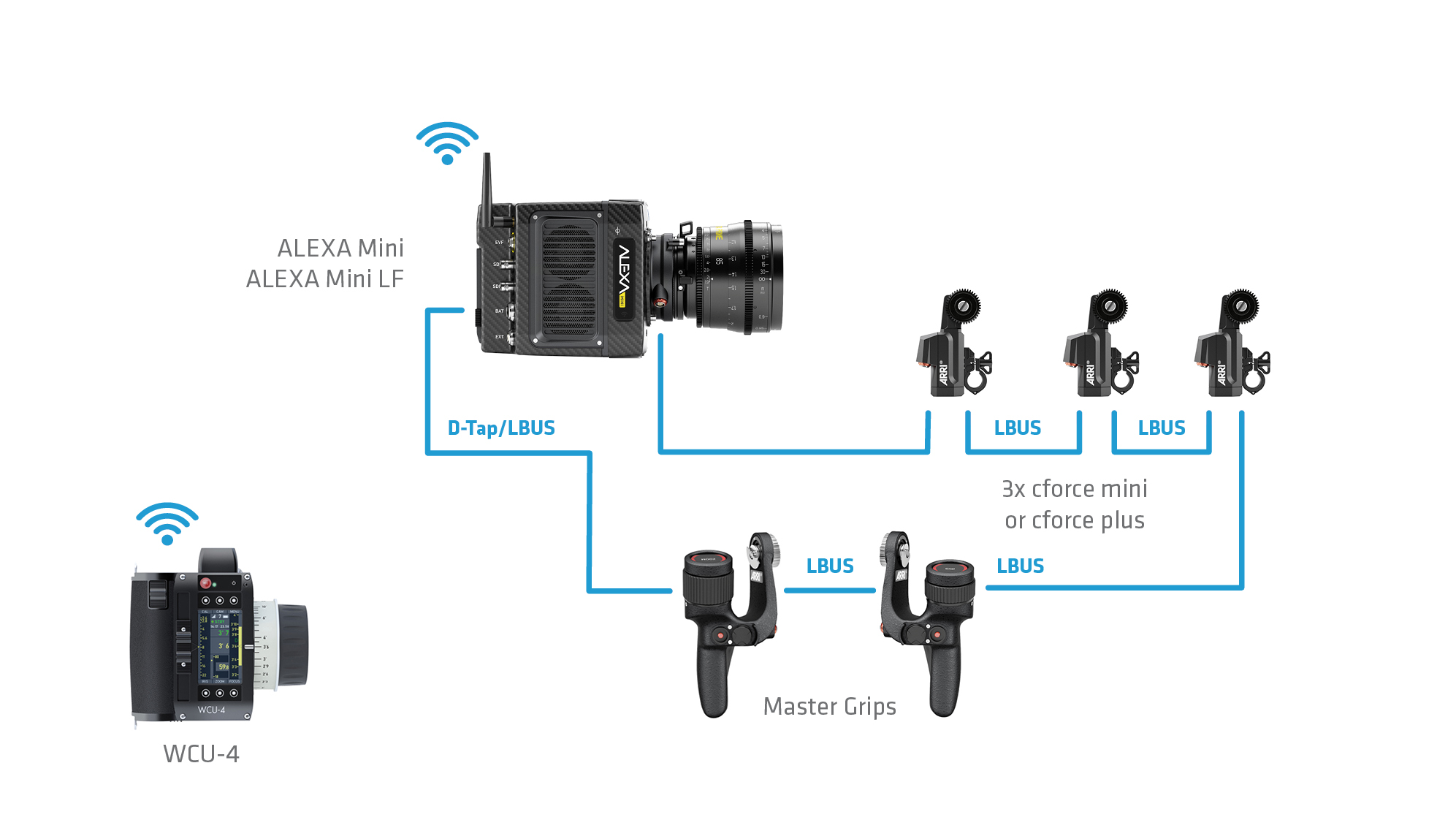

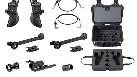

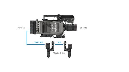

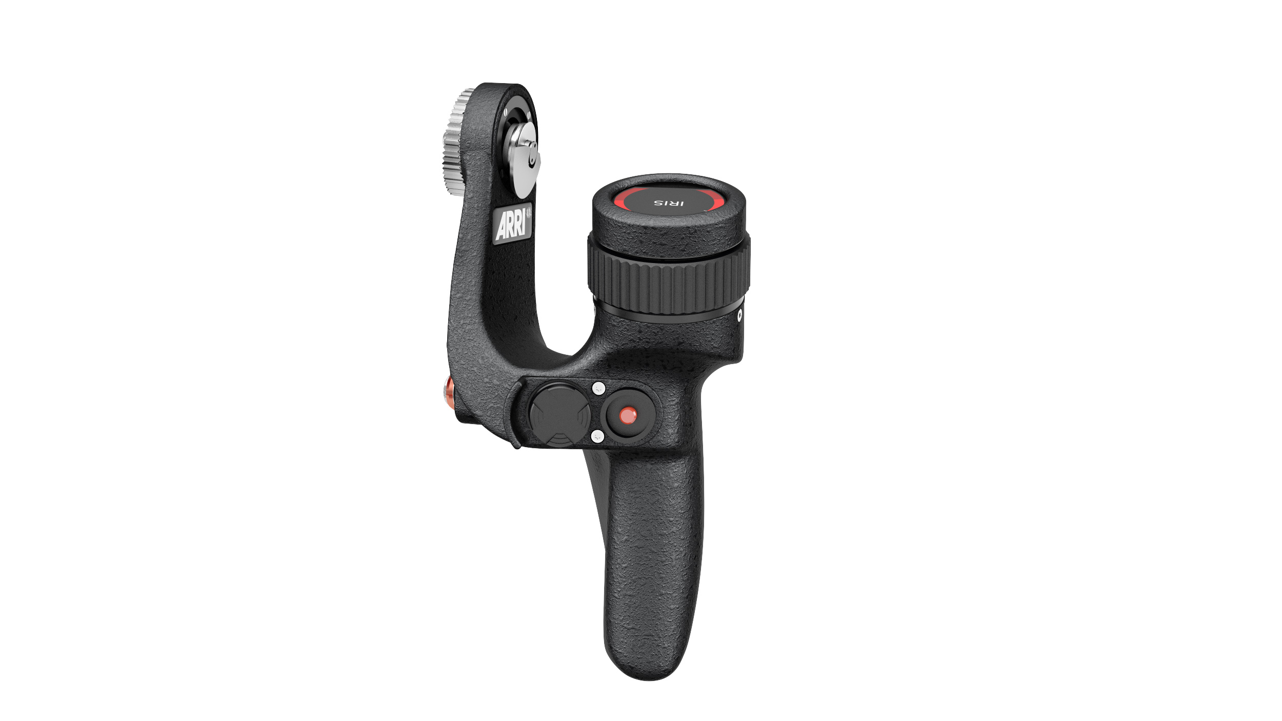

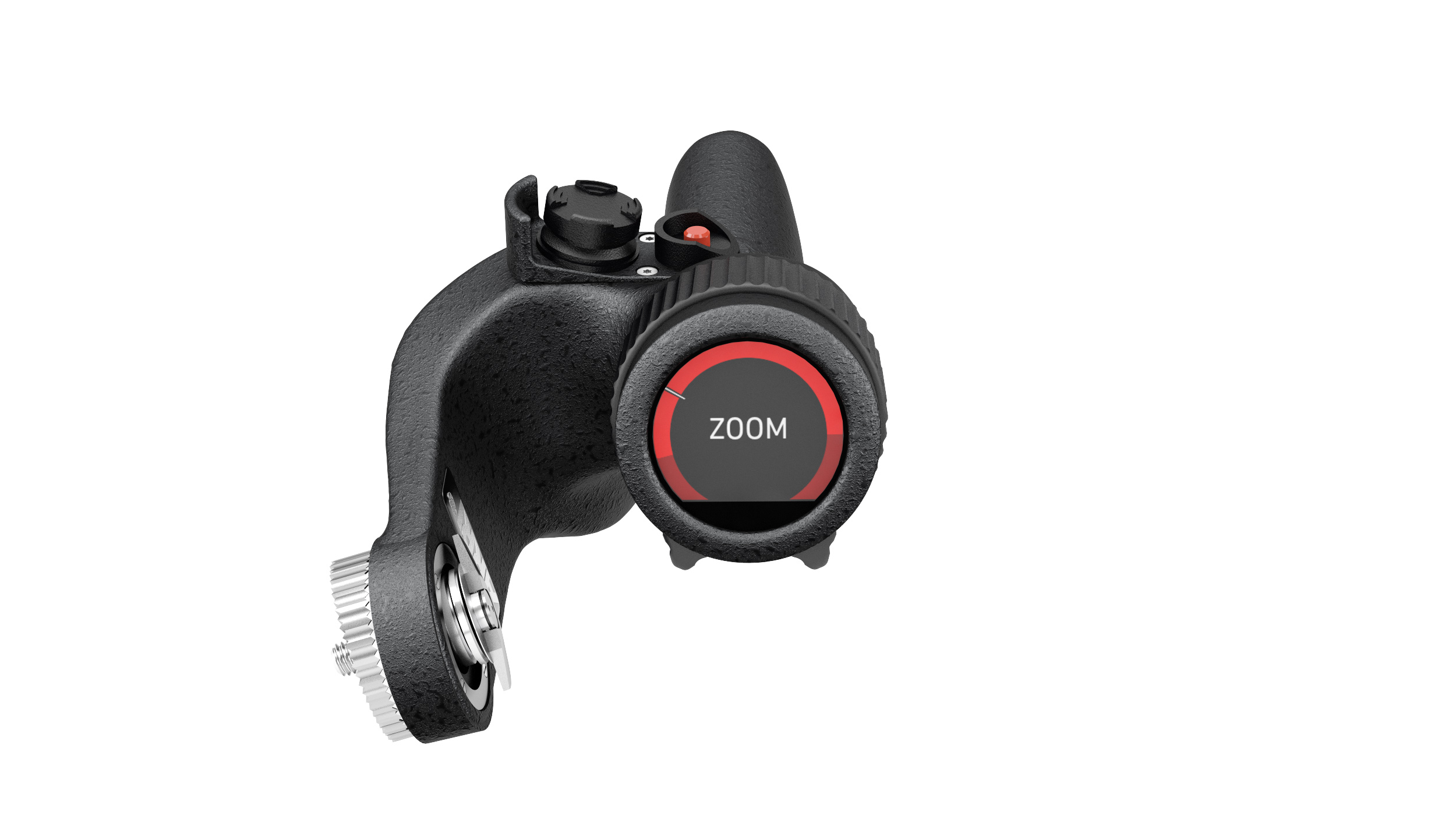

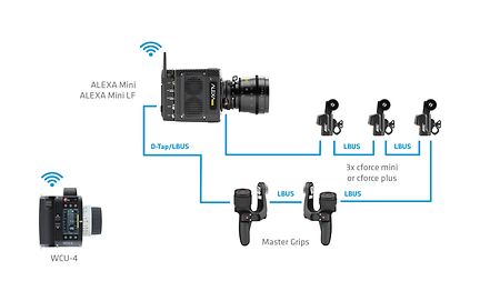

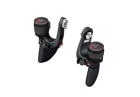

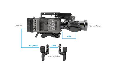

Yes, it is possible assign camera user buttons to the Master Grips and control up to 6 user buttons per Master Grips set. The corresponding function of a user button can be set on the camera. Please check the designated camera user manual on how to set the user buttons.

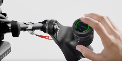

Yes, you can assign SPD+ (increase speed) and SPD- (decrease speed) to any of the Master Grips´ user buttons and also set the motor speed from minimum to maximum within the motor screen. The speed is set as the ratio between lens range and wheel range (1:4, 1:2, 1:1, 2:1, 4:1).
Yes, move the motor to the first limit position and press the LIM function assigned to one of the user buttons. The first limit is set. Then move the motor to the second limit. Press the LIM button again. The second limit is set. The motor now only operates in the defined range between both limits.
Yes, the assignable function TCH LCK (touch lock) locks the touchscreen.

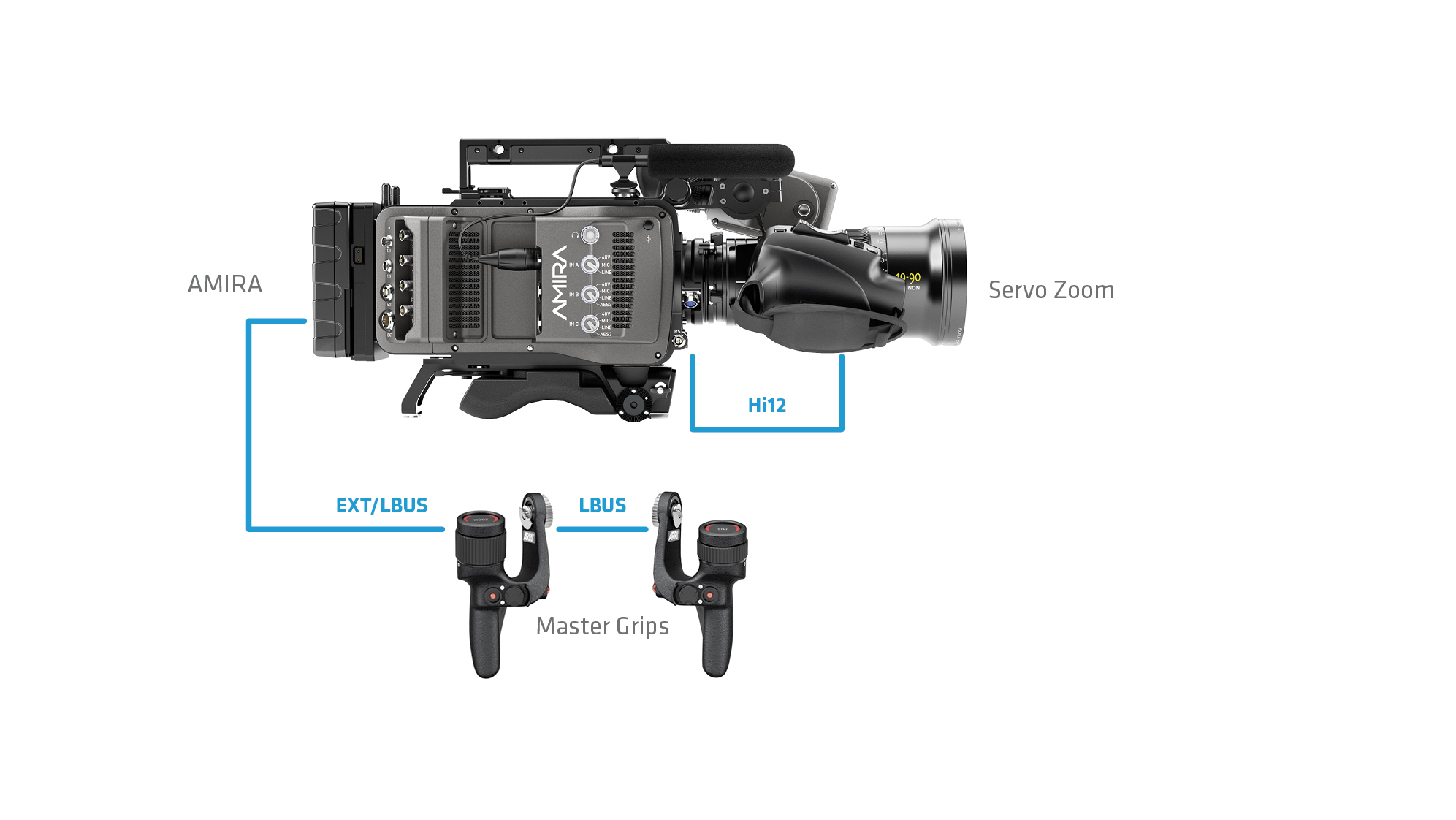

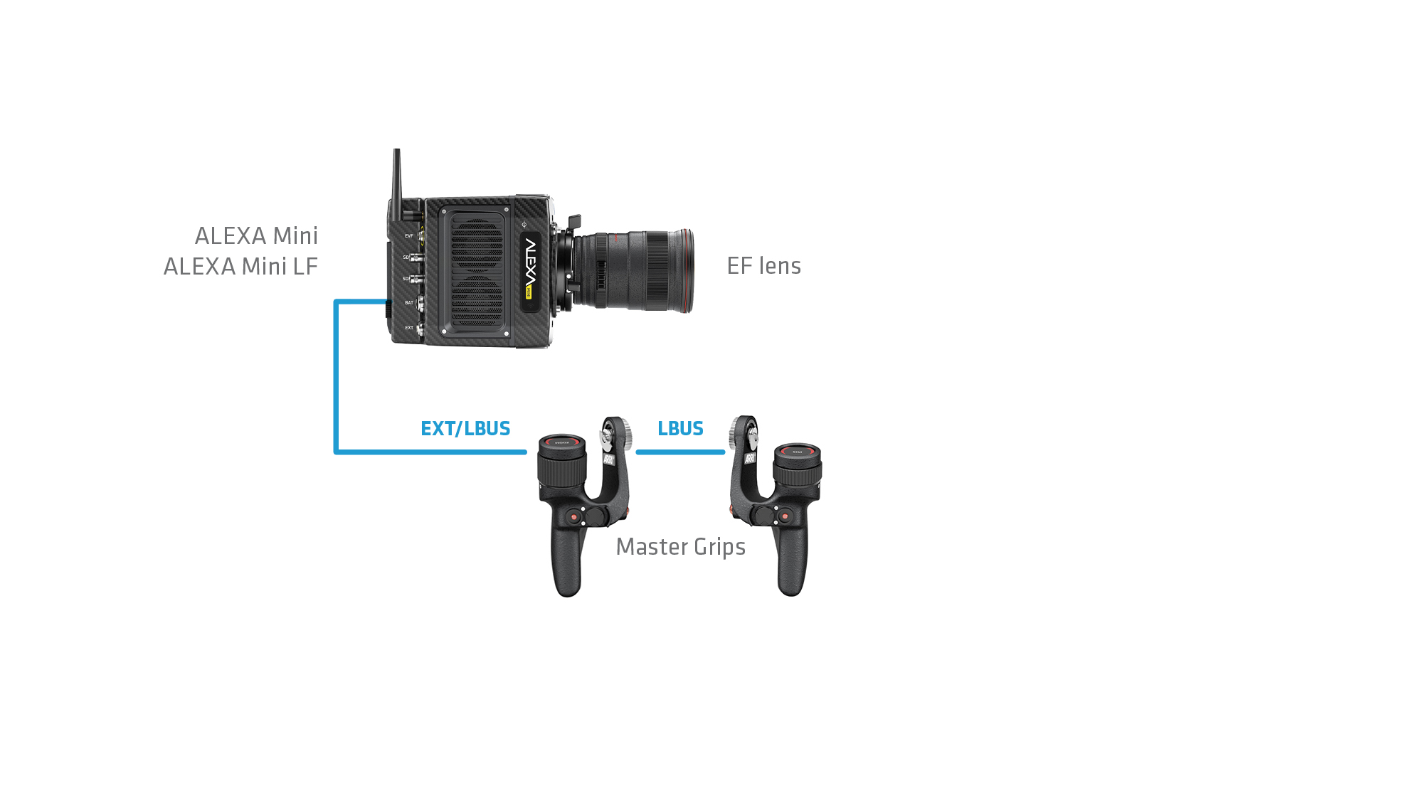

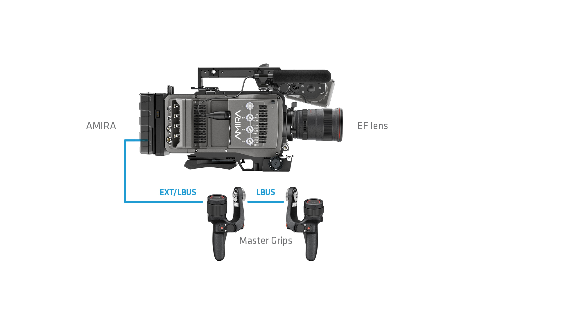

Yes, you can use the Master Grips on 3rd party cameras but with limited functions than when used with an ALEXA or an AMIRA camera.
