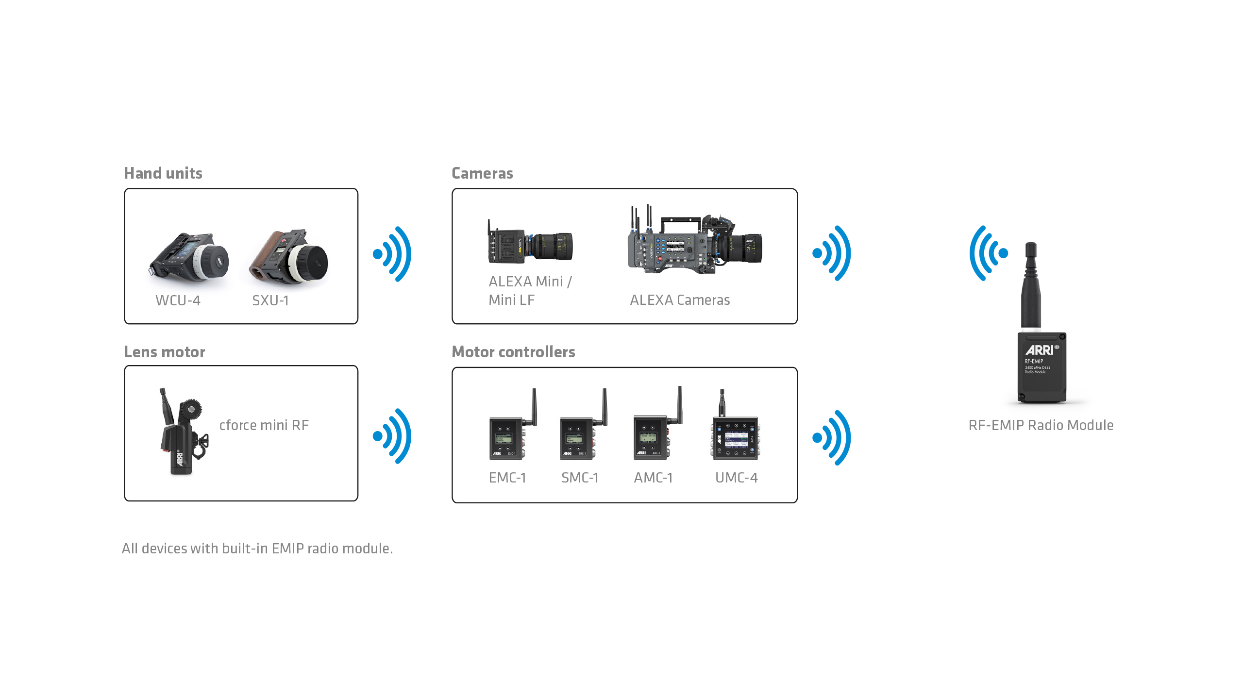

RF-EMIP Radio Module - worldwide
Meet the modules

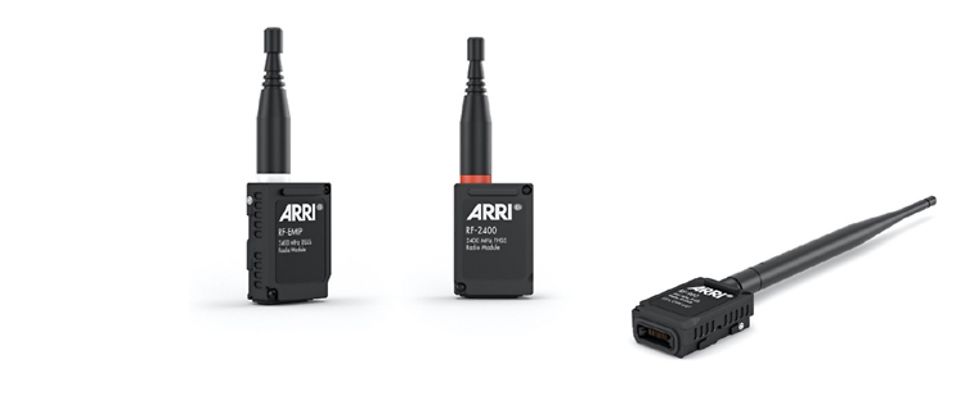

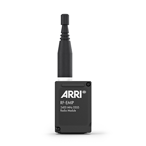

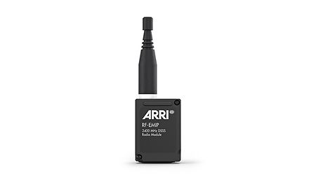

RF-EMIP Radio Module 2400 MHz DSSS
  • White radio module
  • Certified globally
  • 14 channels
  • Backwards compatible with all white-coded radio devices (e.g. WCU‑4, SXU-1, ALEXA Plus, ALEXA Mini, ALEXA Mini LF, ALEXA LF, ALEXA 65, UMC-4, EMC/AMC/SMC-1, cforce mini RF)
  • Network mode: can pair with up to three hand units for split focus, iris, and zoom operations to one camera/motor controller
  • Rugged, field-proven, outdoor di-pole antenna

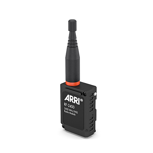

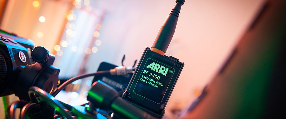

RF-2400 Radio Module 2400 MHz FHSS
  • Transmitting power: 100 mW
  • 100 channels
  • Long-range, point-to-point connection for challenging RF environments

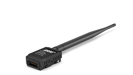

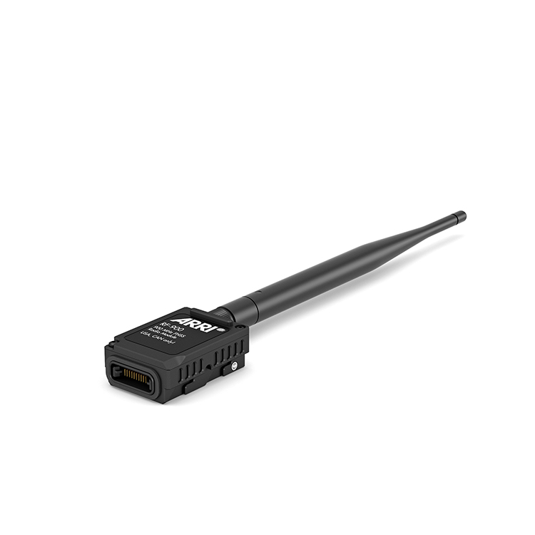

RF-900 Radio Module 900 MHz FHSS
  • Long-range solution
  • Certified regions: USA and Canada
  • 100 channels (= defined hopping schemes)

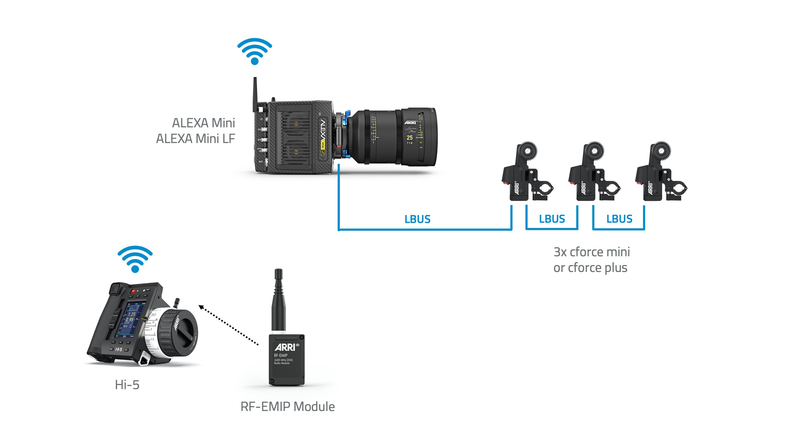

Hi‑5 + RF-EMIP connected to ALEXA Mini/Mini LF and cforce motors

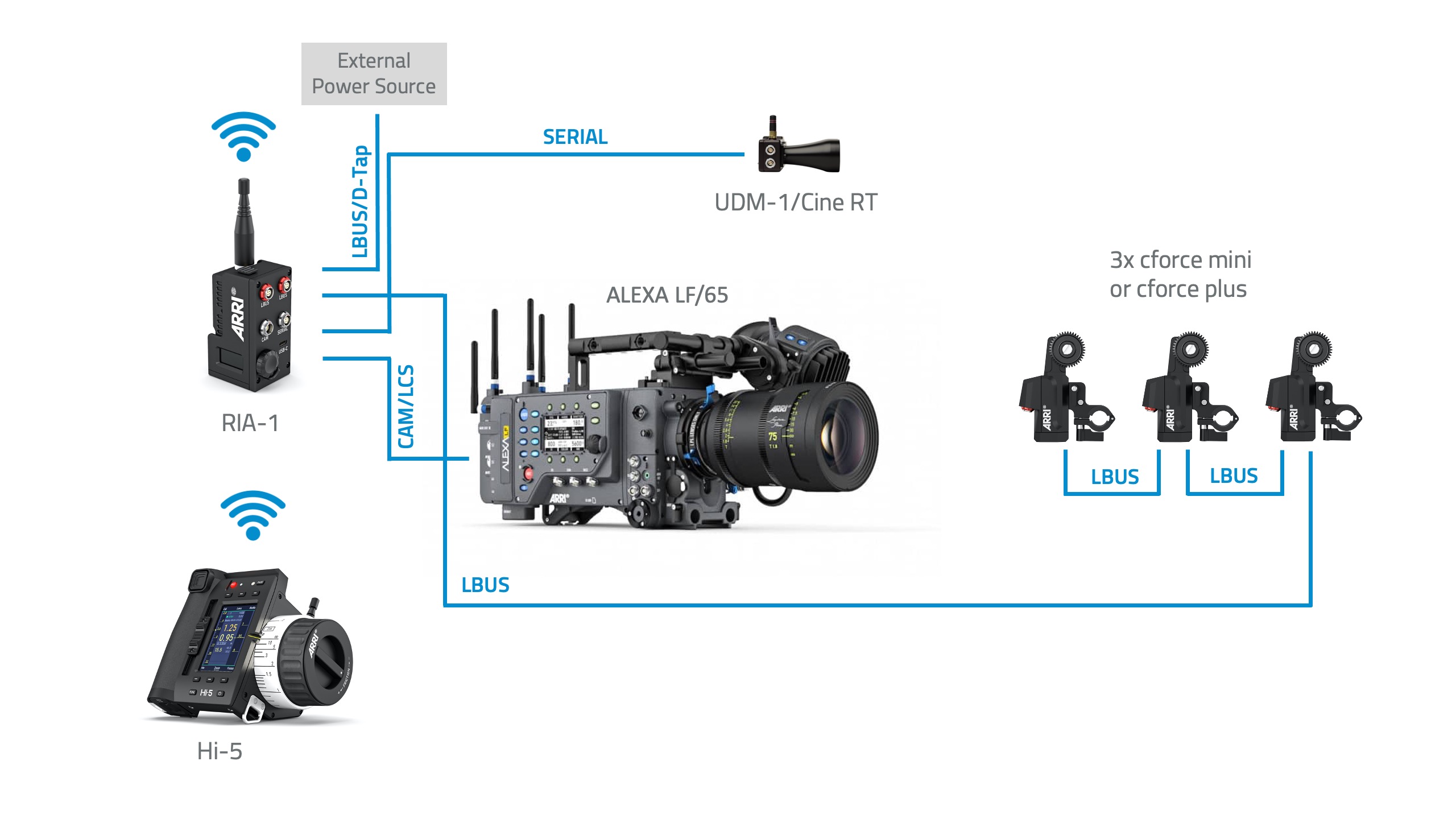

Hi‑5 + RF-EMIP connected to ALEXA LF or ALEXA 65 and cforce motors

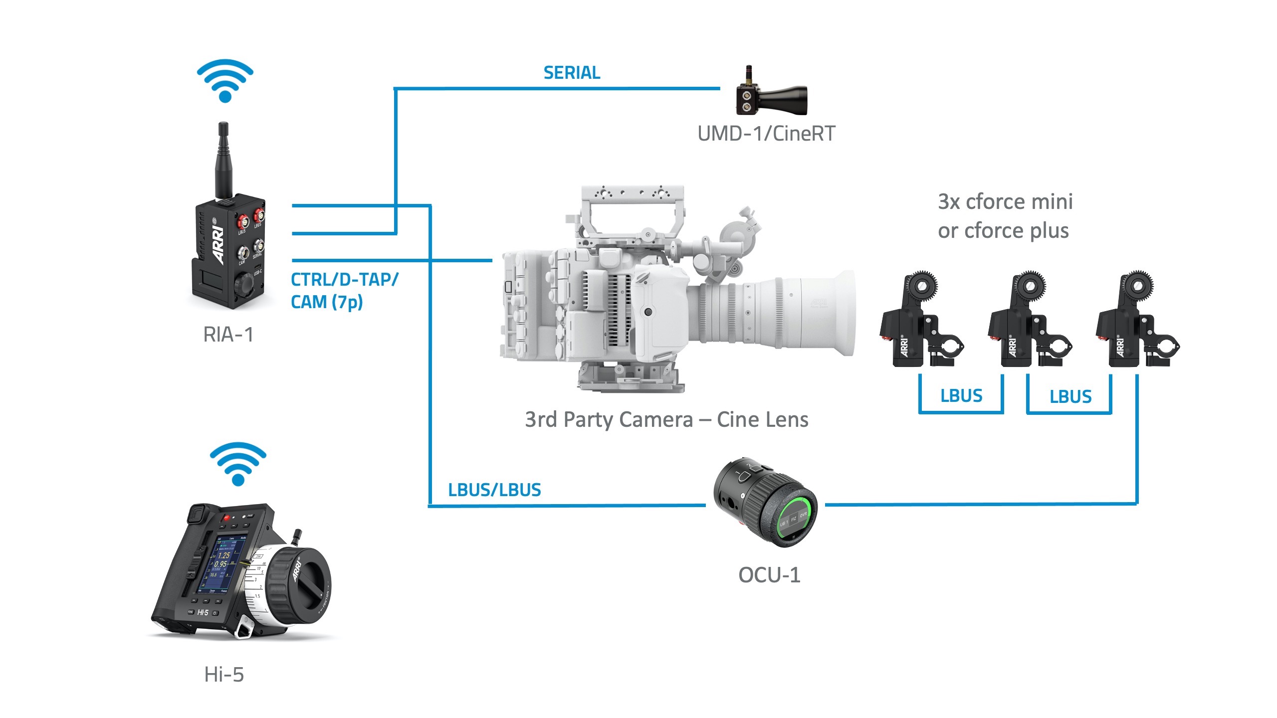

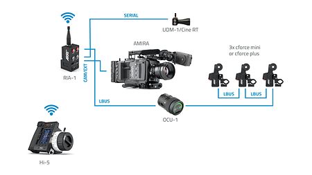

Hi‑5 connected to RIA‑1 and cforce motors with ALEXA camera control

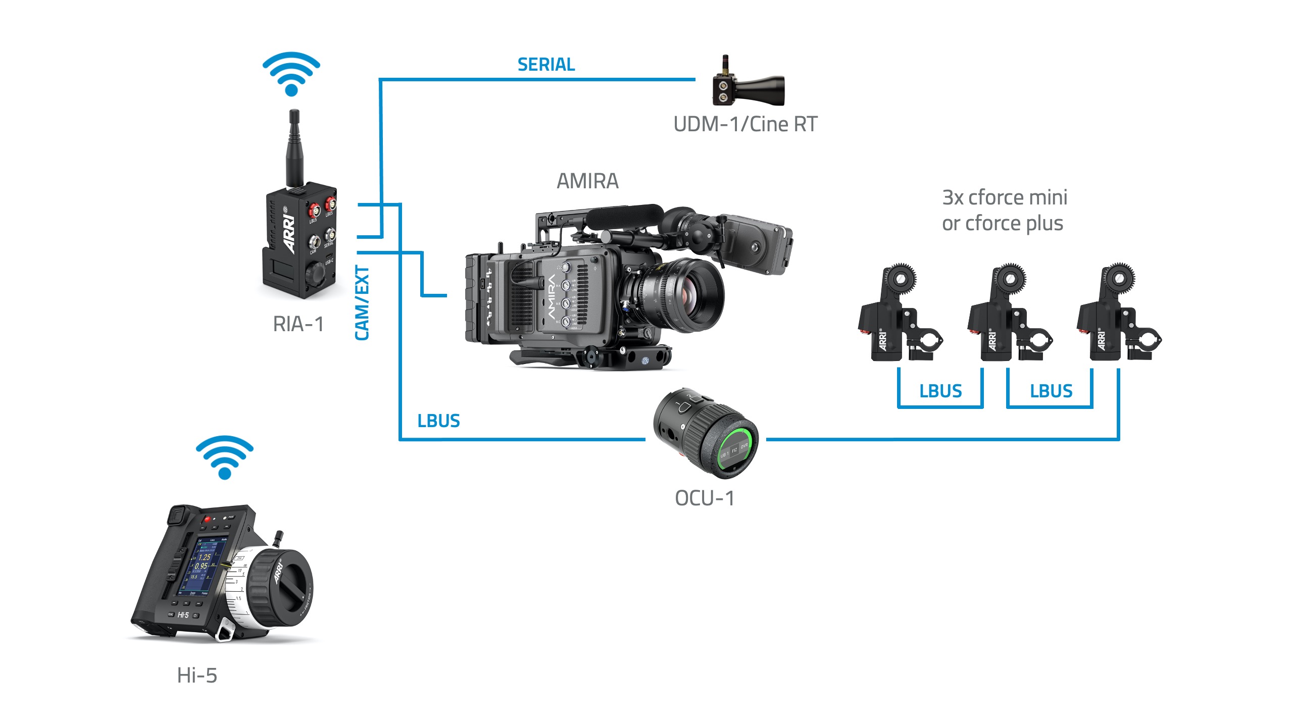

Hi‑5 connected to RIA‑1 and cforce motors with AMIRA camera control

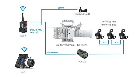

Hi‑5 + RF-EMIP connected to cforce mini RF for 3rd party camera and lens control
Hi‑5 connected to RIA‑1 and cforce motors with 3rd party camera control
