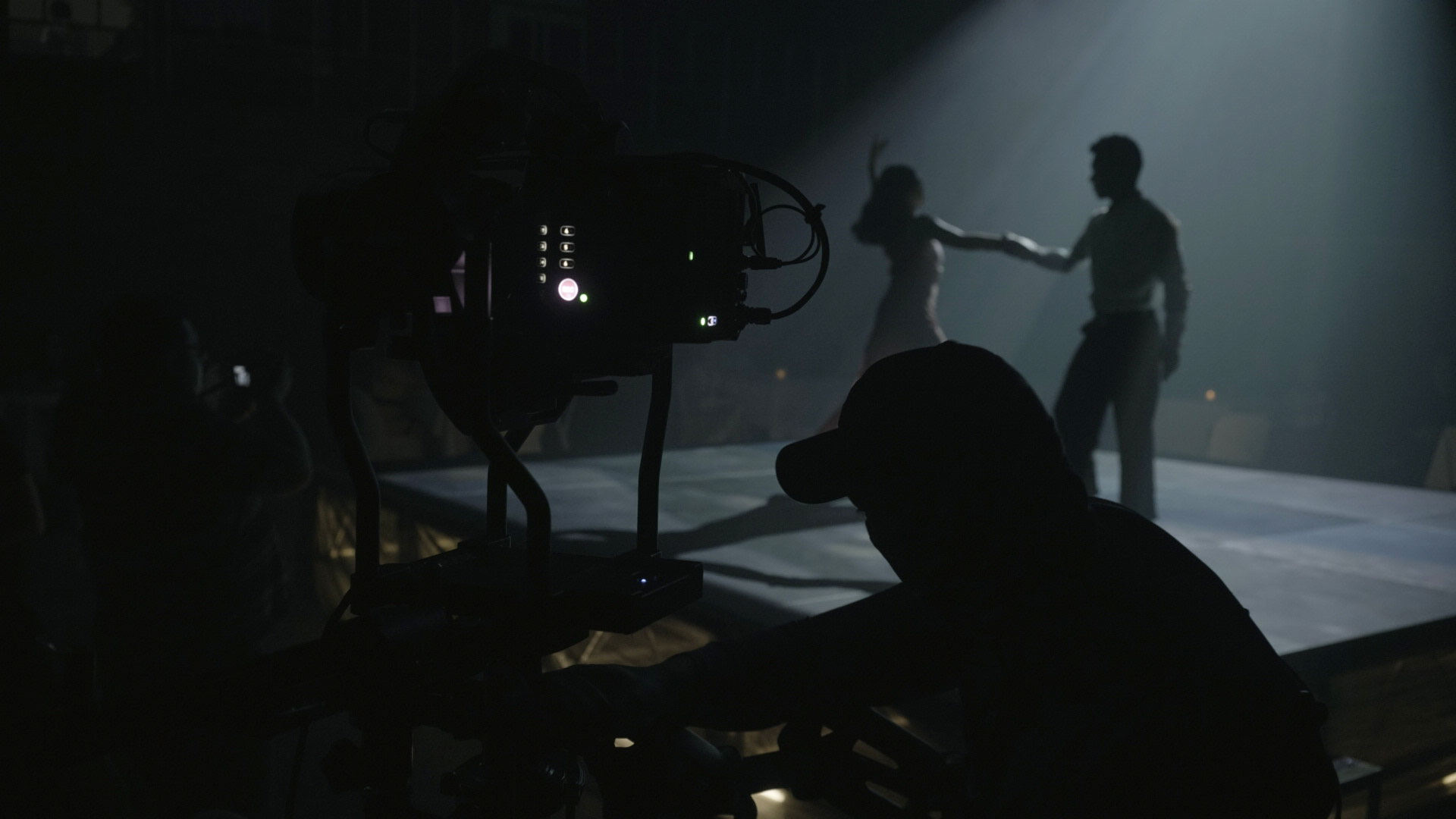

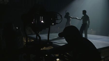

You also had to film in a very dark environment. How did the cameras perform?

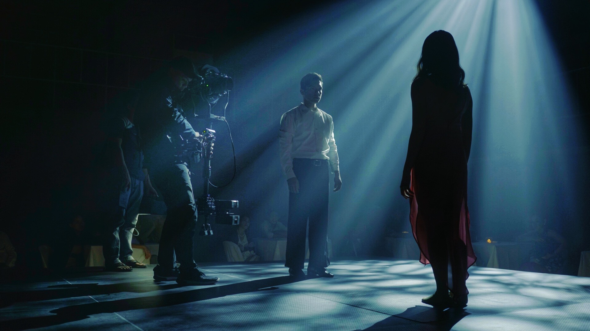

Prime wanted the film to be moody. One of the scenes that I’m really proud of was the final dance scene. We had to mimic the light that hits the ocean so we rigged a 8,500-lumen projector and projected a looping video of the sea for the wide shots and used a few sharp lights for the close ups. At first, we had a hard time finding a supplier, who would allow us to rig their projectors but we were lucky to find one last minute. The dynamic range of the ALEXA LF and Mini LF was impeccable considering our scene’s lighting ratios. It is perfect and just as how I imagined it would be.
After working with other ARRI cameras in the past, how was it to shoot with ARRI’s large-format camera system?
At first, I had to adjust with the lensing, but it became easier after a few days of shooting. The image quality is superb and the wireless output makes everything faster. The large-format system captured the highlights and shadows so well, with very low noise. The larger sensor size gave colorist Nico Ebora and myself more depth in color grading especially with our VFX and high-contrast scenes. And I really like the portability of the Mini LF.
For some scenes an ARRI TRINITY, operated by JR Misa, was in use. When did you work with this camera stabilizer system?
For the dance sequence we wanted to stay true with the design and mimic the movement of water. I knew I needed a smooth camera stabilizer that could go really low and high at an instant. So, I personally talked to JR about my plan to use the ARRI TRINITY weeks before the Mini LF arrived in Manila. We were the first ones to test the TRINITY and use it with the Mini LF as a combo. This was my first time to use the stabilizer and I was really happy with our results.
