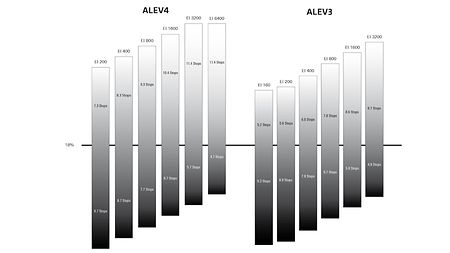

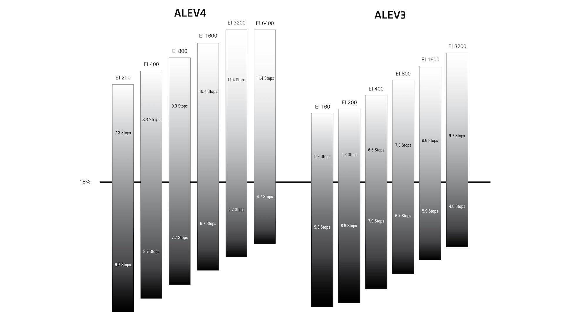

ARRI digital cameras are equipped with one of two basic sensor designs: ALEV3 and ALEV4, both offering exceptional dynamic range. In both sensors, special consideration has been given to highlight treatment. Creating a good-looking roll-off in the highlights is probably one of the most difficult tasks for any sensor designer and we have spent enormous resources to ensure exceptional highlight handling. Both sensors’ wide exposure latitude translates into a “thick” digital negative; this means tremendous flexibility when color grading. The sensors' ability to retain definition, even when extremely under or overexposed, provides that extra bit of security in post.
The new ALEV4 sensor (used in ALEXA 35) has an unparalleled dynamic range of 17 stops (see our Whitepaper on Dynamic Range for more Information), providing greater flexibility and efficiency for the cinematographer on the set and the best basis for HDR projects in post.
The ALEV3 sensor design used in all other ARRI digital cameras offers 14.5 stops dynamic range, still more than any other digital camera can produce.
High Sensitivity
ALEXA's imaging system has been carefully designed to exhibit high sensitivity so filmmakers can create the kind of rich and spellbinding pictures that audiences associate with cinematic storytelling. The camera's sensitivity can be adjusted from EI 160 to EI 6400 (ALEV4) and EI 3200 (ALEV3) and it is able to maintain its high dynamic range at almost all sensitivity settings. The ALEXA 35 (ALEV4) is equipped with an optional “Enhanced Sensitivity” mode and optional “Shadow” ARRI Textures even lower noise when faced with the dark sets. Extremely low noise levels allow working with lower light levels, which opens new visual possibilities for fresh and unusual images.

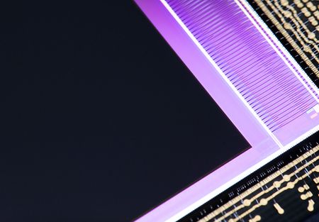

Optical Low Pass Filter (OLPF)
The low pass filter blocks high image frequencies that would lead to artifacts when captured by the sensor. It is made from a modern, high-performance crystal with optical properties that have been fine-tuned for a perfect match between the transmitted image content and the sensor's photosite structure in the camera. The result is the creation of super sharp yet natural images.

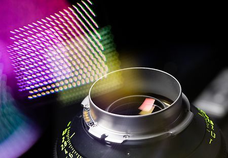

IR and UV filters
ARRI cameras use a high-end infrared (IR) and ultraviolet (UV) filter, which are custom designed to block enough of the spectrum to avoid false color effects (as could otherwise be seen e.g. with dark synthetic materials) but that leaves enough of the near red spectrum to give skin tones a pleasant look. Designing the IR filter is a precarious balancing act, and the IR filters in ARRI cameras are also closely matched to the spectral response of the camera's sensor and the color processing in the camera for best skin tone reproduction.

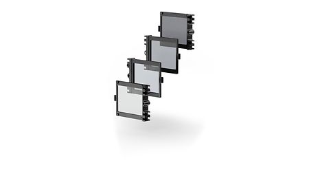

FSND Filter Mechanism and Behind the Lens Filter

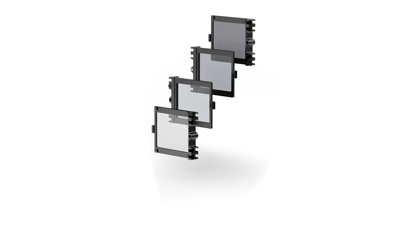

The AMIRA was the first camera to feature ARRI’s motorized FSND filter mechanism which is also used in ALEXA Mini, ALEXA 35, and bigger in size for ALEXA Mini LF. The ARRI FSND filter guarantees an even light reduction over the whole spectrum. Built into small filter frames in a motorized mechanism in front of the sensor, the FSND filter features three strengths that are available to dial in via the camera menu (0.6, 1.2, and 2.1 — plus optical clear. On ALEXA Mini LF and ALEXA 35: 0.6, 1.2, 1.8, and clear).
The ALEXA Classic camera series inherited the filter type in the form of a round “behind the lens filter” that sits magnetically secured in front of the sensor. For “matte box use” the same filters are also available as regular 4” x 5.65” and 6” x 6” filters.
