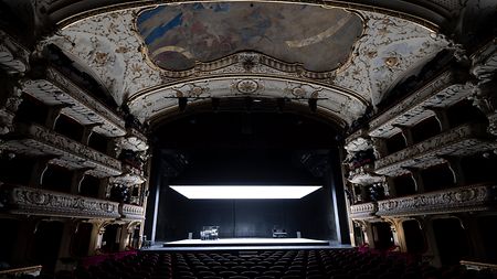

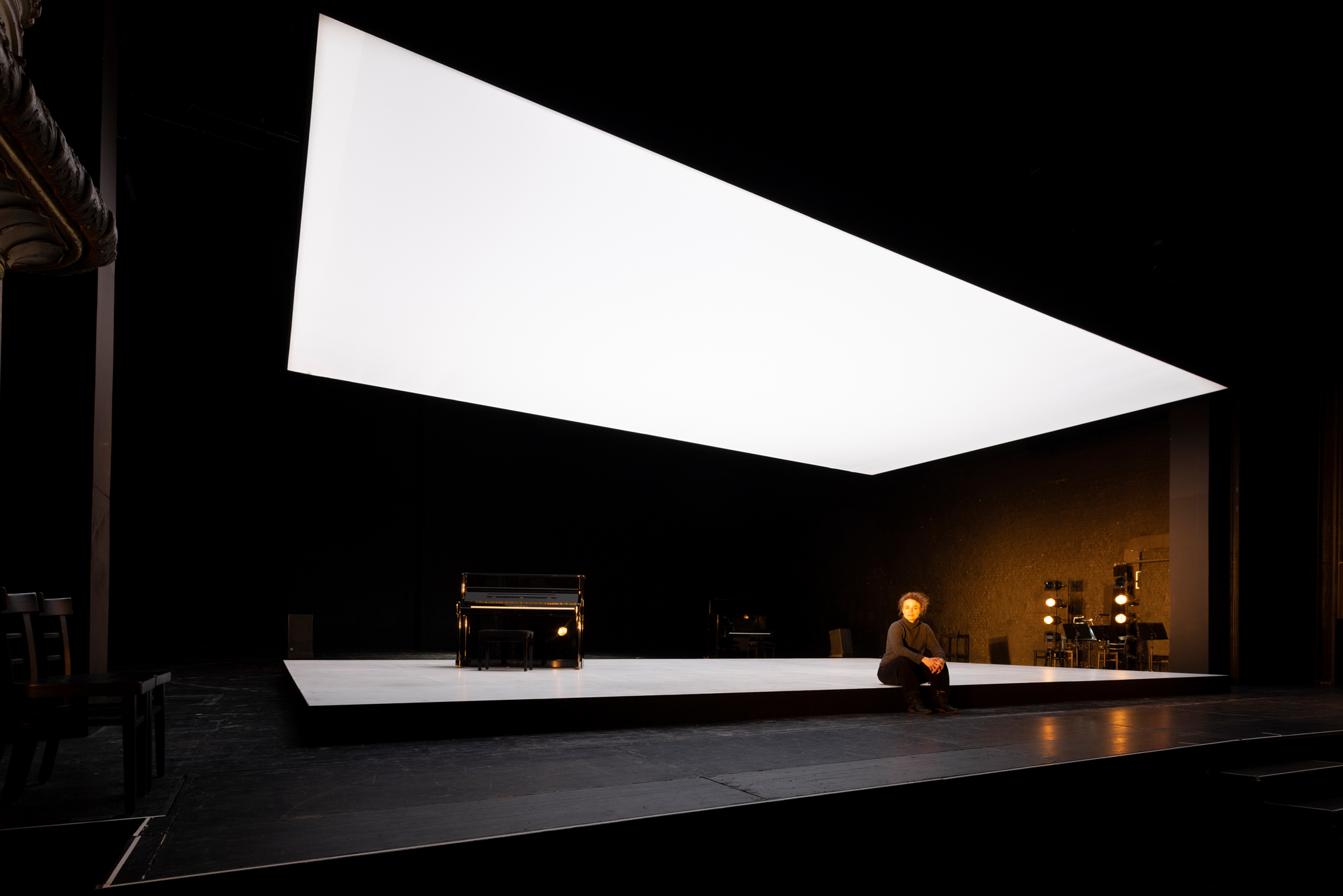

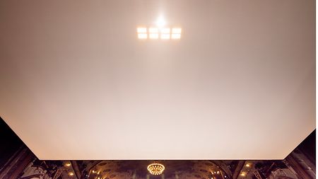

The artistic stage design by Johannes Schütz envisaged a white ceiling of the same size above a white podium measuring 6.5 meter by 11 meter. This ceiling was to be a brilliant white, continuously adjustable, and homogeneously illuminated surface.

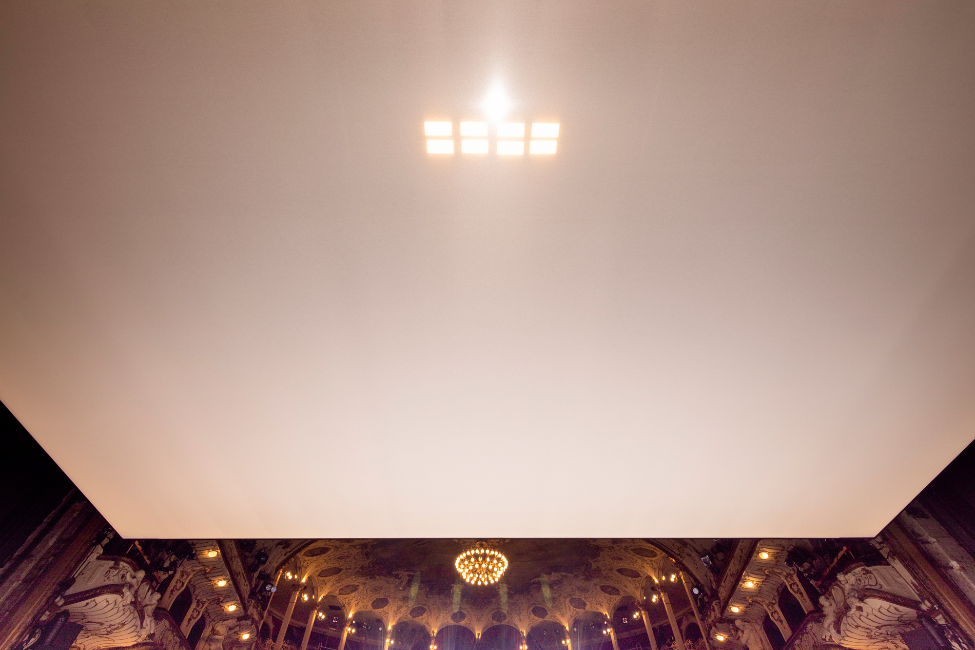

In the construction rehearsal, the lighting department was able to illuminate the plafond surface (a luminous rectangle, constructed out of a light transmitting theatre fabric) very well from a great distance with a single ARRI Compact 4kw light, but the surface reflected so strongly that the stage area was significantly illuminated by scattered light. Also, the issue of infinitely variable brightness control and shadow-free illumination by an ARRI Compact 4kw with a shutter was not optimally solved.
To keep the stage house as dark as possible, a fabric funnel was designed to be fixed between the ceiling and its light source. The fabric funnel intercepted the stray light and the surrounding stage house remained dark. However, for design reasons, this meant that the distance for the light source at the ceiling had to be limited to a maximum of seven meters. From this rather small distance, it was then no longer possible to illuminate the ceiling homogeneously with an ARRI Compact 4kw or moving lights. On the one hand, the overlapping of the individual light cones on the stretched fabric surface could not be compensated, and on the other, there was shadowing at the edges of the stretched rectangle, due to the construction of the ceiling.
Only by using eight SkyPanel S60-Cs, hanging at a height of seven meters above the ceiling, was the team able to achieve a complete illumination of the ceiling. The SkyPanels allow both, stepless intensity control and color temperature variation. In addition, an ARRI Compact 4kw lighting fixture without shutter in a scene seamlessly added the desired additional brilliance.

SkyPanels proved beneficial for the production. Technically seen, they were the best solution for allowing an absolute evenly lit plafond and yet using from the same direction a single ARRI Compact 4kw lighting fixture to add a certain brilliance. In addition, the SkyPanels are also very good in terms of their weight and ease of use; they are easy to move in daily assembly and disassembly.

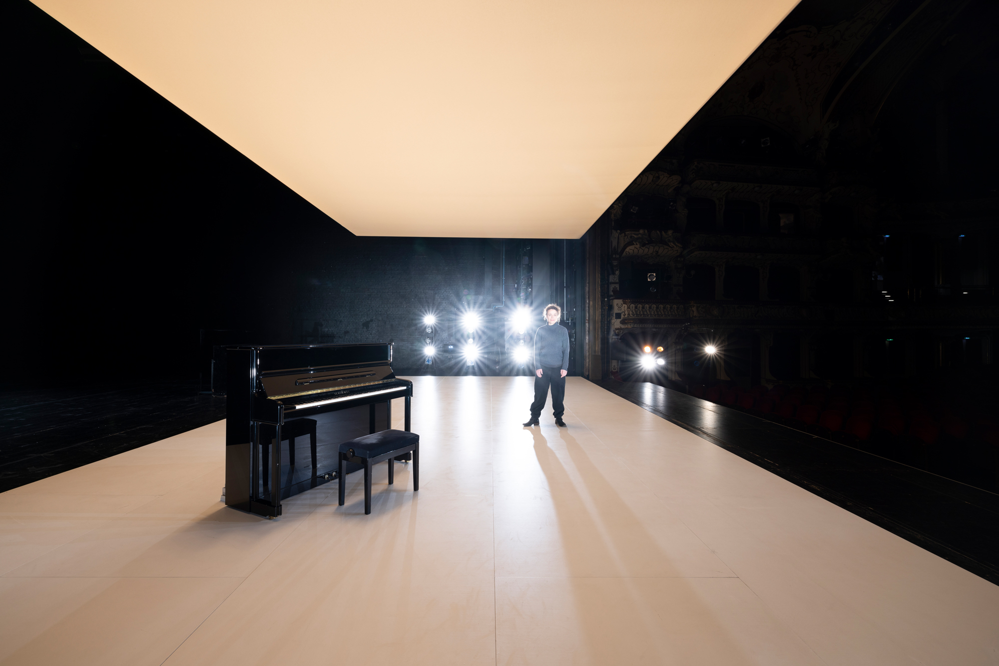

Basically, there is a deliberate dramaturgical tension between the light of the plafonds (HMI and LED in the daylight spectrum) and the light for the performers, which is primarily provided by alley light (PAR64 spotlights unfiltered or filtered with Lee 201). The color temperature of the PAR64 fixtures is 3200 Kelvin maximum unfiltered, that of the ARRI Compact 4kw is 5600/6000 Kelvin and that of the SkyPanels varies between 5600 and 10000 Kelvin depending on the scene.
Therefore, it is possible to produce an approximately similar color temperature with the PARs filtered in Lee 201 and the SkyPanels / the ARRI Compact 4kw . The figure on stage is in a uniform white light space, which is experienced by the audience as cool and rather objective.
The further the color temperatures drift apart between the sidelight and the plafond, the greater the perceived arc of tension. The bright white ceiling and the white floor of the platform appear in clear contrast to the players, who are illuminated in warm white. Annette ter Meulen explains: “The perceptible difference between the light that illuminates the actors and the light that describes the space opens up the possibility for viewers to connect the content of the narrative with their own emotional interpretation.”
In one of the last scenes, the plafond takes on the color temperature of the unfiltered, dimmed pars (2700° Kelvin) and the sidelight here is in the higher, cool-white color temperature range.

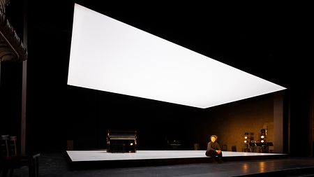

Image-4
Stage illuminated by SkyPanels in the higher, cool-white color temperature range with approx. 7600K°.

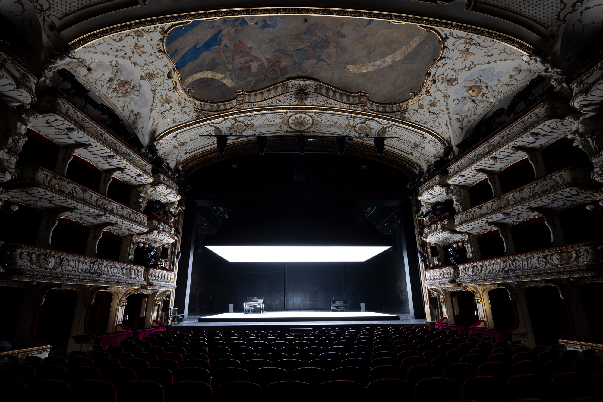

The Deutsches Schauspielhaus has 28 S60-Cs and 5 S30-Cs in its repertoire, which can be variably suspended or partially built into stage sets or used along on the floor.
The Deutsches Schauspielhaus in Hamburg is a repertory theater, which means every evening a different performance from their repertoire is played. Parallel to this, during the day there are always rehearsals for the play that will premiere next. Therefore, it must be possible to change the stage set and lighting very quickly. SkyPanel S120-Cs are permanently mounted under the theater’s portal bridge. They are very suitable since they produce enough bright working light for technical conversions and they are useful for stage lighting designers when diffused light is wanted.
