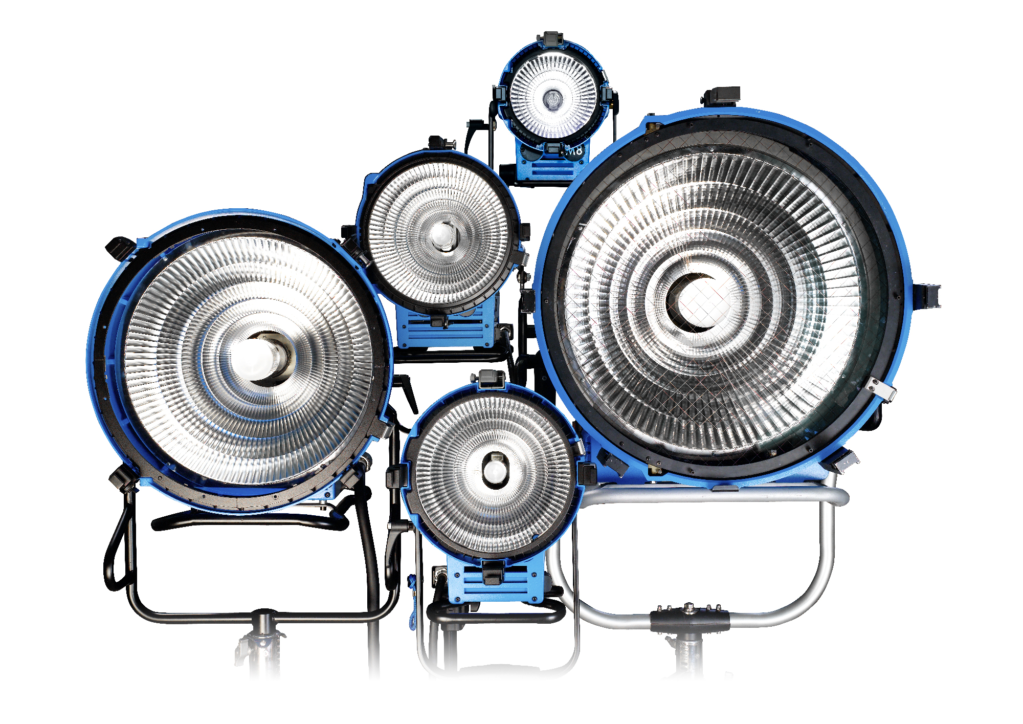

I used one M90 for a backlight and another to light from the front. Then I used an M40 as a hard kicker from the side and an M18 for details with the goalkeeper and the puck. These M-Series lampheads allowed me to react quickly if we needed more or less light, but also if we needed it to be harder or softer. The output range is extremely wide, so I was always able to give the director more when he wanted to increase the frame rate. Also we could change the bulbs to vary the output, for example the M90 can be 6 kW or 9 kW.

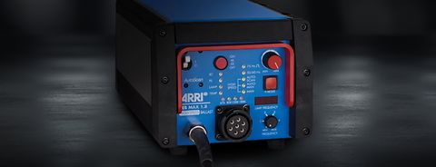

Yes, they did. We were using the older high-speed series, but also the new ARRI AutoScan ballasts. The great advantage is that you can really focus on getting the lighting right, and let the ballasts determine the correct frequency for you.

At my rental house we have the M8, M18, M40, M90, and ARRIMAX, and we use all of them. The M-Series is the best choice for high-speed shoots, but the flexibility of these lamps allows me to use them for all kinds of different situations on different sets. You can use them close or far away, hard or soft, and the light quality is always great.
The M18 is a real all-purpose weapon and I have it on every shoot; it’s compact and you can use it with domestic power instead of a generator, but it has enough output for a Chimera. The M40 can be used with a 2.5 kW bulb if you have limited power on set, while the M90 is great when you’re outside, fighting with the sun, or when you need to punch daylight into an interior. On this shoot the M-Series gave us exactly what we needed, with great pictures, no flicker problems, and really versatile light output.
