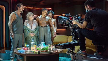

I know from experience that Jean-Pierre likes to have warm tones in the image. He didn’t want to make a film with the usual cold colors of science fiction. For the lighting, we had the ceiling as a basis, lit by 93 SkyPanel S60s, and, with Aline Bonetto, we integrated a lot of other LEDs in the set, whether they were LED ribbons or flexible plates. This allowed me to structure the backgrounds. Then, to avoid being monochrome, I played with the color of these different sources: green, blue, yellow, fuchsia, etc. Any excuse was good for me to create color contrasts in the image. A week before the start of the shoot, Jean-Pierre and I conducted tests with the actors in costume and on set, in order to work in detail on the tints, the lights, and to create predefined atmospheres. All the LEDs, including the SkyPanels and the game lights, were adjustable from a console. It was great! I could control everything remotely and see the results right away. It was very intuitive. It freed up a lot of creativity for me and Jean-Pierre.

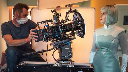

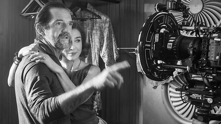

Why did you choose the ALEXA LF and the ALEXA Mini LF to shoot “Bigbug”?
I wanted to shoot the film in large format. At first I thought about using the ALEXA 65, but Jean-Pierre Jeunet likes to shoot in short focal length, with the actors in the foreground and a lot of depth of field. Since I only shoot with ALEXA, I chose to work with the ALEXA LF. On set, we had an ALEXA LF on a dolly and an ALEXA Mini LF on Steadicam, with Geoffroy Saint-Hilaire operating. We used both camera bodies interchangeably. For me, the ALEXA LF is a direct continuation of the classic ALEXA. It brings a real comfort of work when we are in the frame and it offers many accessory options. As far as the image is concerned, if I want to get information in the dark, there is clearly only the ALEXA. Not to mention its soft rendering and wide exposure latitude. All this is found in the ALEXA LF. Moreover, working in large format allowed me to gain focal length ratios. Most of the time, Jean-Pierre Jeunet works with 18 or 21 mm in S-35 mm, never with long focal lengths. A large part of “Bigbug” is shot at 25 mm, but thanks to the large format of the ALEXA LF, it looks like 16 mm, but without any distortion. It was the perfect camera for “Bigbug.”

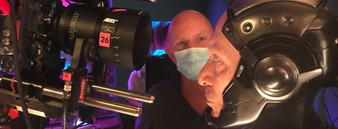

For me, the ARRI Signature Primes are a direct continuation of the Master Prime, but adapted to 4K. They are very sharp and it is the kind of image that Jean-Pierre Jeunet likes in his films. I did some testing though. I compared the ARRI Signature Primes with other large format lenses. The ARRI series was the only one to be perfectly sharp and to offer me the best minimum point. I shot “Bigbug” with a 5.6 or 8 stop to get the maximum depth of field while having the characters in focus in the foreground. To gain an extra stop, I exposed the ALEXA LF at 2000 ASA.

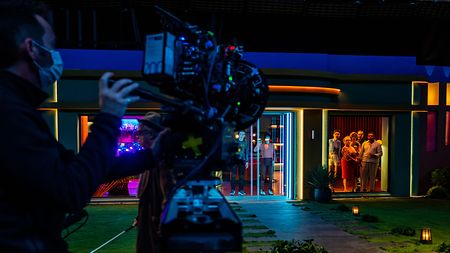

You have to understand that on “Bigbug” the story unfolds continuously over 28 hours. We go from morning light to afternoon, then to early evening and night, finishing at dawn. The challenge for Thomas was to bring this closed-door setting to life, so that the viewer could see time passing. For the exterior of the house, we installed two HMI 18K ARRIMAX on a bridge that we could roll wherever we wanted. This gave us daytime sun on the street and the garden. We also had an ARRIMAX 18K that brought the light into the living room. Also outside the house, I set up a large 30 m x 2.2 m softbox, with sixteen SkyPanel S60s and nine Lux LEDs. We also had three SkyPanel S360s on an overhead crane that were moved from right to left depending on the time of day, in addition to the intensity settings. Finally, we built a huge softbox of 30 m x 14 m, with 22 SkyPanels in shower and double diffusion to get the hyper soft light of the dawn.
