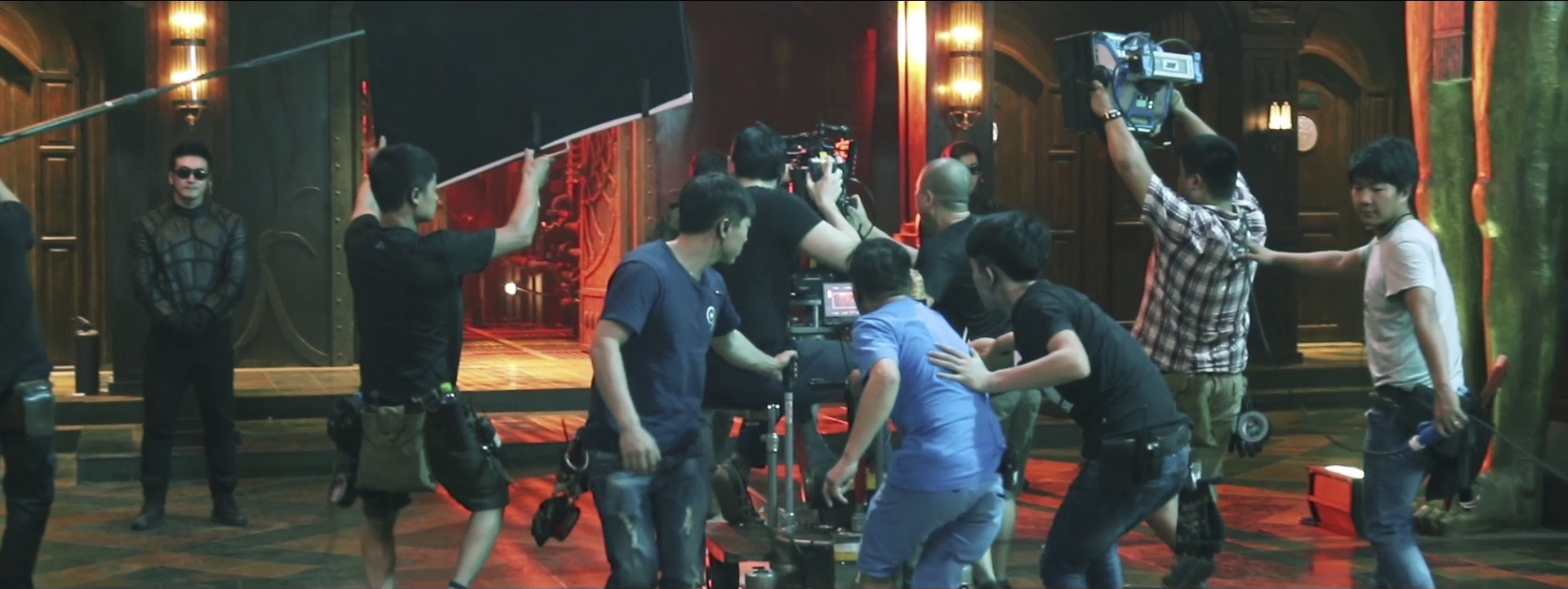

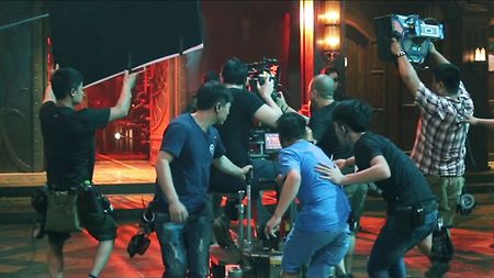

Tell us more about the main scene that features the battle ground? How was it lit?
We spent 5 months shooting ANIMAL WORLD, and about 90 percent of the shoot was done in studio. It was a sci-fi oriented story, so shooting in studio was the easiest way to fulfill the director’s wildest dreams. The main scene was very large and the director required the possibility of switching up to 90 fps at any time, so the gaffer’s work was bigger than usual.
We used a lot of 18Ks throughout shooting and utilized some smoke. Together with a few light beams we tried to create various lit areas. It would have been a huge task to set the lights for the whole scene, so we placed light beams in the most remote areas of the studio. Sometimes the director would go from 24 frames to 90, so that involved moving some of our lights. Most ambient light was controlled by DMX; some lights in the ship were stage lights, but most of the lights were SkyPanel S60s and S30s. We’ve rented almost every S60 and S30 that we could find. All the lights above the table were S60s; we used S30 for smaller areas. We used at least 60 S60s from a total of 4 or 5 rental houses.
