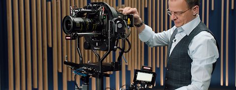

April 12, 2023; Munich – ARRI announces two new products that make its TRINITY and ARTEMIS stabilizers even more suitable for live, multi-camera broadcasting: the Tally System Gen.2 and Camera Control Panel CCP Live.
Offered by ARRI’s well-established Camera Stabilizer Systems (CSS) division, ARTEMIS and TRINITY are used not just on movies and TV series, but also on live sports broadcasts, talk shows, game shows, and events. For both studio settings and outside broadcasts where cameras are controlled from OB trucks, ARRI stabilizers allow uniquely dynamic camerawork on live productions.
The ARRI Tally System Gen.2 brings tally workflows into the digital era, while the ARRI Camera Control Panel CCP Live gives operators an extra monitor output and tally interface. Both new products are compatible with current and former generations of ARTEMIS and TRINITY, whether used as part of the ARRI Multicam System or third-party multi-camera setups.

When used in live, multi-camera environments, ARTEMIS and TRINITY need a tally system, just like regular broadcast cameras, to let operators behind the camera and presenters or performers in front of it know which camera is broadcasting live. This is achieved with a small red LED light that turns on and off according to whether the camera signal is broadcasting or not.
The ARRI Tally System Gen.2 consists of two components: the host module, which is normally mounted beneath the lens and is visible to the talent; and the client module, which is mounted on top of the camera operator’s monitor. A tally trigger is required to turn on the red light of the host module, which in turn then instantaneously turns on the red light of the client module.
Versatility is a key feature of the Tally System Gen.2 because it works with three different trigger technologies. The first is the classic trigger, whereby a photocell detects the onboard tally LED on the camera; the second is to plug a special cable into the camera so it can communicate directly with the tally module; the third is to trigger from the new ARRI CCP Live when using ALEXA Mini, AMIRA, or AMIRA Live cameras as part of the ARRI Multicam System. And since the system is digital, it will adapt to future trigger technologies.
Previous analog tally systems were dependent on the brightness of the LED light on the camera, which was variable and could degrade with age. Different cameras in a multi-camera setup might therefore display tally lights of different brightness levels, which is potentially confusing for the operator and the talent. The Tally System Gen.2 overcomes this issue by providing a completely consistent level of brightness, regardless of any variability between the cameras.
