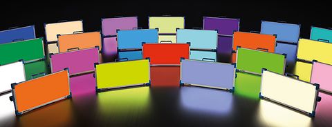

Rosco/Lee Gel Libraries
Already able to create a vast number of colors, the SkyPanel with Firmware 2.0, can now emulate a wide variety of well-known lighting gels. The SkyPanel’s calibrated light engine reproduces color filters more accurately than a lighting console and enables users to select familiar gels in seconds via the on-board controls or through a new DMX protocol. SkyPanel gel libraries comprise Rosco and Lee filter categories that include color corrections, party colors, Rosco CalColor, Storaro Selection and many more.
