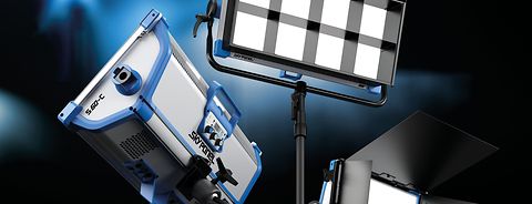

SkyPanel Accessories AN cover
New Accessories for the SkyPanel Family of LED Soft Lights
(IBC, Amsterdam) – SkyPanel is a versatile family of compact and fully tuneable LED soft lights, introduced at NAB this year and shipping in September 2015 as promised. The S60 is the mid-range model, while the S30 is smaller and more portable; both are available in fully color controllable (C) and remote phosphor (RP) versions. New accessories now greatly enhance the light controllability, mounting options, portability and application possibilities of these groundbreaking LED lights.

Barndoors
The rugged and lightweight 4-leaf barndoor for the SkyPanel S60 and S30 allows light spill to be diminished and the beam spread to be broadly controlled.
Honeycombs
The Honeycomb 60° and Honeycomb 30° for the SkyPanel S60 and S30 control the light and reduce spill by restricting the beam angle; the honeycomb structure also helps to reduce the multiple shadows that typical square louvers would create.
Eggcrates
The 8-Chamber Eggcrate S60 and 4-Chamber Eggcrate S30 make the light more directional in the same way as the Honeycombs, but reduce the beam spread to only 60° and allow more light through, due to the individual cells being larger and deeper.
Snoots
These straight-wall snoots for the SkyPanel S60 and S30 feature a single chamber that reduces spill and allows the light to be directed towards a more defined location.
