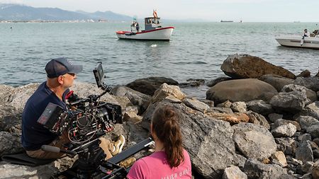

The ALEXA Mini LF is my favorite camera for so many reasons. I love the sensor, the dynamic range, color rendition, the speed, and also the small form factor. Even before large format was around, I tended to use slightly wider lenses and go physically closer to subjects. I just love including more of the environment around characters in my shots and not shutting it out by being too flat or using long focal lengths. With large format’s shallower depth of field, I can do both: soft and creamy backgrounds, yet a greater sense of the space, sets, and locations. I also love the reliability of ARRI products. I can trust the camera and I know what I will get, no matter how crazy the schedule or how tricky the setup.

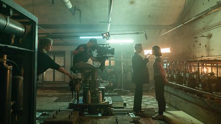

ARRI_Der Gejagte_Ralph Kaechele_The Hunted-In the Camorras Net_ALEXA Mini LF-7

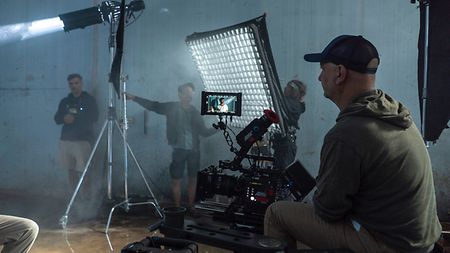

DP Ralph Kaechele BVK (at camera) blended dirty green light with warmer orange tones at this industrial location.

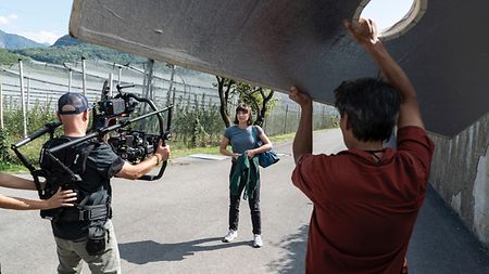

Kaechele operating another handheld setup with the Mini LF, combining the Ronin 2 with a Ready Rig.

We considered using two camera bodies because of the time savings of building the camera in studio, handheld, or gimbal mode, but my excellent 1st AC Christian Temme assured me that he could build out the camera in a way that would take minimal time to switch between different configurations. That way we could work with just one camera, which helped us stay within the budget constraints.

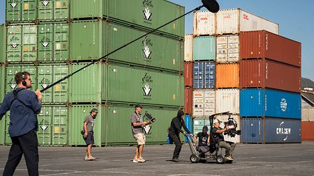

ARRI_Der Gejagte_Ralph Kaechele_The Hunted-In the Camorras Net_ALEXA Mini LF-13

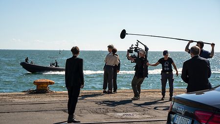

Shooting on location at a port in Northern Italy.

Given the overall desaturation we wanted, I thought it was important to give each scene a special color and tone. Otherwise, the film would feel bleak and grey. I love giving a location or scene a certain identity, cutting from an orange scene to a blue scene, to a green scene, and so on. This compensates for the lack of color through desaturation. I also love blending colors so that they are broken or dirty. This is apparent in the stand-off scenes between the mafia leader and the protagonist’s daughter in a rundown industrial hideout. I used dirty green tones and blended them with warmer orange and sodium colors. I often have several lights with slight variations of the same color close to each other because it looks less clean and less like studio lighting. The ALEXA Mini LF picks up all the nuances and always surprises me with its incredibly smooth tones and wonderfully rendered colors.

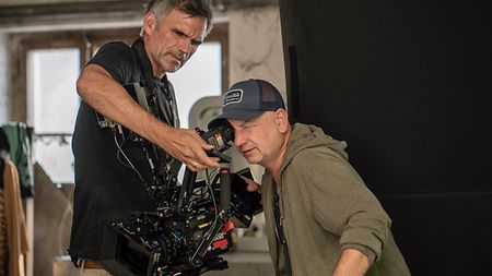

Checking a composition through the ARRI MVF-2 viewfinder with the help of 1st AC Christian Temme.
