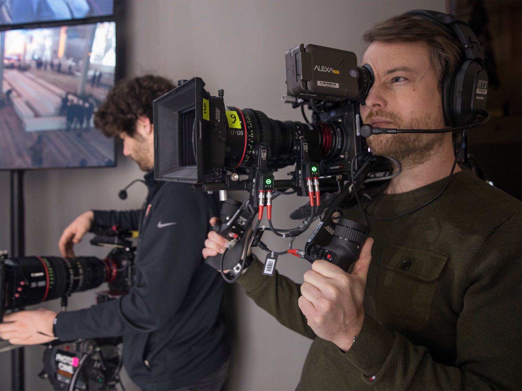

Our customers want to have an ARRI image. They are used to shooting their commercials and promotional films with ALEXAs, and they want the same quality, the same look, on the coverage of their shows because those are central elements of their communication. For the past three years we have been using AMIRA because it has the same sensor as the ALEXA Mini, and practically the same functionality. In fact, the two products are often mixed on a fashion show. The cameras on tripods—equipped with long focal lengths—are AMIRAs, while the ALEXA Minis are used on cranes, handheld, or with Steadicams.
How many cameras do you normally use on a fashion show?
For very large fashion shows, this can mount up to 18 cameras, but the average show has between 8 and 10 cameras. These productions require cinema lenses, like the Angénieux zooms which are not motorized. We add cmotion motors and control them with Master Grips. The idea is to adapt cameras to the multicam environment and get the best of both worlds.

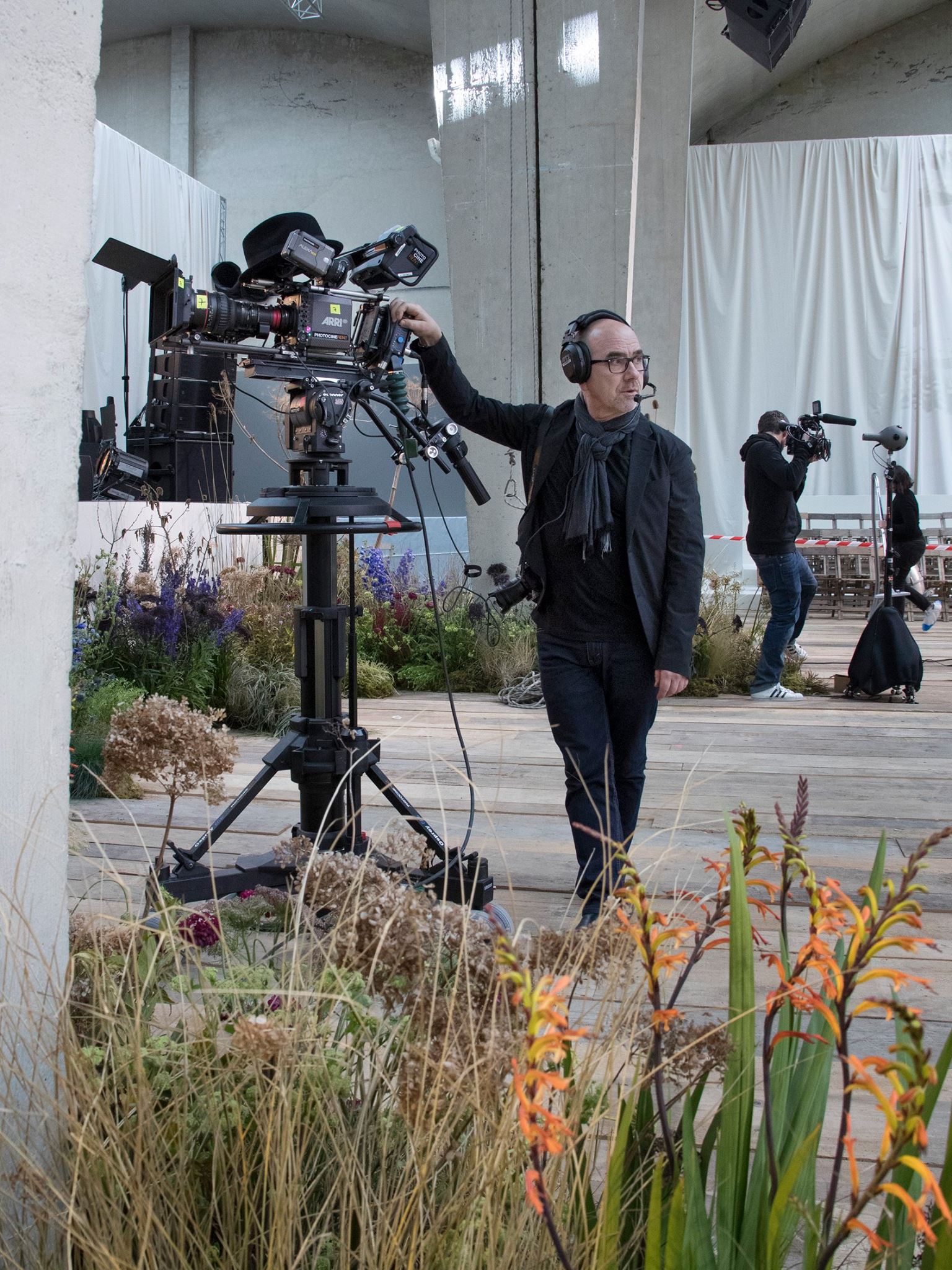

Very rarely. We bring the equipment and the technicians who install the mobile production flight pack, the cameras and who will wire everything. Usually the production supplies the camera operators and director. There is also a video engineer who has an important role that controls all the remote cameras to create image homogeneity, adjusting the iris, color or adding an ND filter remotely. We also sometimes work abroad, in London or Italy. Recently, we did the COS fashion show of the H&M group in Florence. We work regularly with them in Europe.
How are the AMIRAs and the ALEXA Minis connected with the mobile production flight pack?
We deploy the Ereca and Multidyne fiber optic system between the cameras and the mobile production flight pack. All the remotely controlled parts of the AMIRAs go through the fiber: video, audio, energy, time code, data and genlock. We use wireless with the ALEXA Minis on Steadicam or Cablecam because we have no other choice. But we avoid wireless as much as possible, because in live events there are signals flying in all directions which brings the risk of interference.
