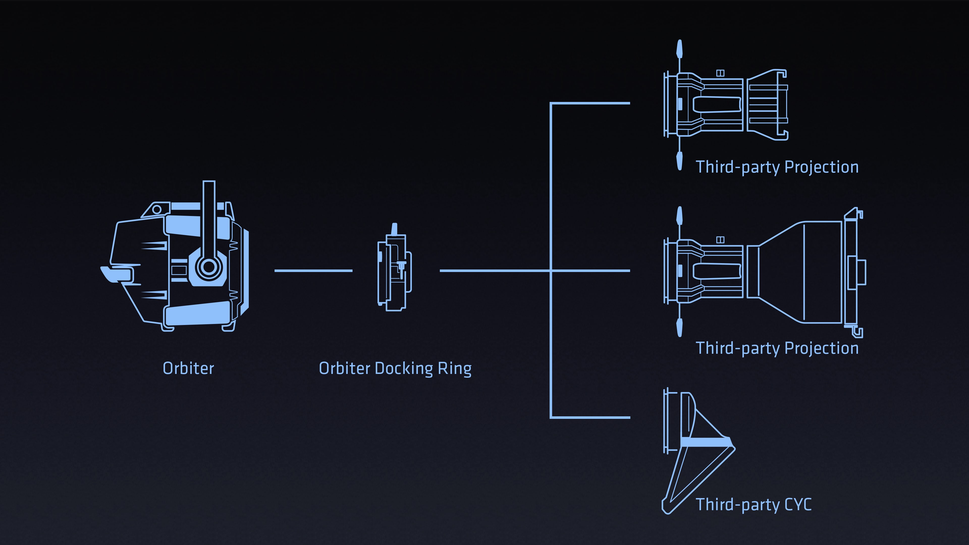

Any third-party Projection optic, Fresnel and Cyc-optic with the size between ⌀134 mm / 5.3 in and ⌀ 161,35 mm / 6.3 in and the max. weight of 7,9 kg / 17,4 lbs. can be applied to the Orbiter Docking Ring. The user manual contains a drawing of the adapter mount and further information.
The max. weight which can be applied to the Orbiter Docking Ring is 7.9 kg / 17.4 lbs.
Your ARRI Sales representative will be happy to give you a demo – live or on remote. Please contact your local dealer at www.arri.com/en/contact to see, when they have the Orbiter Docking Ring in stock.
No, there is no need to use the Orbiter Docking Ring when applying other ARRI optics. They can be attached directly to the fixture due to Orbiter’s Quick Lighting Mount (QLM).
The Orbiter Docking Ring will be available in black only, however it can be attached to any Orbiter color version.
The Docking Ring requires minimum LiOS Version 1.4 to be installed.
The Orbiter Docking Ring is not a standardized Bowen Mount.
The Orbiter Docking Ring mounts effortlessly onto the Quick Lighting Mount (QLM) of every Orbiter. The Docking Ring is automatically recognized by the luminaire and adjusts the light output for ultimate performance. Attaching third-party optics can also be done simply and swiftly without any tools required. The operation of third-party optics is safe due to the built-in automatic and low-noise cooling fan.
Yes, it is mandatory to switch off the Orbiter before mounting the Docking Ring with the third-party optic.
