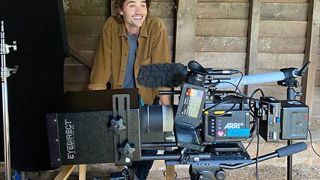

What led you to large format, and to the ALEXA Mini LF?
As a DP, around 70% of my work is commercials and 30% is documentaries, and for commercials I shoot on ALEXA exclusively when I'm not shooting analog. I really like what the ALEXA does with colors; I know how to work with ALEXA and how to expose the sensor, so for me that choice was clear from the start.
For this project we wanted to have 4K and to be as close to the characters as Covid rules allowed, shooting handheld with wide-angle lenses for a sense of physical intimacy. This led us to large format and to the ALEXA Mini LF. Usually we used lenses between 24 mm and 35 mm, and the LF sensor looks really cool at those focal lengths because of the shallow depth field. When we shot huge landscapes, the LF sensor somehow made them even more epic.

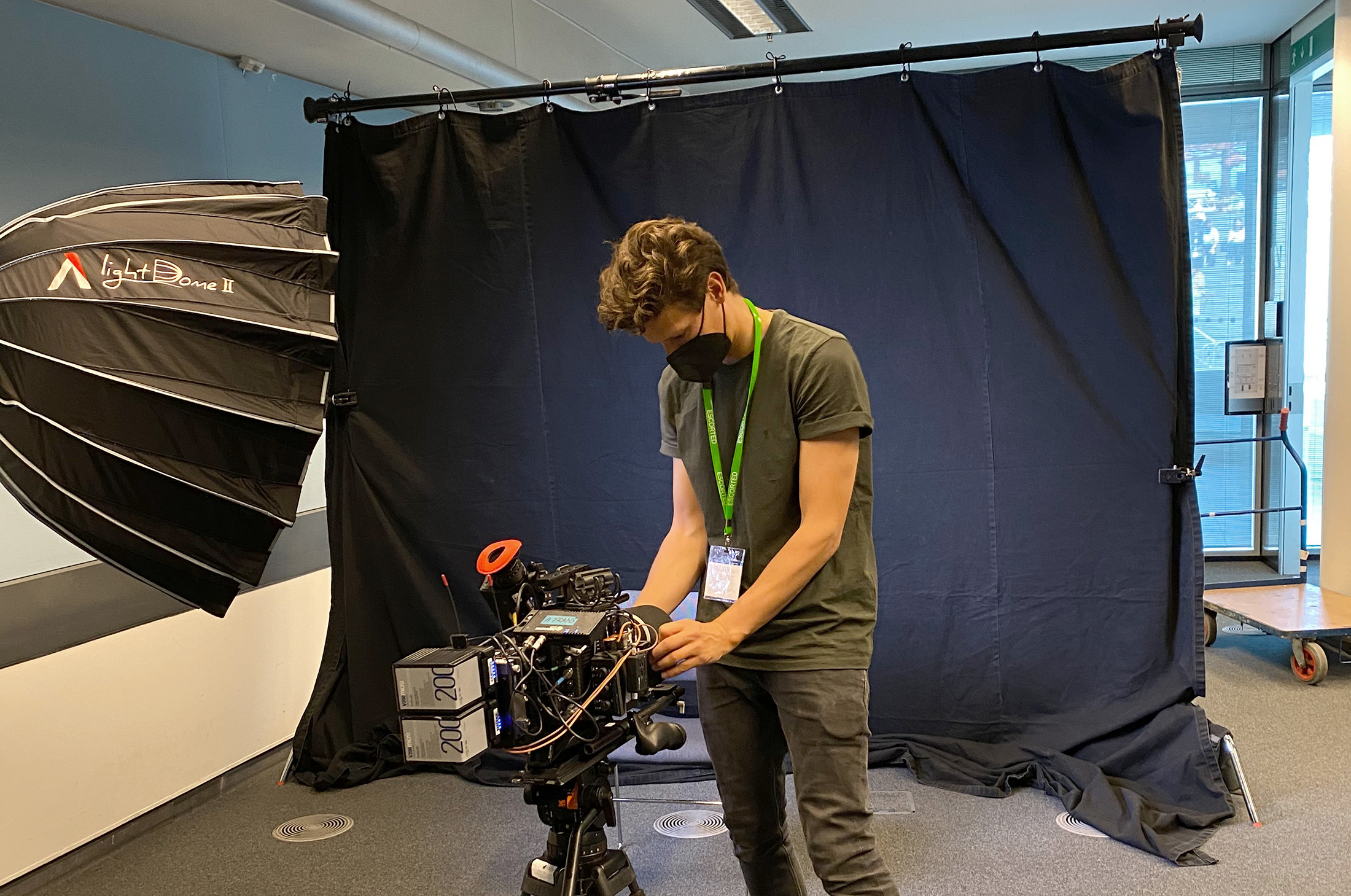

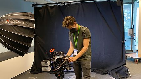

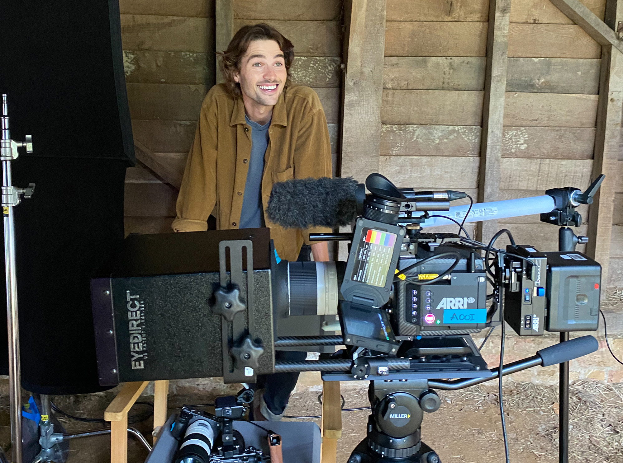

The most obvious and detailed thing was how to set up, frame, and light the interviews. Throughout the show, we interviewed people in front of a black backdrop, so it was important that the backdrop and lighting were the same for everyone, whether they were a scientist with 30 years of climate experience or a farmer who realized two years ago that his crop isn’t growing anymore. I did detailed tests and was very specific in my briefing about light sources, distances, exposure, and contrast ratios.

I had a camera assistant, but he was also a production assistant. We were such a small crew that he had to help with other stuff. Focus wise, I was managing the camera on my own. He helped me with batteries and changing lenses, but in terms of the camera setup, I needed to be self-reliant. The ARRI Master Grips came in handy; I had a cforce motor on the lenses and I used the Master Grips to control focus and dial-in the iris. That's also why I chose Canon EF lenses, because they're quite small and I can carry two or three in my backpack.
It was easy to pull and track my focus with the MVF-2 viewfinder on the Mini LF, because it's so sharp. I did use the fold-out screen for some low-angle stuff or when I was running behind someone, but mainly I love operating with the viewfinder, because you have another point of contact with your body, so you get a really stable, organic image. I can also control my camera settings through the viewfinder; when I wasn’t using the Master Grips, I put most of my user buttons on the viewfinder itself. Even stuff like changing the NDs or checking the false color was on there, so it was really nice.
