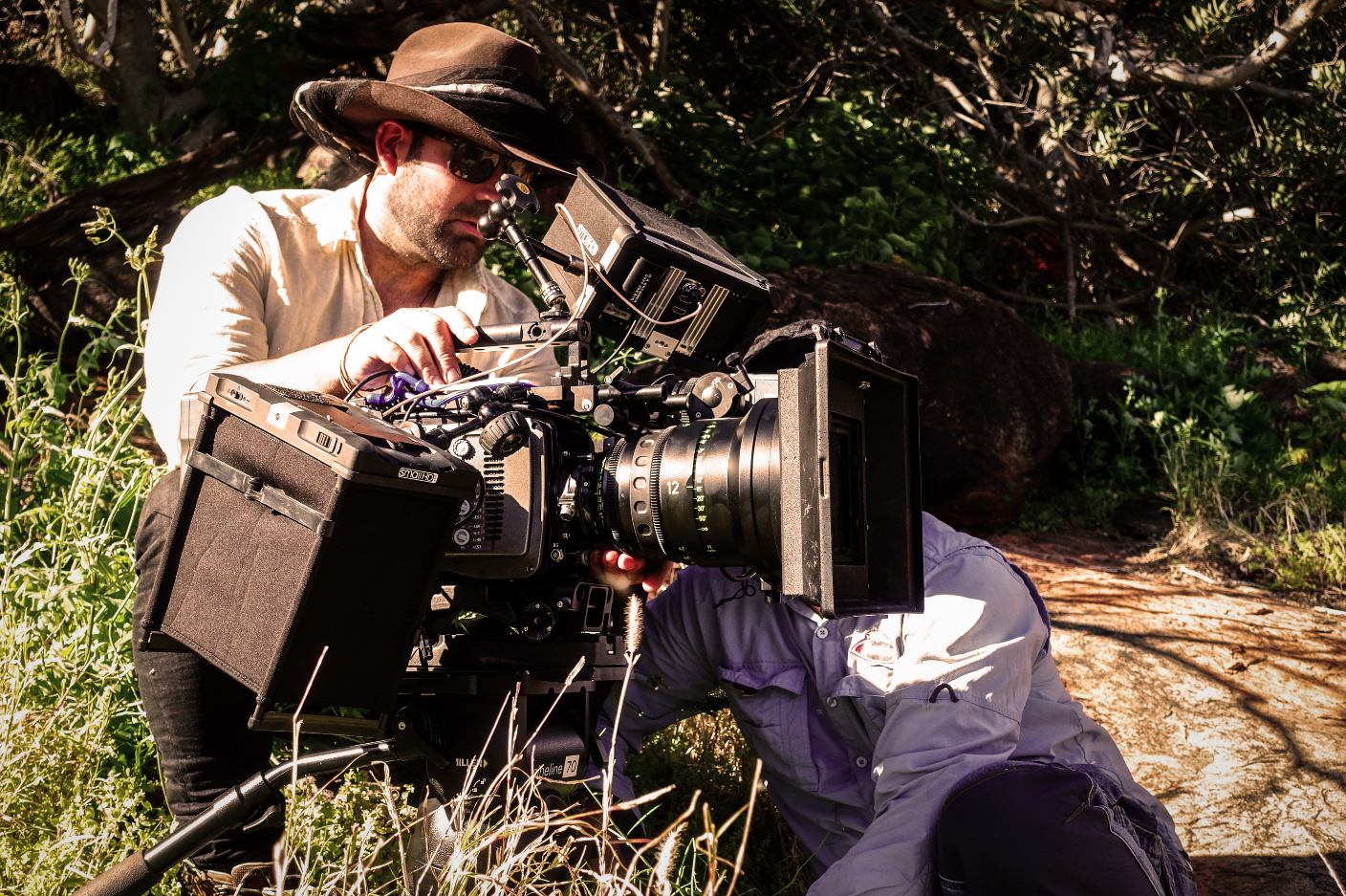

He continued, “Firstly, the camera’s reliability factor played a big part as the fact that we were shooting seven hours out of Alice Springs in such a remote and harsh environment gave us no backup should the camera fail or suffer media corruption. In other words, camera reliability was paramount – there was no plan B in case something went wrong. I had taken the AMIRA on previous long form jobs before and it has never skipped a beat, even in scorching temperatures.”
Bremner also highlighted the camera’s features and usability adding, “The AMIRA’s internal NDs are a big plus as the Australian sun is harsh and unforgiving, especially in the desert. Dust and filters are not always the best combination and keeping the filtering inside the camera was not only completely logical it was extremely practical under those exposed conditions. Some of our setups were on the side of cliffs and on uneven terrain, places where you don't want to be swapping out filters.”
The AMIRA’s form factor also played a big part in the shoot as did its power consumption and ease of use as Bremner continued, “The weight and balance of handheld solo operation with the AMIRA was excellent. Considering we were hiking and climbing to obtain shots, the camera was often carried and shot straight from the shoulder and the weight and balance of the camera was perfect for long hours in such conditions. Also, next to reliability, power was key. Along with the standard ALEXA and ALEXA Mini, the AMIRA is the best in terms of power consumption. With base camp only having generator power, every battery had to count. Finally having Chris Braga as my one and only trusted and experienced AC and such a huge scale I was often operating completely on my own and the AMIRA dominates as the doco solo op setup camera.”
