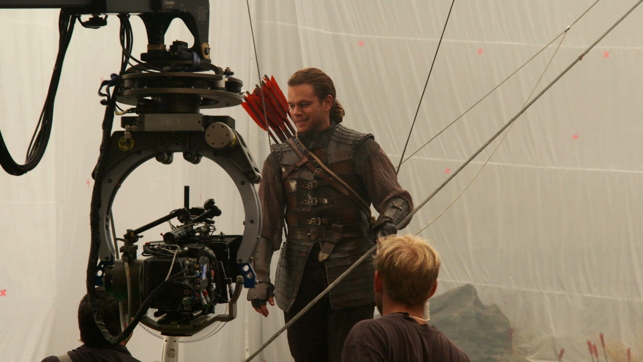

SD: We had a set of the Great Wall built in a greenscreen enclosure that was something like 300 m long and we would often put 500 extras into it. We had CableCam shots 100 m above the wall, seeing the whole thing, and you could make out every individual character, which meant that for crowd replication and all those other things that would be happening in post, you're creating the highest possible resolution image.
