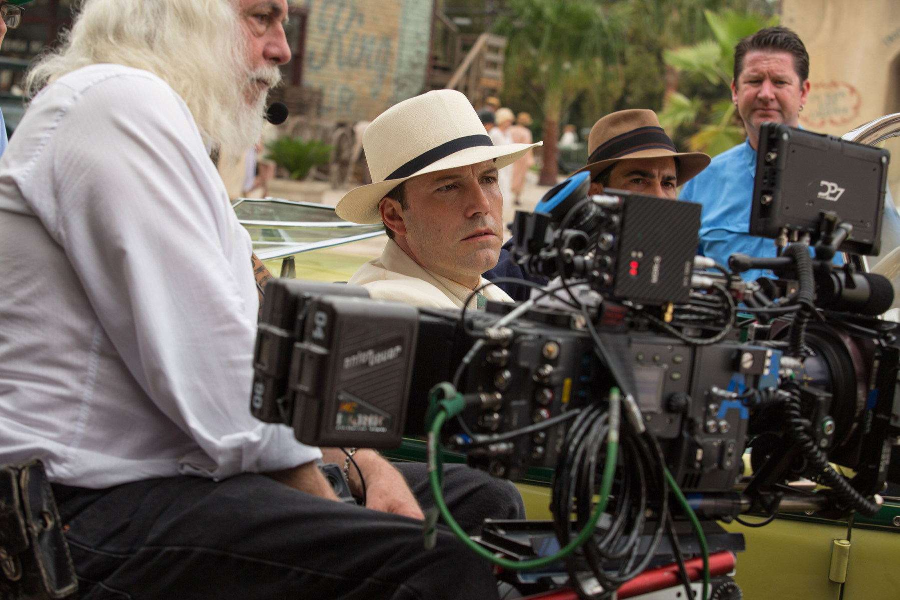

How did your crew find the camera to work with, and how straightforward was the image workflow?
 My crew found the format superb. For Trevor Loomis, who was pulling focus, there was the additional strain of less depth of field, but he is extremely talented and the focus did not suffer whatsoever. For Steadicam the rig was heavier, but again, no issue in doing the work.
 The workflow felt no different on set or in post from my perspective, beyond the obvious increase in storage, which can burden a post house. The facility needs to be very aware of the amount that will come in from the film ahead of time, so that there are no issues with playback.
