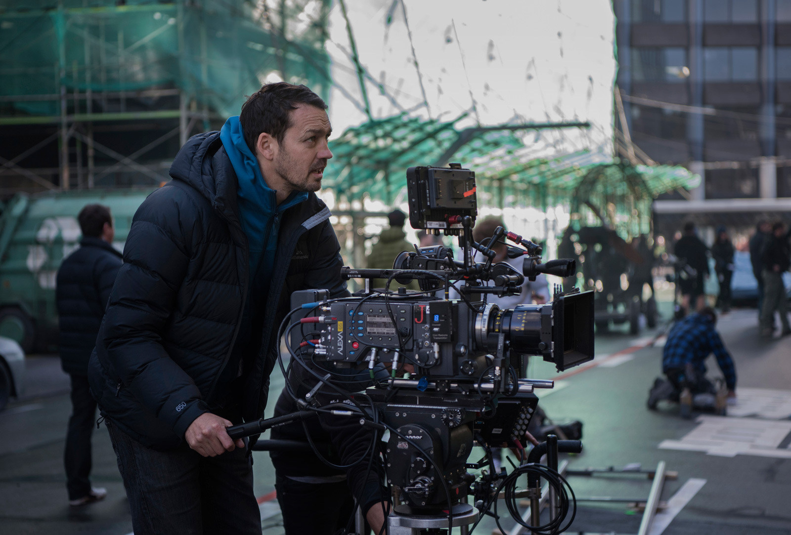

I always like to have a very small, mobile camera on set, whatever format I'm shooting, so the ALEXA Mini offered us opportunities to position and move the camera in ways we couldn't with the ALEXA 65. Because Major is part-human, part-machine and exists in a sort of third space, I had the idea of expressing that sense of existential isolation -- which is a real feature of anime -- by having the camera float through scenes like an invisible observer. We used the Mini for that, and also for what we called a 'glitch-cam', where we put two Minis side by side but slightly offset, so we could morph between the two perspectives and create a weird effect that suggests the technology is slightly failing at times. 95% of the film is ALEXA 65, though, because we just fell in love with the look.
