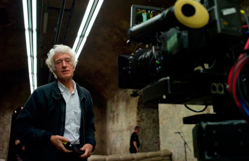

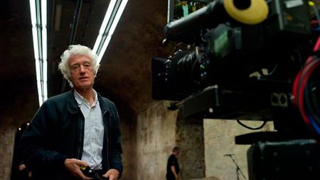

You had the first prototypes of the ALEXA Studio camera. Why was it important for you to have an optical viewfinder?
I think part of it is your history and what you've been brought up with. I just like the clarity of the image in the optical viewfinder and seeing exactly what's in front of me, because that's how I light. The most important thing to me is watching an actor's face and how the light falls on that face. You just can't do that with an electronic viewfinder -- yet. It's true that the Studio cameras we had were only prototypes but they were flawless, we didn't have any problems with them at all.
