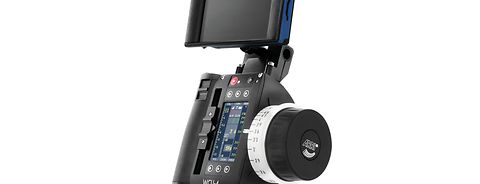

WCU-4 with Monitor Bracket and Monitor

WCU‑4 Monitor Mount
The WCU‑4 is a comfortable, versatile hand unit offering up to 3-axis lens control. Rugged and splash-proof, it features an easy-to-read lens data display, lens mapping to pre-marked focus rings, focus tracking, vibrating alerts and custom lens file programming. A new WCU‑4 Monitor Mount now allows on-board monitors to be fitted to the top of the unit.
Strong, stable and constructed from lightweight, radio-friendly materials, the monitor mount offers adjustable viewing angles and a 1/4-20 UNC mounting screw. It is optimized for the Transvideo StarliteHD5-ARRI 5” on-board monitor, but works with others as well. Having a live image feed on the hand unit will enable users to judge camera framing and make adjustments to settings such as iris and even focus, depending on the resolution of the monitor used.
