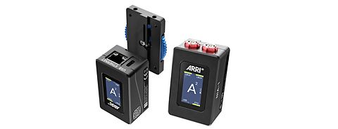

June 5, 2025; Munich – ARRI announces the Network Interface Adapter NIA-1, bridging modern IP workflows and traditional LBUS-based camera and lens control systems. By introducing Ethernet connectivity to the ARRI Electronic Control System (ECS), NIA-1 enables seamless integration, advanced remote control, and scalable multi-device configurations. ECS tools such as the Hi‑5 hand unit can now function with negligible latency over an IP network, expanding third-party camera compatibility and benefitting both cine and live productions.
Compact, powerful, and robust, the NIA-1 features LBUS, Ethernet, and USB-C connectors. The status of each connector is displayed on the touchscreen, which provides an intuitive user interface. Besides the touchscreen, the NIA-1 can also be controlled from any device in the same network via a web interface. With the NIA-1, ARRI introduces the concept of network channels—a new and simple way to configure IP networks on a film set. Users just need to set the same network channel letter designation on each connecting device, for example the letter ‘A’ for the A-camera. Connection is fast and easy, with the NIA-1 automatically managing complex network settings, although manual IP configuration is also an option when incorporating the NIA-1 into advanced networks.
The NIA-1 improves and extends control of third-party cameras from within the ARRI ecosystem, which will be of particular interest to current and prospective Hi‑5 owners. Instead of multiple specialist cables for different cameras, each with varying control limitations, the NIA-1 connects directly to the camera via a network, allowing much more comprehensive control of camera functions with ARRI ECS tools. Mounting the NIA-1 to any camera is made simple by the purpose-designed Rotary Release Adapter RRA-1, which has a quick-release dovetail interface and tough, all-metal construction.
