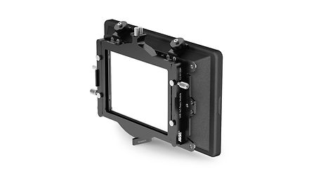

LMB 4x5 offers advanced accessory options
Advanced accessory and upgrade options for LMB 4x5

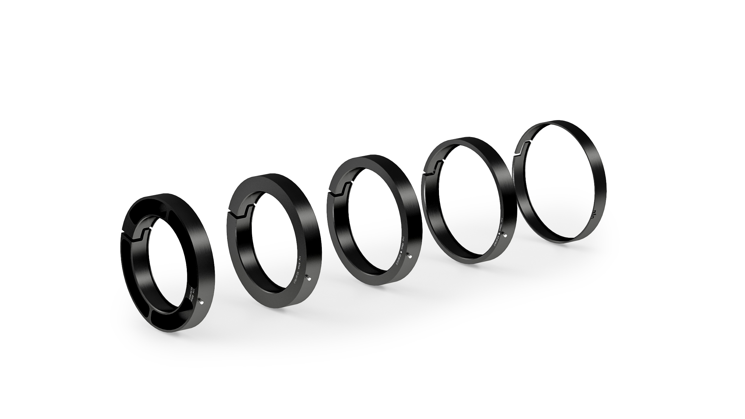

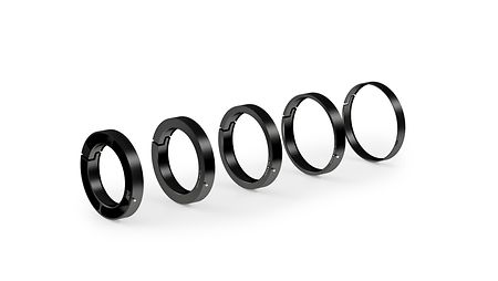

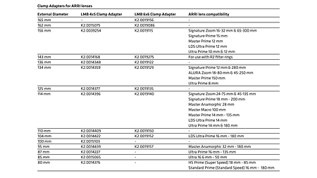

Clamp Adapters

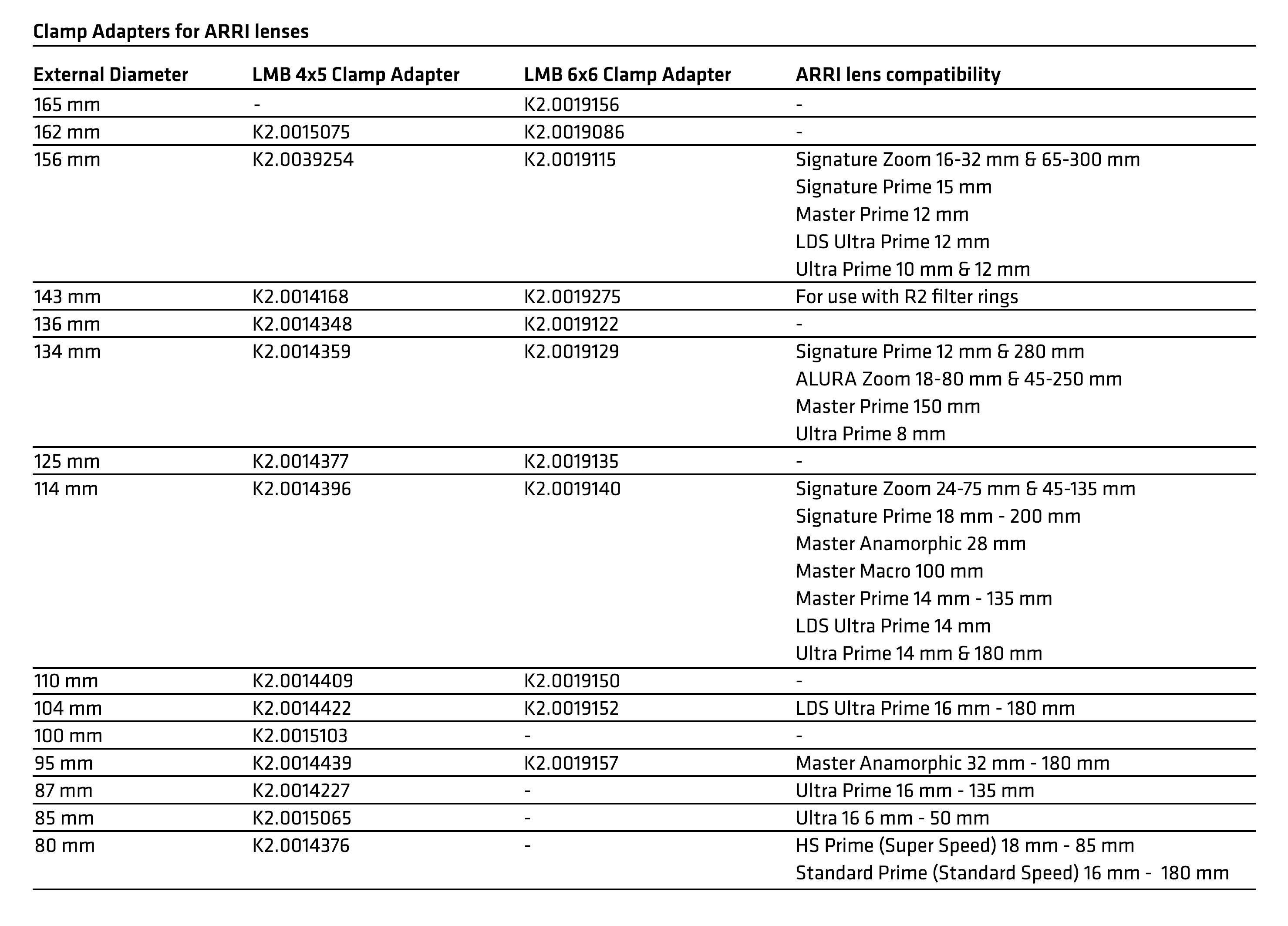

Clamp Adapters allow you to quickly mount the LMB 4x5 to any cinema lens without rods. There are 14 clamp adapters available for lenses ranging from 80 mm to 162 mm in external diameter. Any clamp adapter released for any ARRI LMB-5, LMB-15 or LMB-25 will continue to work with the latest LMB 4x5.
The following table lists the available LMB 4x5 Clamp Adapters as well as compatibility with ARRI lenses. For a comprehensive list of the front diameter of various other cine lenses, we recommend the CineD Lens Database.
Explore LMB 4x5 Clamp Adapters

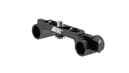

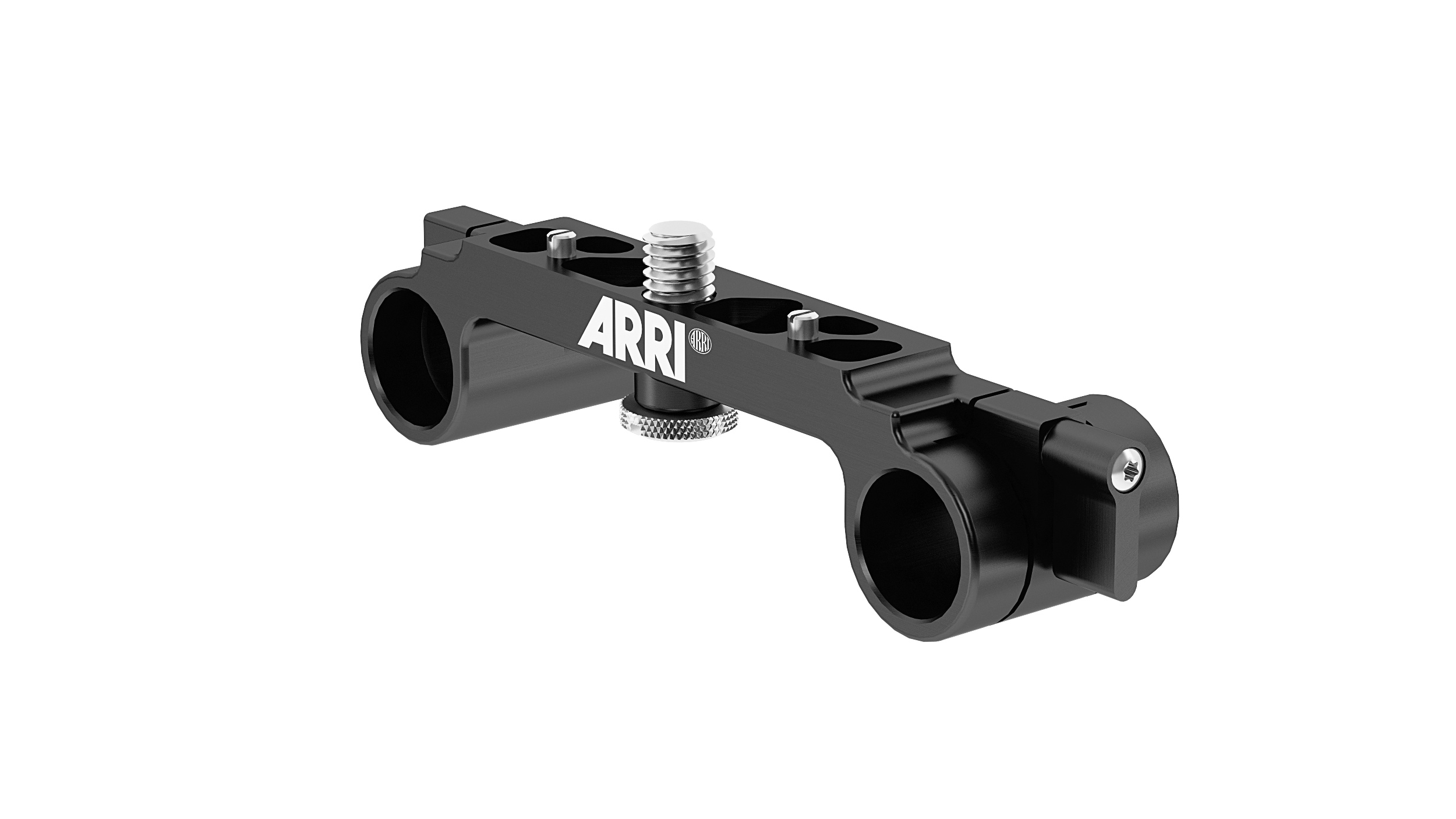

Adapters for Rod Mounting
The LMB 4x5 can be adapted to 15 mm LWS, 15 mm Studio or 19 mm Studio support rods. Both the Tilt and Flex Adapter and the 143mm Clamp Adapter connect directly to the 15mm Lightweight Support Console and can be adapted to studio standards with either 19 mm or 15mm Studio Rod Adapters.

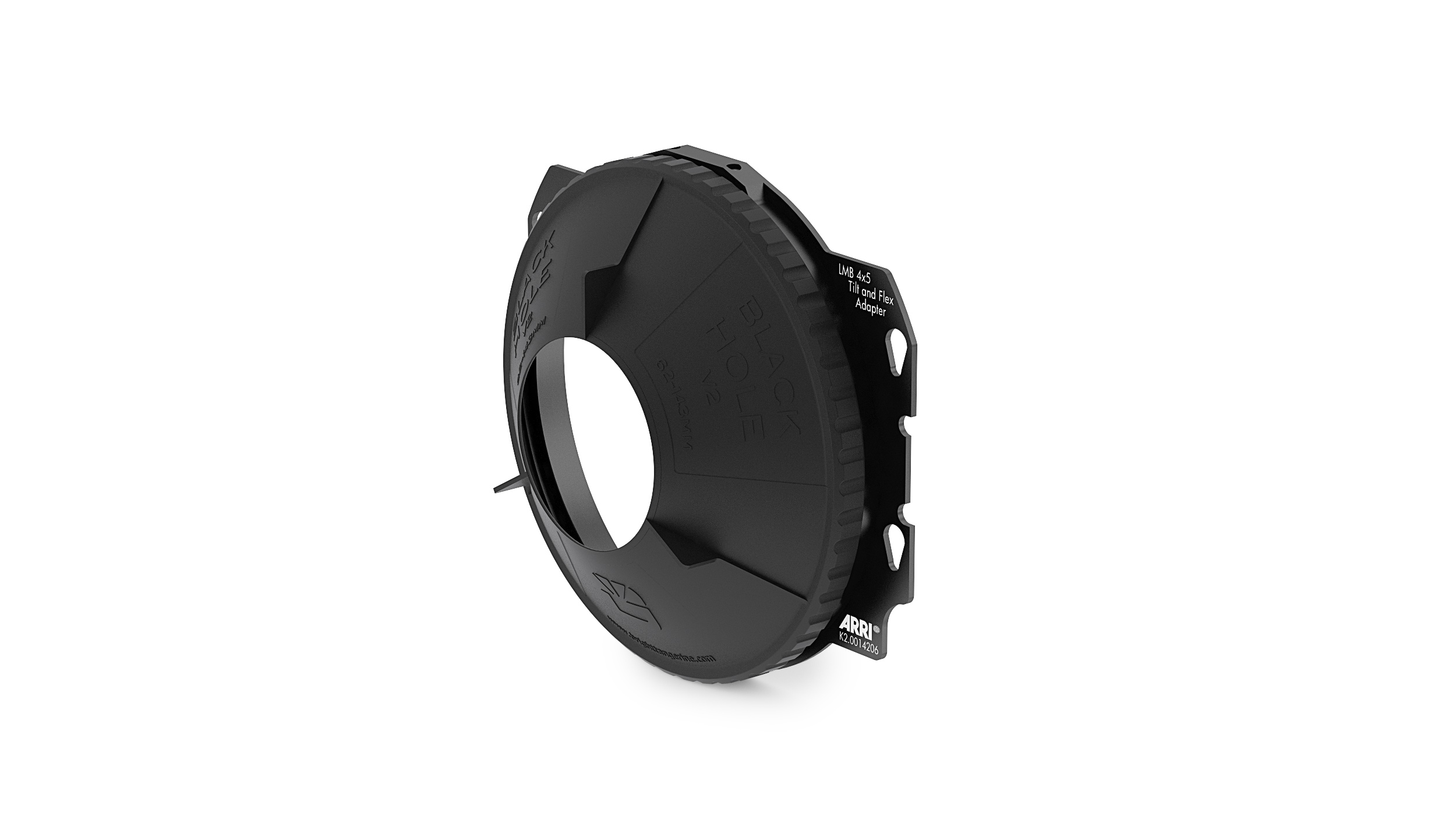

The Tilt and Flex Adapter is a flexible rubber donut useful as a one-size-fits-most solution, or for smaller lenses, or for those that telescope significantly during focus pulls. It supports lenses with an external diameter of 62 mm up to 143 mm.
For productions expecting regular lens changes, the combination of an R2 Filter Ring and Reduction Ring offers a familiar and elegant solution for mating the front of a lens to the LMB 4x5. A 143mm Clamp Adapter acts as the interface to existing R2 rings, which have the additional benefit of supporting a 138 mm filter, such as a polarizer. Users seeking to use diopters should investigate our diopter-specific accessories below, and we don’t recommend the use of other Clamp Adapters in combination with rod mounting accessories.

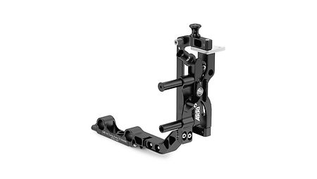

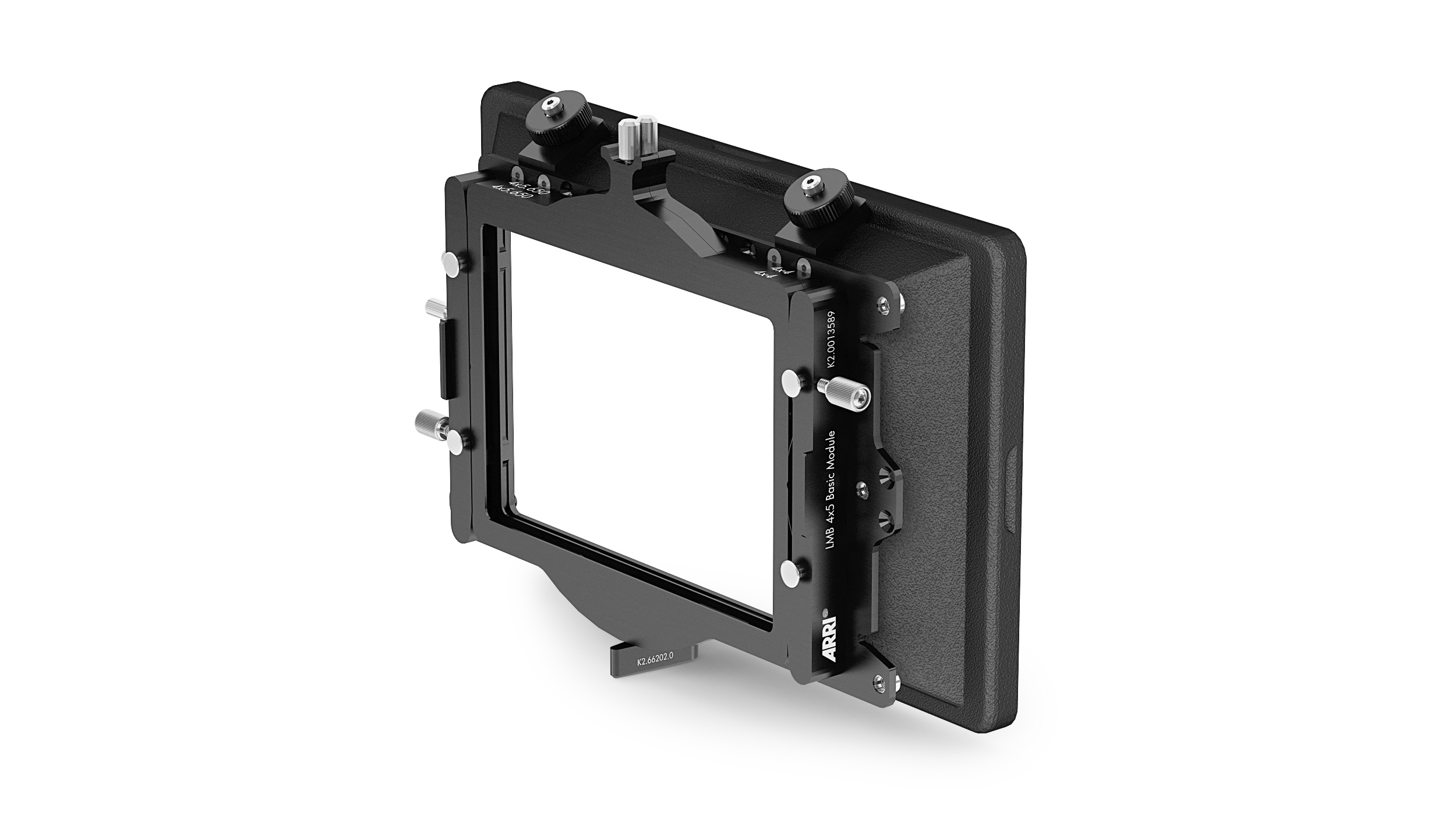

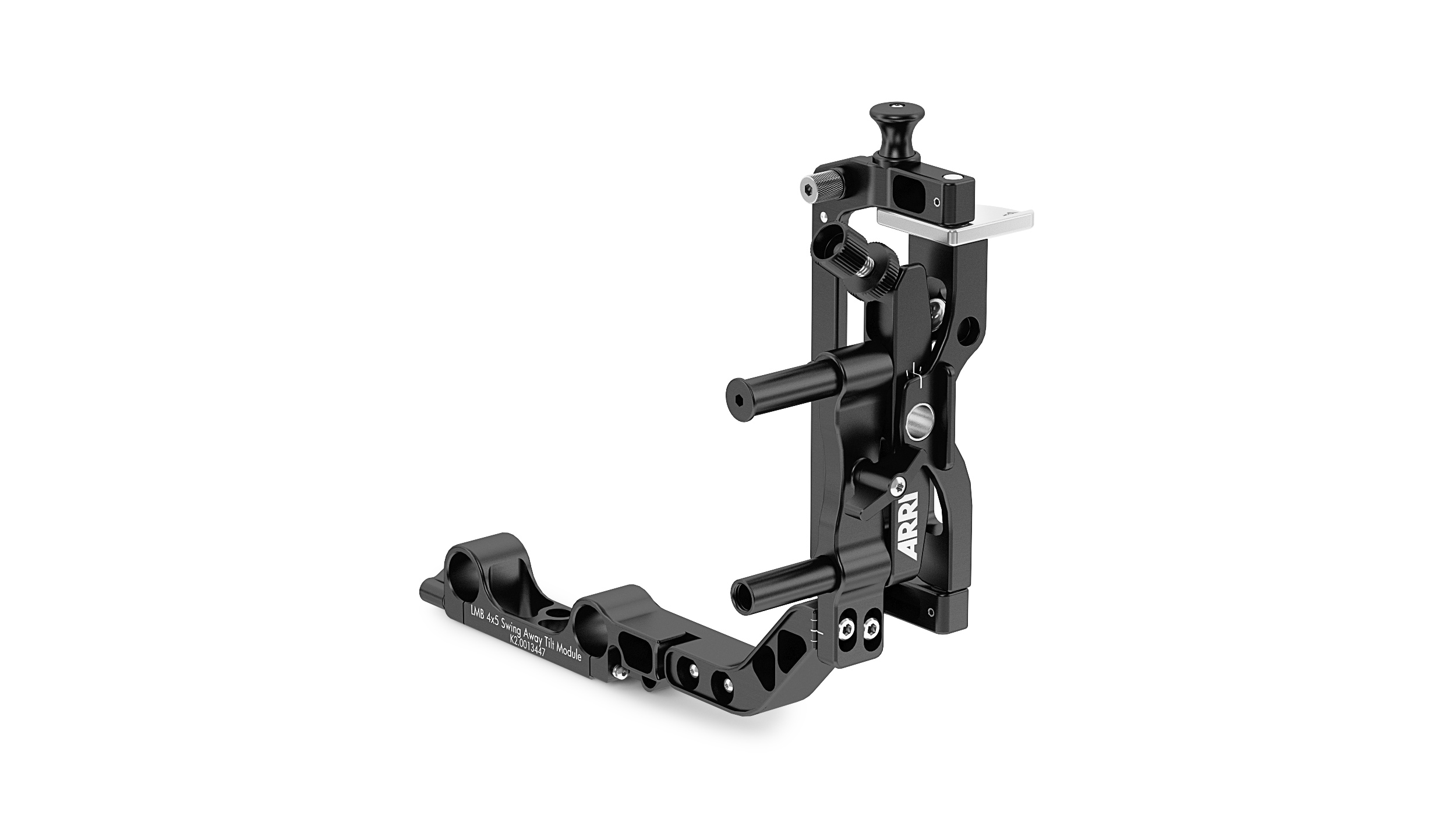

Alternatively, the innovative Swing Away Tilt Module offers the convenience of lens changes without removing the LMB 4x5 from your rig. Attached with three thumb screws, it’s simple to convert a Clamp-On LMB 4x5 to a swing away one. The integrated Tilt Module allows users to tilt their matte box to avoid unwanted reflections typically created by bright light sources such as car headlights.

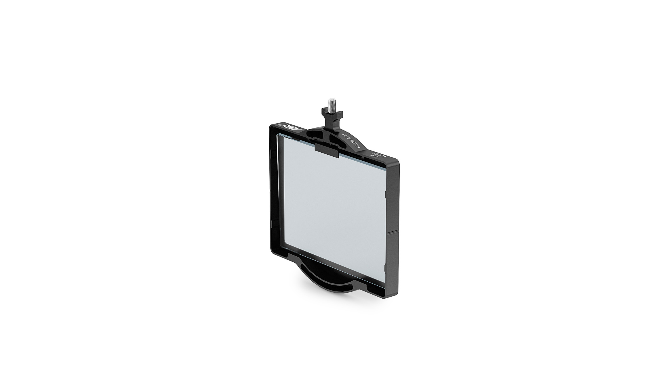

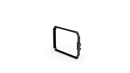

Anti-Reflection Frames
Similar in principle to the tilting component of the Swing Away Tilt Module, but supporting clamp-on configurations, the Anti-Reflection Frame can be used to angle filters to avoid internal reflections. A single filter can be fitted at an angle of 4°, or two filters can be stacked at a 1.7°.
Explore the Anti-Reflection Frames

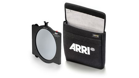

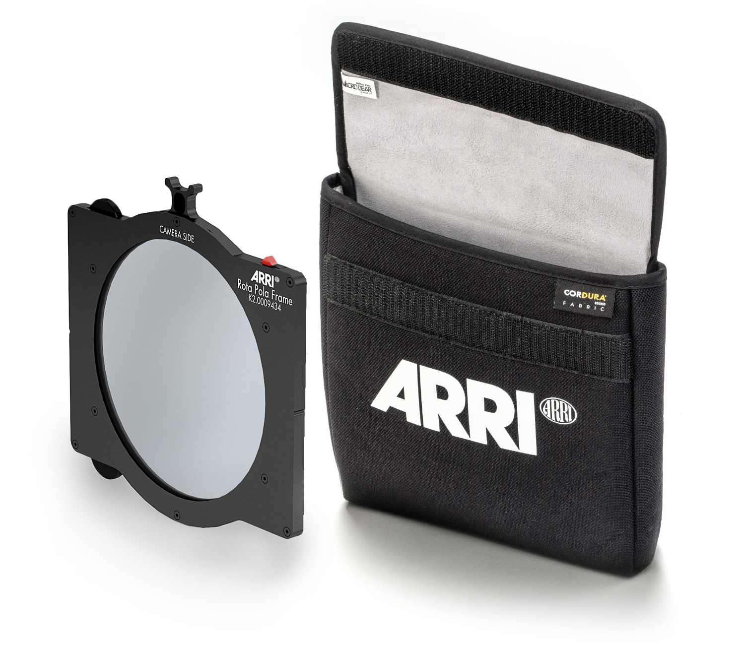

Rota Pola Frame
The ARRI Rota Pola Frame combines a high-quality circular polarizer in an easy to use 4 x 5.65” filter frame. Adjust the polarizer with wheels located on the top and the bottom of the frame, and lock the rotation with a click to ensure that the chosen position doesn’t shift during operation. Each Rota Pola Frame ships in a tough CORDURA® pouch, with a soft, anti-static MICRODEAR® lining.
Explore the Rota Pola Frame

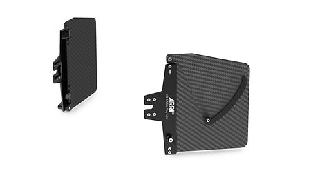

Side Flags
For extra flare protection, a pair of adjustable carbon-fiber side flags can be quickly attached to the LMB 4x5. Side flags fold flat across the front of the matte box for storage, and require separate side flag holders to attach to an LMB 4x5.

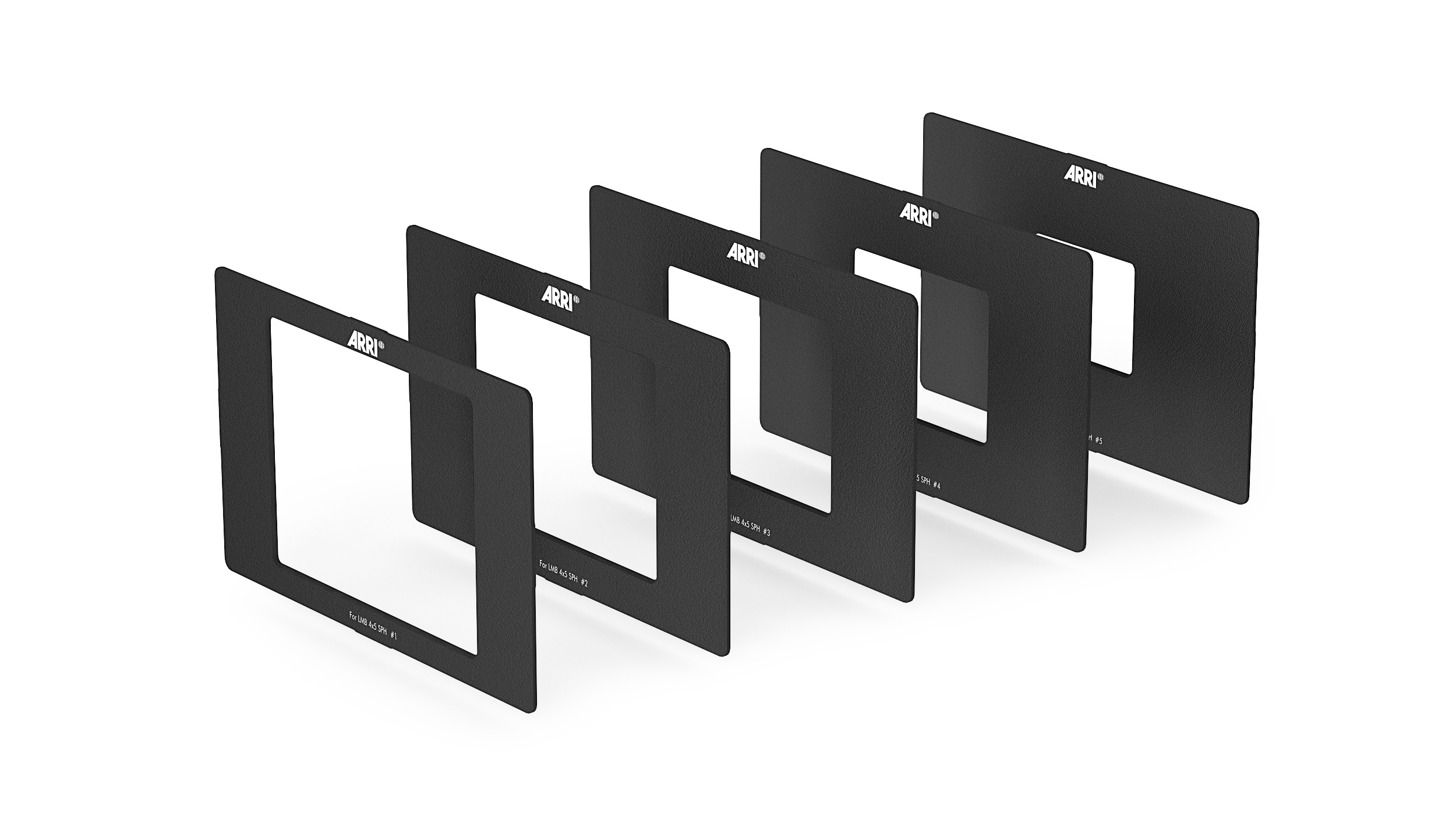

Mattes
Hard mattes snap into both the standard sunshade and flexible rubber sunshade for superb flare control. Both Anamorphic and Spherical Mattes are available to suit a wide range of shooting aspect ratios, and come in five separate sizes for different focal lengths.
