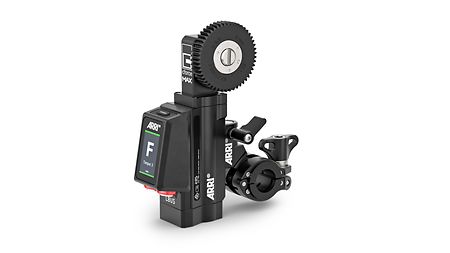

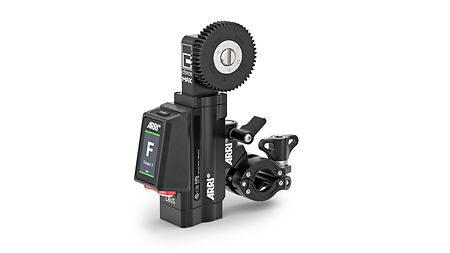

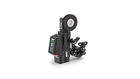

cforce MAX - the ARRI lens motor that combines exceptional speed and strength with intelligent onboard control. Compact and lightweight despite being so fast and powerful, it offers versatile mounting, easy setup and control, and total reliability in the most demanding shooting environments.
KK.0055606 cforce max basic kit 15mm
MAX speed
  • Market-leading low latency
  • Speeds of up to 400 teeth per second
  • Advanced brushless motor
  • Ideal for focus tracking systems
cforce max - speed Kopie
MAX power
  • Twice as strong and twice as fast as the cforce mini, and only 15% bigger
  • Twice as fast as the cforce plus, yet 15% smaller and lighter
  • Ideal for large cine primes, zoom lenses, vintage glass, and specialty optics

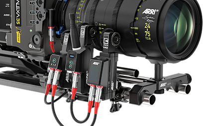

cforce max - camera setup - Signature Zoom - Close-up

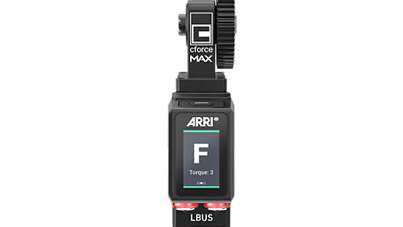

MAX control
  • Integrated touchscreen interface and physical soft touch button
  • Intuitive setup, configuration, and status monitoring
  • Supports manual calibration and fourth auxiliary access control
  • Customizable display with future expandability
cforce max - Display

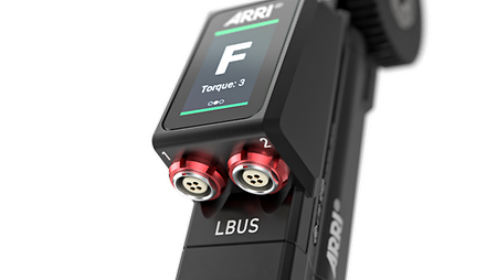

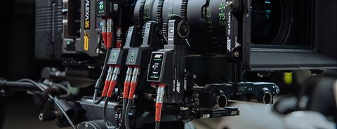

MAX connectivity
  • Dual LBUS ports for seamless daisy-chaining
  • LBUS backwards compatibility
  • Usable with most ARRI mounting brackets, rods, and drive gears
cforce max - LBUS Connectors

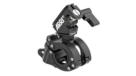

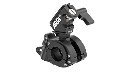

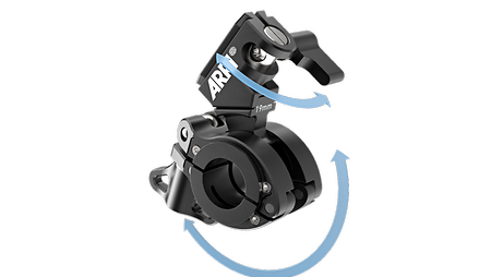

MAX versatility
  • Accompanying Motor Rod Clamp MRC-1 provides rock-solid connection
  • Easy adjustment on 19 mm and 15 mm rods
  • Reduced form factor ideal for handheld, gimbal, and studio configurations
cforce max - Motor Rod Clamp MRC-1 - Moving Parts

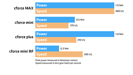

Experience unrivalled speed and responsiveness
cforce motors comparison

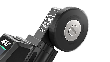

  • The motor is primarily designed for focus and zoom applications that require both high speed and high torque. This includes use with mechanically demanding lenses as well as fast focus and zoom movements.
  • Gear choice directly impacts speed and torque transmission. For high torque demand, a 40t gear achieves up to 320 teeth per second. The default 50t gear achieves up to 400 teeth per second.

  • Multiple motors can be connected in series via LBUS, typically up to three units in a daisy chain. Additional power is supplied via a separate cable connection from the motor to the battery using an LBUS-to-D-Tap cable. This is particularly recommended when the camera does not provide sufficient power via its LBUS or LCS port, such as in setups using the ARRI ALEXA Mini LF. In practice, additional power should be considered when using multiple motors or in high-load applications to ensure reliable calibration and performance.
  • The motor can be mounted to 15 mm or 19 mm support rods using the Clamp Console 2 or the Motor Rod Clamp MRC-1. Both clamps are mounted to the motor via a dovetail interface, allowing flexible configurations based on the focus puller’s preferences. The Motor Rod Clamp MRC-1 offers a key advantage through its high versatility, supporting a wide variety of rigging setups.
