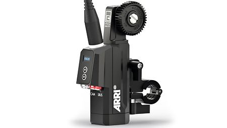

cforce mini RF
Direct wireless control
Small and powerful
This integrated RF-EMIP radio module offers wireless connectivity directly to a Hi‑5 or similar hand unit, removing the need for bulky motor controllers. Lens data files are supported internally, and camera control of ARRI, Sony, and RED cameras is possible. The cforce mini RF offers a speed of 240 teeth/sec.

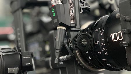

Integrated wireless module
  • Built-in white-coded RF radio module eliminates the need for an external motor-controller such as RIA‑1, AMC-1, UMC-4
  • Direct wireless control with up to three hand units for simultaneous F/I/Z/AUX control (compatible with Hi‑5, Hi‑5 SX, ZMU‑4, WCU‑4, and SXU-1)
  • Functions as a radio host, with 14 selectable RF channels for reliable operation
  • Allows compact camera builds, reducing system complexity and setup time

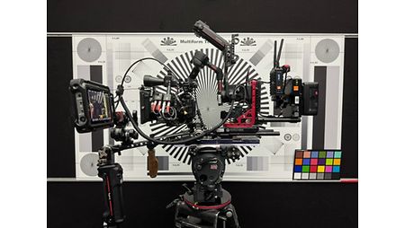

Brian_cforce mini RF_1

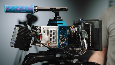

cforce mini RF with RED camera

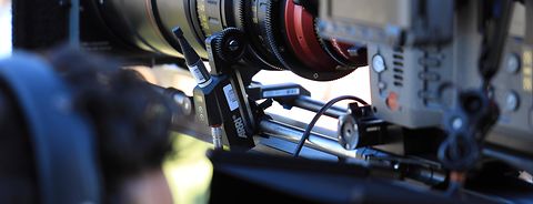

ARRI Australia cforce mini RF_2

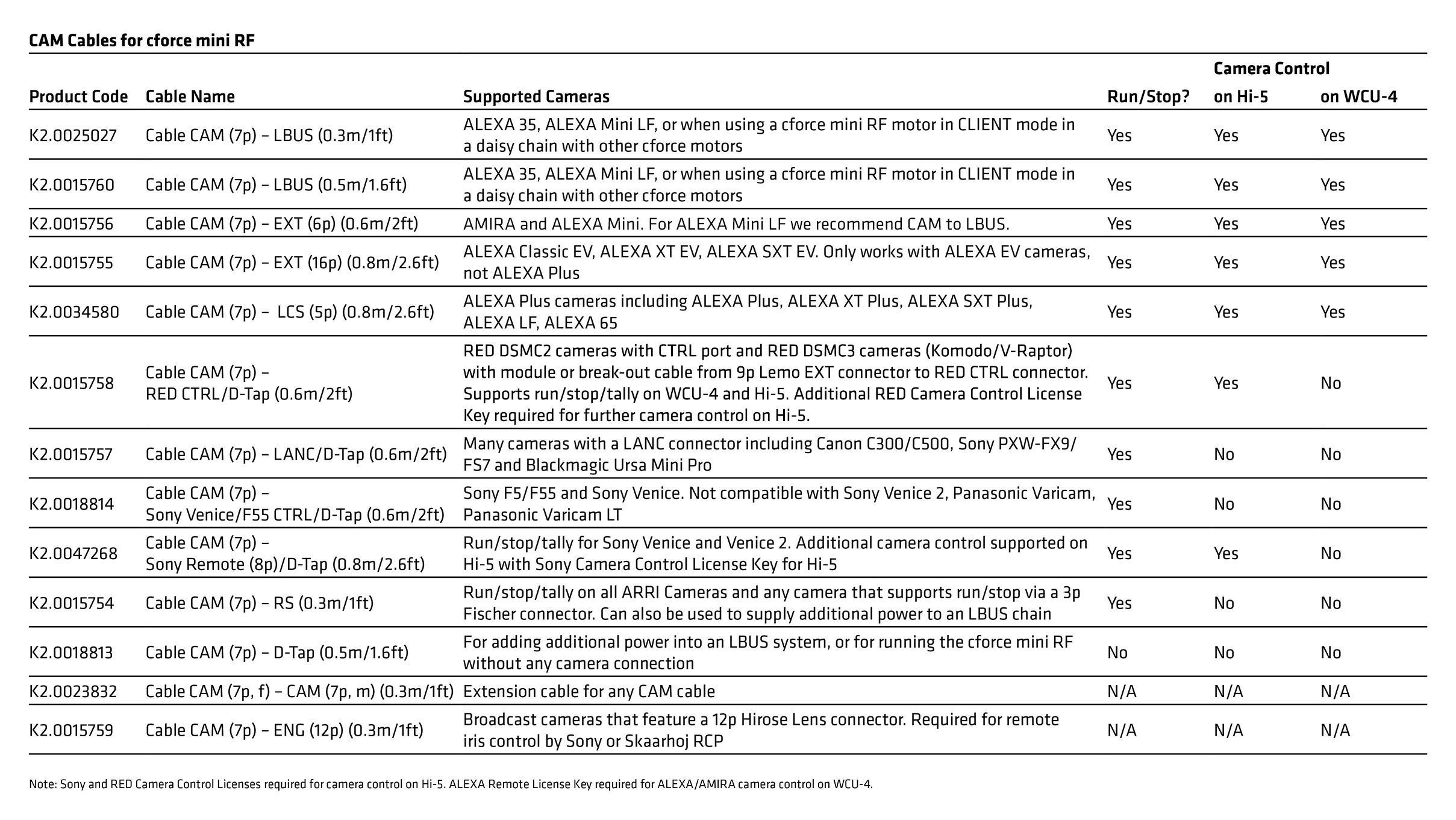

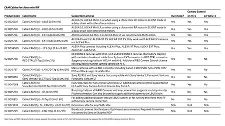

CAM cables for cforce mini RF
