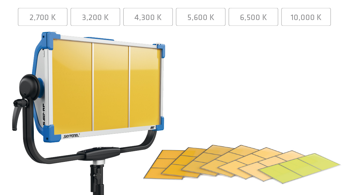

The SkyPanel was designed to be used primarily as a soft light to illuminate people. However, features were also designed into the fixture to make it extremely versatile. The diffusor panels on the front of the lamphead are interchangeable, so going from a heavy diffusion to a lite diffusion can be done in a matter of seconds.
Big range of professional lighting accessories are available to meet different application needs and using habits: from SkyBender, Eggcrate, FlexDoor to Honeycomb ; from lightbank, SnapGrid, Octagon, to Lantern; from mounting Yokes to transport case. Big range of accessories provides the easy and accurate way for lighting creation.

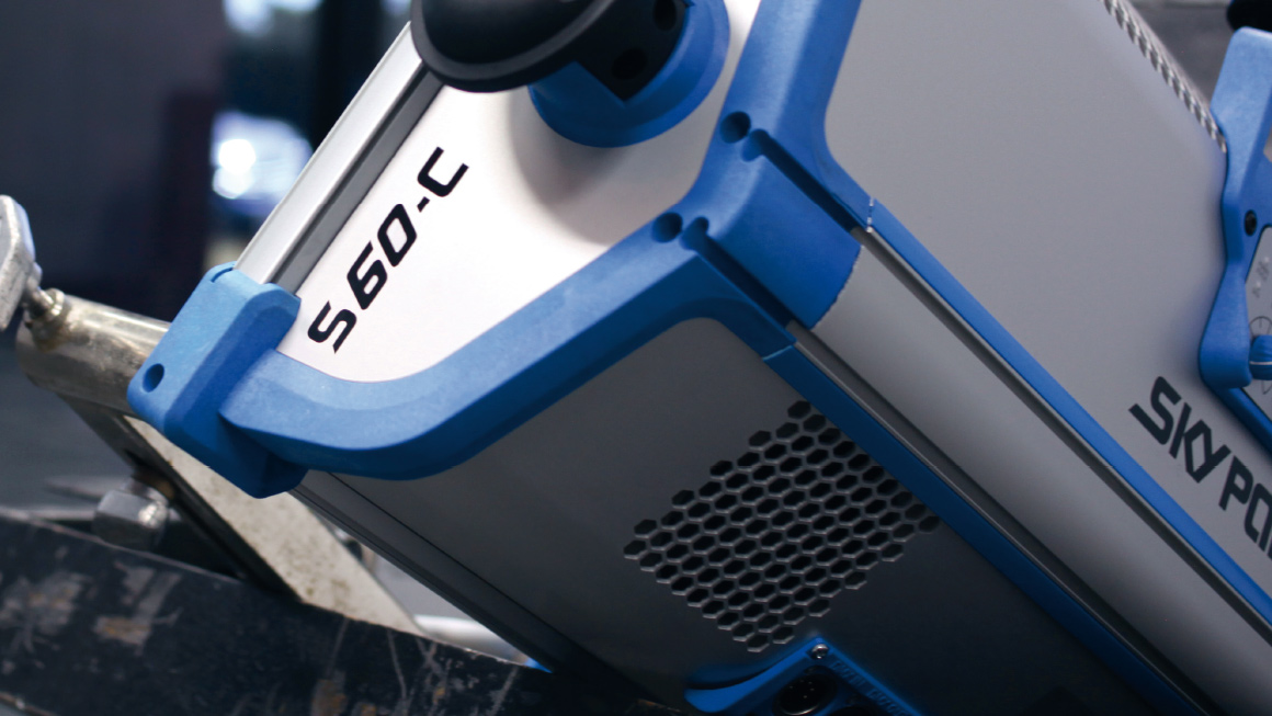

Built to Last. Constructed with great care from durable materials.
Made in Germany to the high standards for which all ARRI products are known, SkyPanel is built to last – constructed from resilient materials and assembled by hand with great care. The combination of an aluminum core with fiberglass-reinforced thermoplastics results in a solid fixture that can withstand heavy daily use on busy film sets.
The electronics have been designed to last beyond a minimum of 25,000 hours, and to be easily serviceable. The LED light engine even allows for recalibration, further enhancing SkyPanel’s credentials as a long-lasting, high-quality fixture. As with all ARRI products, a high return on investment is ensured by uncompromising engineering standards.
