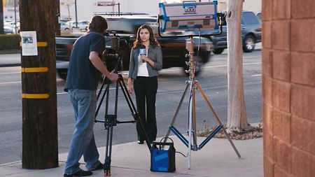

While the SkyPanel was designed to be used primarily as a soft light to illuminate people, various built-in features make it extremely versatile. The diffusor panels on the front of the lamphead are interchangeable, so going from the Heavy Diffusion panel to the Lite Diffusion can be done in a matter of seconds, and further diffusion accessories are planned. With the on-board battery input, SkyPanel can be run off industry-standard batteries for untethered soft light requirements. The S60 can be operated at up to 50% of its total power on battery, and the S30 can be used at full power.
