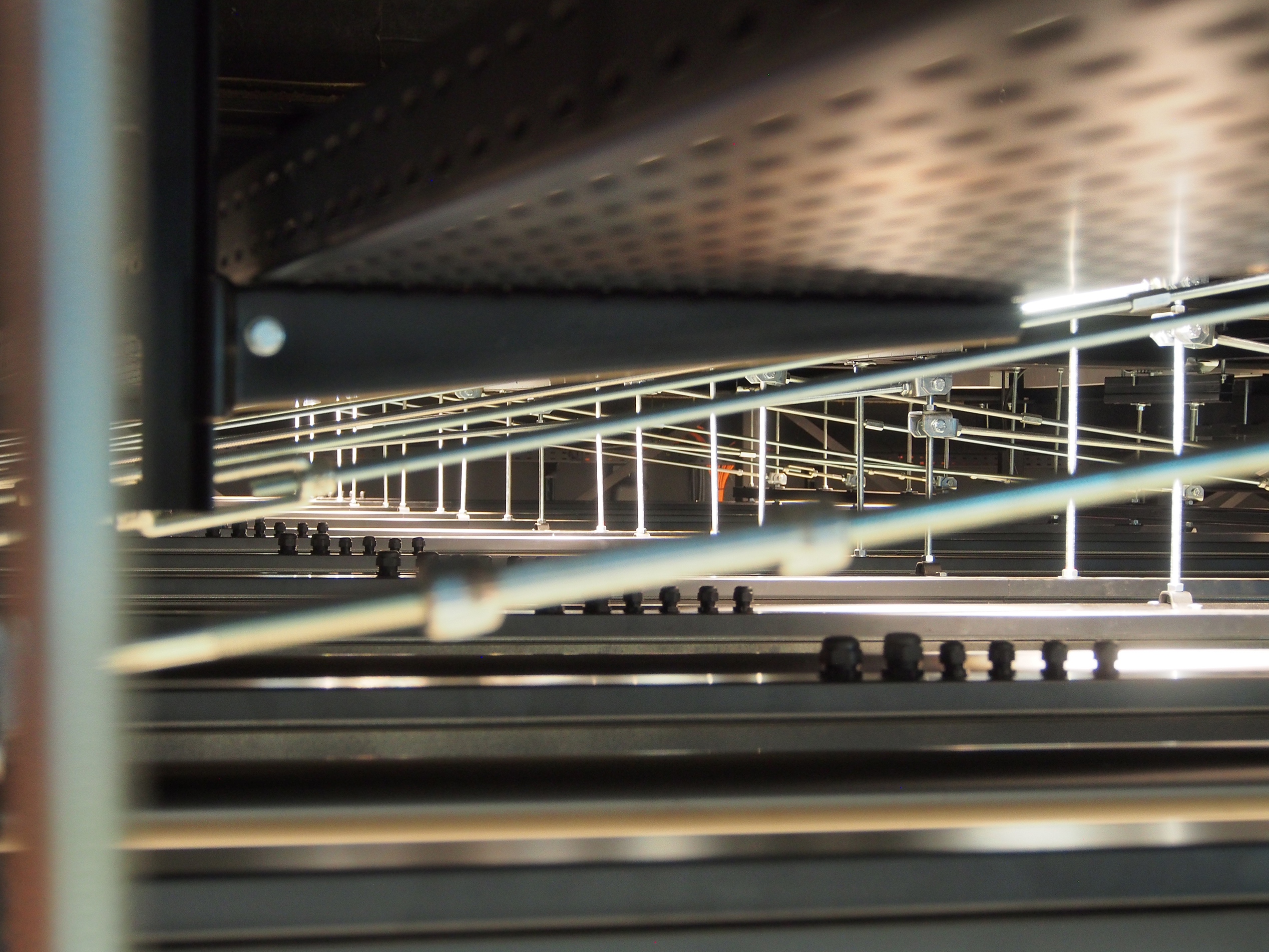

Turnkey: Lighting network, -control, suspension (pipe system) incl. power distribution of both studios and for all systems

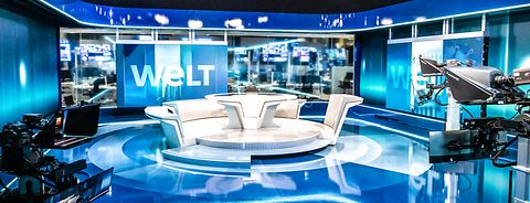

At the new Axel Springer Campus in the heart of Berlin, WeltN24 has commissioned two state-of-the-art TV studios for the station WELT. The new studios are not only an architectural statement for the digital tomorrow. Both news studios are equipped with Ethernet/IP-capable lighting fixtures throughout, enabling IP-end-to-end communication and, therefore, efficient workflows that are fully integrated into the broadcast infrastructure. The ARRI Solutions Group handled the consulting, planning, and turnkey installation of the studio lighting and control systems on behalf of the system integrator Qvest Media and in close partnership with the planning office mo2 design.

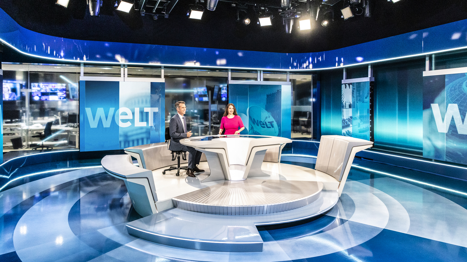

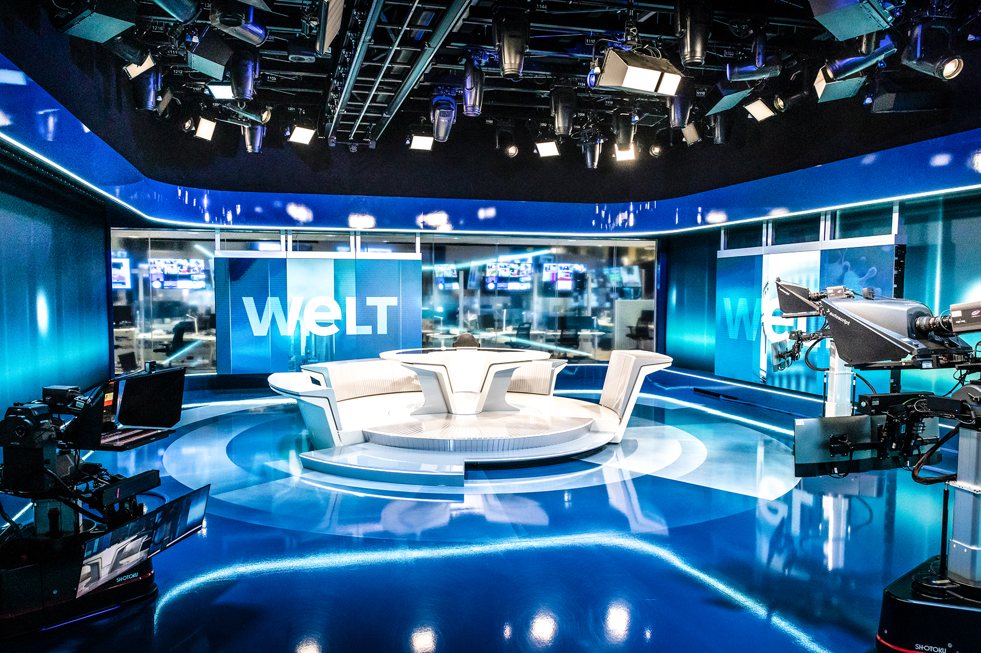

WELT’s two TV studios enable closer networking and collaboration with digital and print. This exchange is also reflected in the visual concept of the studios, each measuring 175 m² (1,938 sq. ft.) and 5.5 m (18 ft.) high. Glass fronts in Studio 1 ensure transparency, visibility, and interaction. Particular challenges in terms of the lighting design were also the motorized and movable LED video panels on three sides and a required minimum range of movement for the presenters on set without changing the lighting fixture positions. After extensive testing, a total of 100 soft lights of the ARRI SkyPanel series (S60-C, S30-C) and Moving Lights with the Fresnel characteristics from Robe Lighting were chosen. These are supplemented by LED bars which are affixed to the top of the motorized video panels to direct an appropriate backlight onto the presenters.
In Studio 2, especially for the green box, ARRI’s SkyPanels with different apertures (S120-C, S60-C, S30-C) were specified to achieve optimal light distribution according to templates of photometric simulations created by ARRI Solutions Group. An important criterion for selecting the type of lighting was a certain quality level—this enables the fixtures to meet the requirements of an HD/UHD environment in the long term. These include the level of color rendering index, options for color temperatures adjustments, calibration standards used for the LEDs, and their service life.
