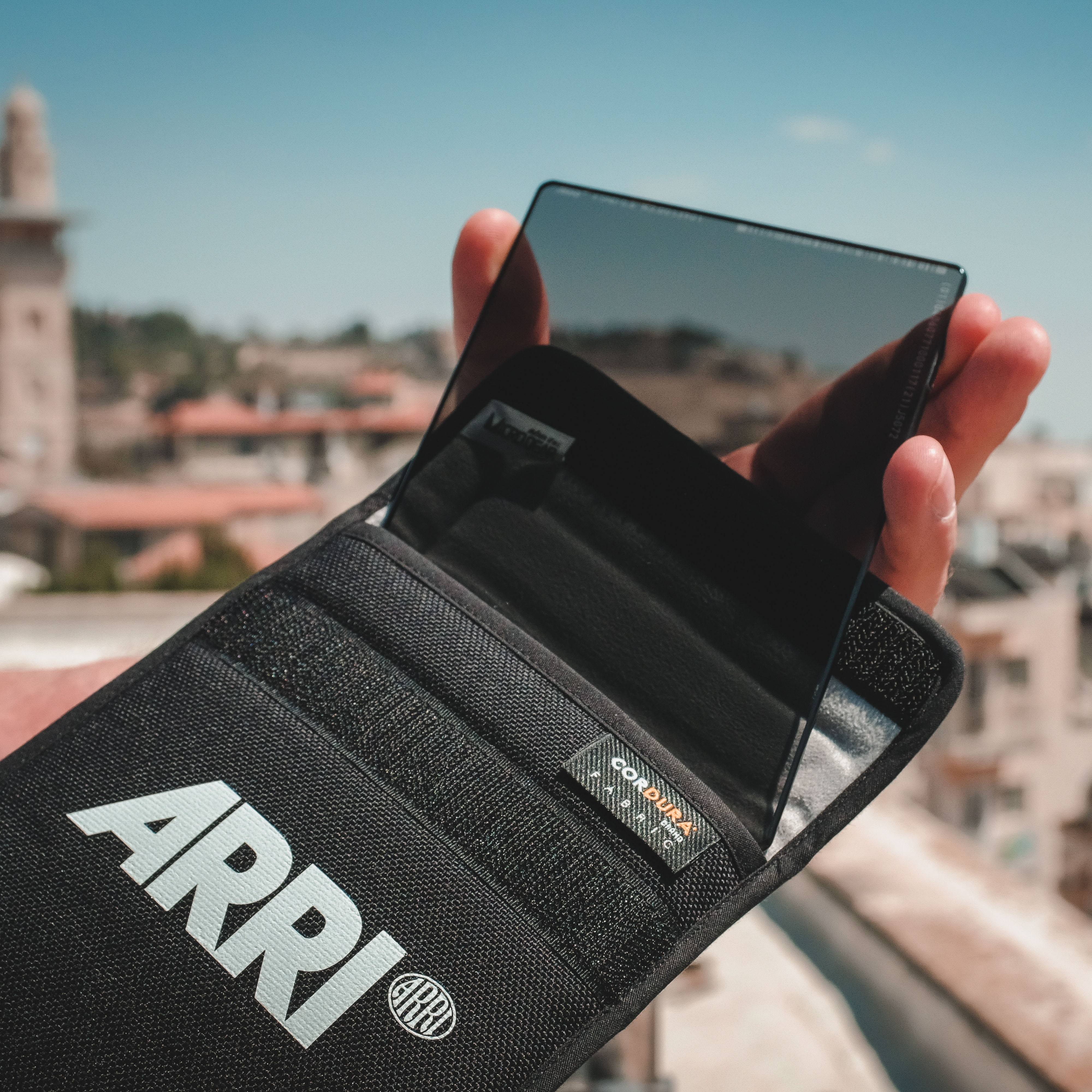

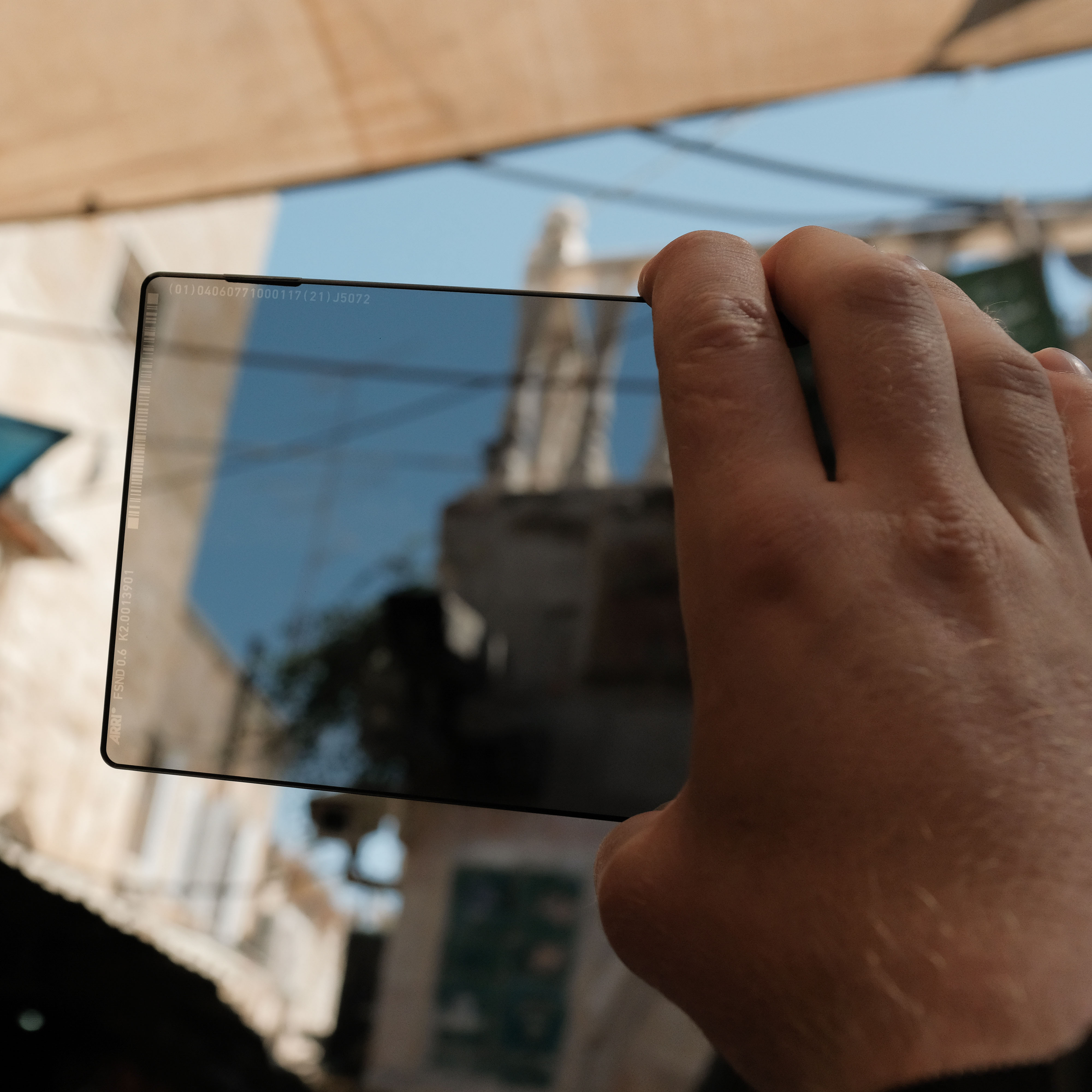

Many creative choices are difficult, but your choice of neutral density filters shouldn't be. ARRI Full-Spectrum Neutral Density (FSND) filters offer superior image control with maximum flexibility and no optical compromise.
UHD and HDR are the future of filmmaking. With increased image quality comes the need for superior optical quality. Low-cost filters introduce artifacts such as flare, glare, reduced color saturation, and optical distortions, all of which compromise the integrity of high dynamic range and wide color gamut images.
Many manufacturers sandwich the filtration material between two pieces of glass, which can introduce astigmatism and other optical distortions. ARRI FSND filters are surfaced coated, with highly-polished high optical quality glass as a base. They are distortion free, even when used in conjunction with long focal length lenses.
ARRI FSND filters leave image control to the cinematographer. They are perfectly color neutral, exceptionally resistant to flare and glare, protective of the color within the scene, and introduce no discernible image distortions at even the longest focal lengths. Most importantly, they eliminate far red ("IR") contamination without affecting skin tone.

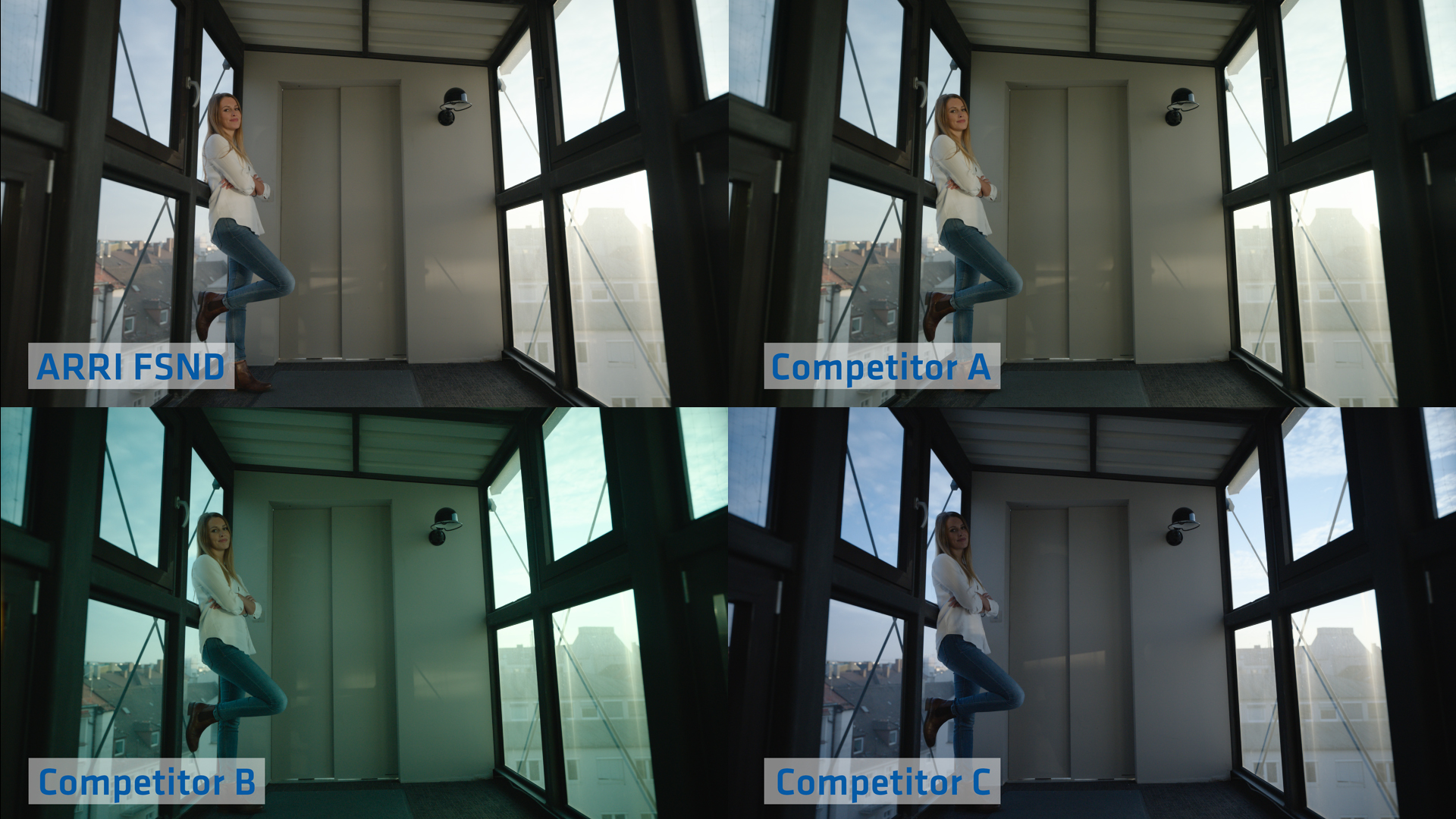

Film is insensitive to red at the edge of the visible spectrum. Film NDs are transparent to this frequency range of light. Digital sensors require a small amount of this “far red” light to render skin tone as healthy and vibrant, but traditional film NDs are not spectrally balanced for digital requirements: they cut most visible light, but pass too much far red. This causes color distortions that cannot be corrected in post.
Early filter attempts by other manufacturers resulted in overcompensation, rendering skin tones as dull and pasty. These filters worked on some cameras, but not all. ARRI FSND filters preserve color balance perfectly, eliminating color distortions and preserving lush skin tones. They are universal filters that produce the same high-quality result with every camera.

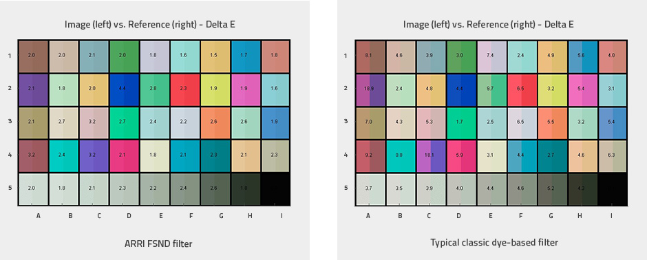

Results of color difference in transmittance for an ARRI FSND filter (left) and a typical classic dye-based filter (right).
The inset numbers are C I E 2000(1:1:1).
ΔE ≤ 1.5 : Slight
1.5 < ΔE ≤ 3 : Noticeable
3 < ΔE ≤ 6 : Appreciable color difference

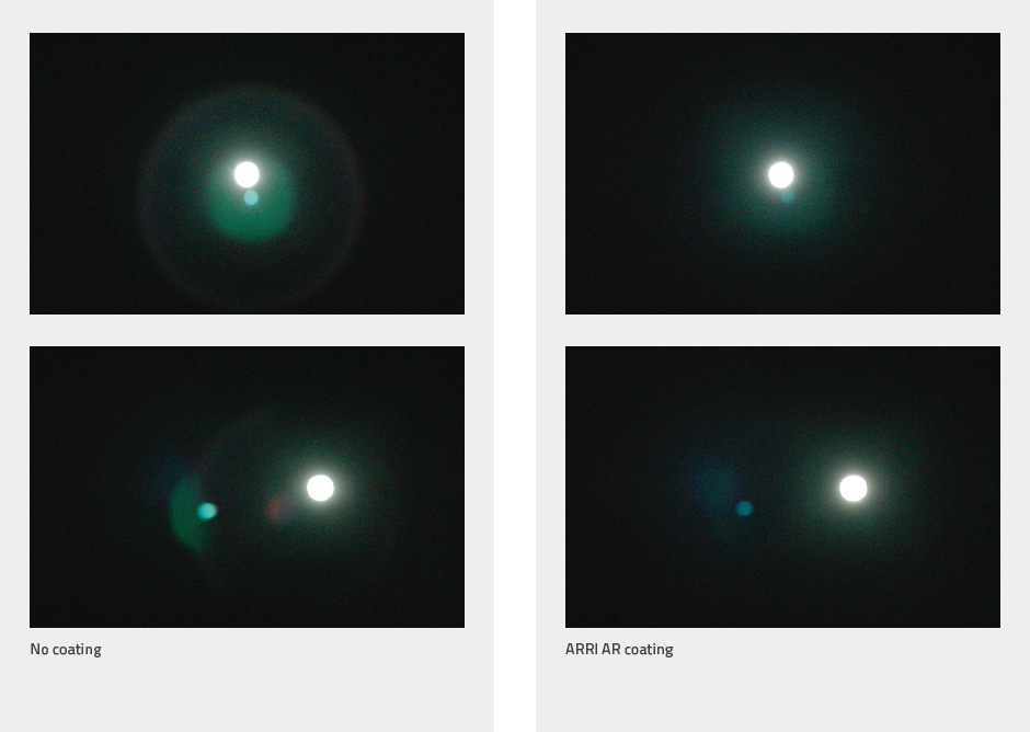

Anti-Reflective Coating
For ease of access and replacement, MPTV filters are positioned in a matte box in front of a lens. While this position is convenient, it is optically delicate, and can result in flare-like ghost reflections being focused onto the imaging sensor. The severity of visibility of this stray light is proportional to spectral radiance, which usually increases with focal length. But it is also highly dependent on the specific optical design of the deployed lens, and the associated stray light paths.
Whether this stray light is regarded as problematic, or artistically valuable, lies in the eye of the beholder, and their specific imaging requirements. To facilitate a choice to the DP, and to avoid distraction from the objective lens’ flare, ARRI FSND filters are equipped with low reflective coatings on the smooth optical surfaces, and blackening of the edge surfaces.
