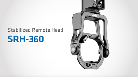

Stabilized Remote Head SRH-360
Powerful and extremely flexible
The SRH‑360 is an upgraded version of ARRI's SRH‑3.
The major improvement with the SRH‑360 is to the pan axis functionality: A new slip ring permits unlimited rotation of the head. At the same time, the torque of the pan motor has been increased by 50%, allowing it to compensate for powerful centrifugal forces when shooting high-speed camera moves. This makes the SRH‑360 even more flexible for dynamic environments such as action, stunts, vehicle work, sports, and live music performances.

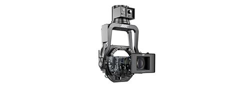

Technical data SRH-360
Stabilized Axis
3 (Pan, Tilt, Roll)
Max. Payload
up to 30Kg/66lbs
Height
65,2cm/25.67in
Width
41,2cm/16.22in
Depth Head
15 cm/5.9in
Depth Base
24,6cm/9.68in
Ring Diameter
26cm/10.23in
Ring Height centre
20,9cm/8.23in
Weight
11,6Kg/25.57lbs
Max. Tilt Range
+60° / - 110°
Max. Roll Range
+/- 90°
Max. Pan Range
Slip Ring, Unlimited
Max. Pan Rate
240° / Sec.
Max. Tilt Rate
240° / Sec.
Operating Voltage Head
24V - 36V
Output Camera
12V & 24V
Current
10 Amps
LBUS socket
Yes
RS socket
Yes
Video
up to 12 G single link support
SAM plates compatible
Yes
Environmental
-20° to +50° / -4° F to 122° F
