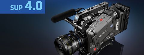

AMIRA Hero
AMIRA SUP 4.0 Enables S16 Lens Ability and Refines Multicam Functions
(NAB 2016, LAS VEGAS) – Following customer feedback worldwide ARRI is introducing a ProRes S16 HD recording mode for Super 16, in addition to refinements for the powerful Multicam features with AMIRA Software Update Package (SUP) 4.0.
