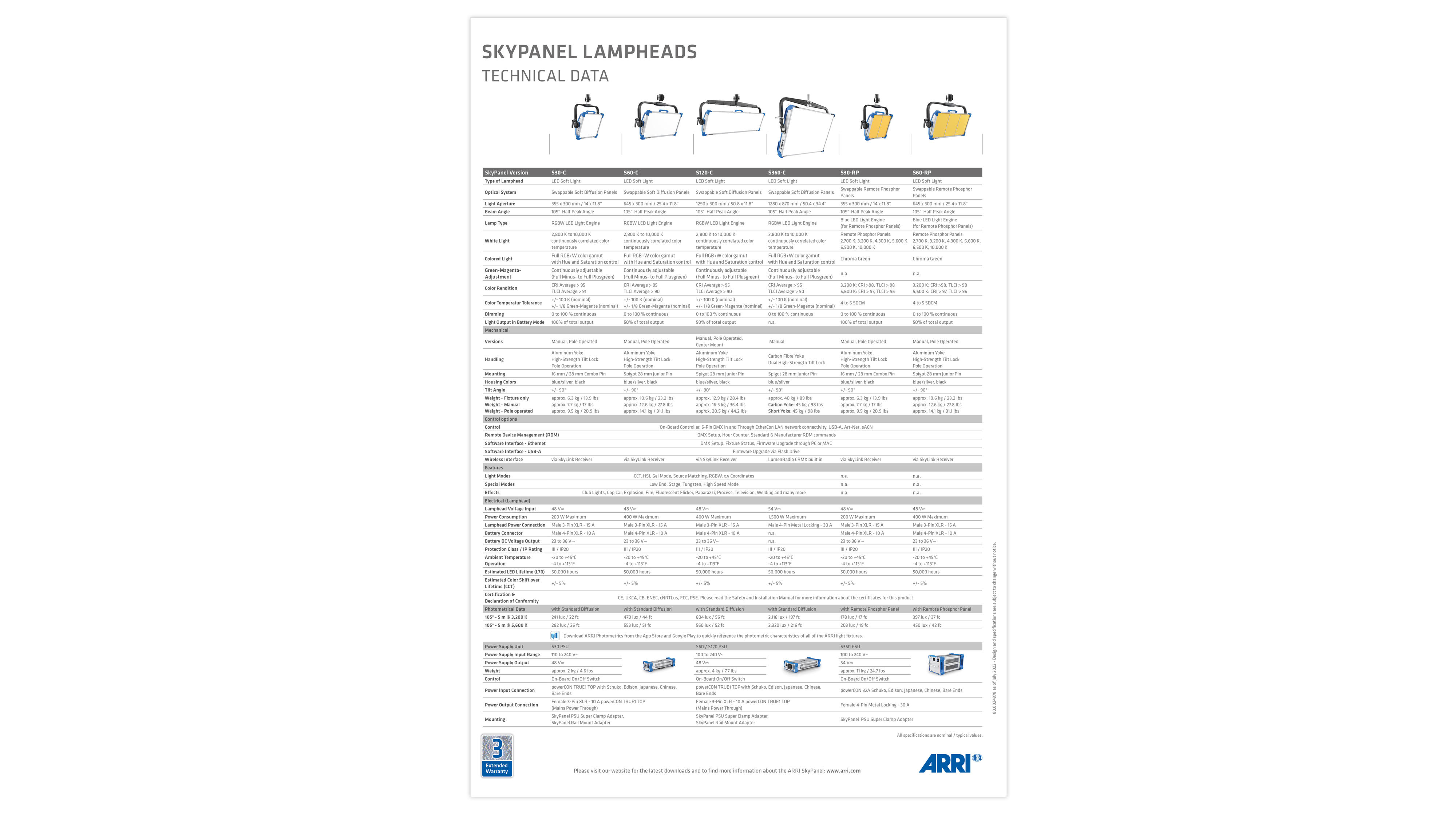

Technical data for SkyPanel
Tech specs and downloads
Get the latest technical data on the SkyPanel family with this comprehensive overview. Wattage, lumens, and more - all here in one place.
Get the ARRI Photometric App today and easily access essential technical data related to all ARRI light fixtures. With this app you can get instant access to comprehensive technical specifications, photometric characteristics, and other important information.
Category
LED
Series
SkyPanel
Model
Optical System
S30-C: Soft Diffusion Panel
S60-C: Soft Diffusion Panel
S120-C: Soft Diffusion Panel
S360-C: Swappaple Soft Diffusion Panel
S30-RP: Remote Phosphor Panel
S60-RP: Remote Phosphor Panel
Weight in kg / lbs net*
S30-C: Manual Version: approx. 7.7 kg / 17.0 lbs
Pole Operated Version: approx. 9.5 kg / 20.9 lbs
Fixture only, incl. Diffusion: approx. 6.3 kg / 13.9 lbs
S60-C: Manual Version: approx. 12.6 kg / 27.8 lbs
Pole Operated Version: approx. 14.1 kg / 31.1 lbs
Fixture only, incl. Diffusion: approx. 10.6 kg / 23.2 lbs
S120-C: Manual Version: approx. 16.5 kg / 36.4 lbs
Pole Operated Version: approx. 20.5 kg / 44.2 lbs
Fixture only, incl. Diffusion: approx. 12.9 kg / 28.4 lbs
S360-C: Incl. Carbon Fiber Yoke and Spigot approx.: 45 kg / 98 lbs
Incl. short Yoke approx.: 45 kg / 98 lbs
Fixture only, incl. Diffusion: approx. 40 kg / 89 lbs
S30-RP: Manual Version: approx. 7.7 kg / 17.0 lbs
S60-RP: Manual Version: approx. 12.6 kg / 27.8 lbs
Weight in kg / lbs net packed*
S30-C: Manual Version: approx. 14 kg / 31 lbs
Pole Operated Version: approx. 16 kg / 34 lbs
S60-C: Manual Version: approx. 21 kg / 46 lbs
Pole Operated Version: approx. 22 kg / 49 lbs
S120-C: Manual Version: approx. 26 kg / 57 lbs
Pole Operated Version: approx. 29 kg / 65 lbs
Center Mount Version approx.: 24 kg / 53 lbs
S360-C: -
S30-RP: Manual Version: approx. 14 kg / 31 lbs
S60-RP: Manual Version: approx. 21 kg / 46 lbs
Measurements (HxWxL) incl. Pin in mm / inch*
499 x 507 x 133 mm / 19.6 x 19.9 x 5.2"
567 x 504 x 133 mm / 22.3 x 19.8 x 5.2"
566 x 826 x 133 mm / 22.3 x 32.5 x 5.2"
567 x 796 x 133 mm / 22.3 x 31.3 x 5.2"
588 x 1467 x 133 mm / 23.1 x 57.7 x 5.2"
615 x 1439 x 133 mm / 24.2 x 56.6 x 5.2"
S360-C:
1237 x 1594 x 203 mm / 48.7 x 62.8 x 8.0"
Measurements (HxWxL) excl. Pin in mm / inch*
426 x 507 x 133 mm / 16.8 x 19.9 x 5.2"
452 x 504 x 133 mm / 17.8 x 19.8 x 5.2"
433 x 826 x 133 mm / 17.0 x 32.5 x 5.2"
452 x 796 x 133 mm / 17.8 x 31.3 x 5.2"
473 x 1467 x 133 mm / 18.6 x 57.7 x 5.2"
500 x 1439 x 133 mm / 19.7 x 56.6 x 5.2"
S360-C:
1122 x 1594 x 203 mm / 44.2 x 62.8 x 8.0"
Measurements (HxWxL) Packed size in mm / inch*
S30-C: 470 x 665 x 300 mm / 18.5 x 26.2 x 11.8"
S60-C: 470 x 860 x 300 mm / 18.5 x 33.9 x 11.8"
S120-C: 500 x 1500 x 300 mm / 19.7 x 59.1 x 11.9"
S360-C: -
S30-RP: 470 x 665 x 300 mm / 18.5 x 26.2 x 11.8"
S60-RP: 470 x 860 x 300 mm / 18.5 x 33.9 x 11.8"
Housing Color
S30-C: Blue/Silver, Black
S60-C: Blue/Silver, Black
S120-C: Blue/Silver, Black
S360-C: Blue/Silver
S30-RP: Blue/Silver, Black
S60-RP: Blue/Silver, Black
Power Consumption
S30-C: 200 W Maximum
S60-C: 400 W Maximum
S120-C: 400 W Maximum
S360-C: 1500 W Maximum
S30-RP: 200 W Maximum
S60-RP: 400 W Maximum
Lamphead Voltage Input
S30-C: 48 V DC
S60-C: 48 V DC
S120-C: 48 V DC
S360-C: 54 V DC
S30-RP: 48 V DC
S60-RP: 48 V DC
S30-C: 355 x 300 mm
S60-C: 645 x 300 mm
S120-C: 1290 x 300 mm
S360-C: 1280 x 870 mm
S30-RP: 355 x 300 mm
S60-RP: 645 x 300 mm
S30-C: 14.0 x 11.8"
S60-C: 25.4 x 11.8"
S120-C: 50.8 x 11.8"
S360-C: 50.4 x 34.4"
S30-RP: 14.0 x 11.8"
S60-RP: 25.4 x 11.8"
Beam Angle
105° (Half Peak Angle)
Handling
S30-C: Aluminium Yoke, High-Strength Tilt Lock / Steel Yoke, Pole Operation for Pan & Tilt
S60-C: Aluminium Yoke, High-Strength Tilt Lock / Steel Yoke, Pole Operation for Pan & Tilt
S120-C: Aluminium Yoke, High-Strength Tilt Lock / Steel Yoke, Pole Operation for Pan & Tilt / Center Mount Yoke
S360-C: Carbon Fiber Yoke, Dual High-Strength Tilt Lock
S30-RP: Aluminium Yoke, High-Strength Tilt Lock / Steel Yoke, Pole Operation for Pan & Tilt
S60-RP: Aluminium Yoke, High-Strength Tilt Lock / Steel Yoke, Pole Operation for Pan & Tilt
Mounting
S30-C: 16 mm / 28 mm Combo Pin (Baby 5/8" / Junior 1-1/8" Combo.Pin) / 28 mm Spigot (Junior Pin)
S60-C: 28 mm Spigot (Junior Pin)
S120-C: 28 mm Spigot (Junior Pin)
S360-C: 28 mm Spigot (Junior Pin)
S30-RP: 16 mm / 28 mm Combo Pin (Baby 5/8" / Junior 1-1/8" Combo.Pin) / 28 mm Spigot (Junior Pin)
S60-RP: 28 mm Spigot (Junior Pin)
Tilt Angle
+/- 90°
Lamphead Power Connection
S30-C: Male 3-Pin XLR - 15 Amp (Pin 1: Negative / Pin 2: Positive)
S60-C: Male 3-Pin XLR - 15 Amp (Pin 1: Negative / Pin 2: Positive)
S120-C: Male 3-Pin XLR - 15 Amp (Pin 1: Negative / Pin 2: Positive)
S360-C: Male 4-Pin Metal Locking - 30 Amp
S30-RP: Male 3-Pin XLR - 15 Amp (Pin 1: Negative / Pin 2: Positive)
S60-RP: Male 3-Pin XLR - 15 Amp (Pin 1: Negative / Pin 2: Positive)
Battery Connector
S30-C: Male 4-Pin XLR - 10 Amp (Pin 1: Negative / Pin 4: Positive)
S60-C: Male 4-Pin XLR - 10 Amp (Pin 1: Negative / Pin 4: Positive)
S120-C: Male 4-Pin XLR - 10 Amp (Pin 1: Negative / Pin 4: Positive)
S360-C: -
S30-RP: Male 4-Pin XLR - 10 Amp (Pin 1: Negative / Pin 4: Positive)
S60-RP: Male 4-Pin XLR - 10 Amp (Pin 1: Negative / Pin 4: Positive)
Battery DC Voltage Range
S30-C: 23 to 36 V DC
S60-C: 23 to 36 V DC
S120-C: 23 to 36 V DC
S360-C: -
S30-RP: 23 to 36 V DC
S60-RP: 23 to 36 V DC
Battery Mode Light Output
S30-C: 100 % of total output
S60-C: 50 % of total output
S120-C: 50 % of total output
S360-C: -
S30-RP: 100 % of total output
S60-RP: 50 % of total output
White Light
For -C models: 2,800 K to 10,000 K continuously variable correlated color temperature
For-RP models: Changeable Remote Phosphor Panels:
2,700 K; 3,200 K; 4,300 K; 5,600 K; 6,500 K;
10,000 K & Chroma Green
Colored Light
For -C models: Full RGB+W Color Gamut with Hue and Saturation Control
For -RP models: -
Color Temperature Tolerance
For -C models: +/- 100 K (nominal), +/- 1/8 Green-Magenta (nominal)
For -RP models: 4 to 5 SDCM
Color Rendition
For -C models: CRI Average > 95, TLCI Average > 91
For -RP models:
2,700K: CRI > 98, TLCI > 98,
3,200K: CRI > 98, TLCI > 98,
4,300K: CRI > 97, TLCI > 96,
5,600K: CRI > 97, TLCI > 96,
6,500K: CRI > 96, TLCI > 94,
10,000K: CRI > 92, TLCI > 88
Green-Magenta Adjustment
For -C models: Continuously adjustable (Full Minusgreen to Full Plusgreen)
For -RP models: -
Dimming
0 to 100 % continuous
On-Board Controller, 5-Pin DMX In and Through, EtherCon LAN network connectivity, USB-A, Art-Net
Wireless Control
S30-C: Not integrated, via SkyLink
S60-C: Not integrated, via SkyLink
S120-C: Not integrated, via SkyLink
S360-C: LumenRadio CRMX (DMX & RDM)
S30-RP: Not integrated, via SkyLink
S60-RP: Not integrated, via SkyLink
Software / Mini-USB Interface
S30-C: Ethernet: DMX Setup, Fixture Status and Firmware Upgrade through PC, Mac USB-A: Software Upgrade via flash drive
S60-C: Ethernet: DMX Setup, Fixture Status and Firmware Upgrade through PC, Mac USB-A: Software Upgrade via flash drive
S120-C: Ethernet: DMX Setup, Fixture Status and Firmware Upgrade through PC, Mac USB-A: Software Upgrade via flash drive
S360-C: Ethernet: DMX Setup, Fixture Status & Control and Firmware Upgrade through PC or Mac, USB-A: Software Upgrade via flash drive
S30-RP: Ethernet: DMX Setup, Fixture Status and Firmware Upgrade through PC, Mac USB-A: Software Upgrade via flash drive
S60-RP: Ethernet: DMX Setup, Fixture Status and Firmware Upgrade through PC, Mac USB-A: Software Upgrade via flash drive
Ambient Temperature Operation
-20 to +45° C (-4 to +113° F)
Protection Class / IP Rating
III / IP 20
Estimated LED Lifetime (L70)
50,000 hours
+/- 5 %
Certifications
Power Supply Unit
S30-C: S30 PSU
S60-C: S60/S120 PSU
S120-C: S60/S120 PSU
S360-C: S360 PSU
S30-RP: S30 PSU
S60-RP: S60/S120 PSU
Power Supply Input Range
S30-C: 110 to 240 V ~, 50/60 Hz
S60-C: 100 to 240 V ~, 50/60 Hz
S120-C: 100 to 240 V ~, 50/60 Hz
S360-C: 100 to 240 V ~, 50/60 Hz
S30-RP: 110 to 240 V ~, 50/60 Hz
S60-RP: 100 to 240 V ~, 50/60 Hz
Power Supply Output Range
S30-C: 48 V DC
S60-C: 48 V DC
S120-C: 48 V DC
S360-C: 54 V DC
S30-RP: 48 V DC
S60-RP: 48 V DC
Power Input Connection
S30-C: powerCON TRUE1 (Bare Ends / Schuko / Edison)
S60-C: powerCON TRUE1 (Bare Ends / Schuko / Edison)
S120-C: powerCON TRUE1 (Bare Ends / Schuko / Edison)
S360-C: powerCON 32A (Bare Ends / Schuko / Edison / China / Japan)
S30-RP: powerCON TRUE1 (Bare Ends / Schuko / Edison)
S60-RP: powerCON TRUE1 (Bare Ends / Schuko / Edison)
Power Output Connection
S30-C: Female 3-Pin XLR to 10 Amp (Pin 1: Negative / Pin 2: Positive) powerCON TRUE1 (mains power through)
S60-C: Female 3-Pin XLR to 10 Amp (Pin 1: Negative / Pin 2: Positive) powerCON TRUE1 (mains power through)
S120-C: Female 3-Pin XLR to 10 Amp (Pin 1: Negative / Pin 2: Positive) powerCON TRUE1 (mains power through)
S360-C: Female 4-Pin Metal Locking - 30 Amp
S30-RP: Female 3-Pin XLR to 10 Amp (Pin 1: Negative / Pin 2: Positive) powerCON TRUE1 (mains power through)
S60-RP: Female 3-Pin XLR to 10 Amp (Pin 1: Negative / Pin 2: Positive) powerCON TRUE1 (mains power through)
Weight in kg
S30-C: approx. 2 kg
S60-C: approx. 4 kg
S120-C: approx. 4 kg
S360-C: approx. 11 kg
S30-RP: approx. 2 kg
S60-RP: approx. 4 kg
Weight in lbs
S30-C: approx. 4.6 lbs
S60-C: approx. 7.7 lbs
S120-C: approx. 7.7 lbs
S360-C: approx. 24.7 lbs
S30-RP: approx. 4.6 lbs

Measurements (HxWxL) in mm*
S30-C: 91 x 115 x 388 mm
S60-C: 91 x 191 x 383 mm
S120-C: 91 x 191 x 383 mm
S360-C: 206 x 240 x 451 mm
S30-RP: 91 x 115 x 388 mm
S60-RP: 91 x 191 x 383 mm
Measurements (HxWxL) in inch*
S30-C: 3.6 x 4.5 x 15.3"
S60-C: 3.6 x 7.5 x 15.1"
S120-C: 3.6 x 7.5 x 15.1"
S360-C: 8.1 x 9.4 x 17.7"
S30-RP: 3.6 x 4.5 x 15.3"
S60-RP: 3.6 x 7.5 x 15.1"
On-Board On/Off Switch
Mounting
S30-C: SkyPanel PSU Super Clamp Adapter / Rail Mount Adapter
S60-C: SkyPanel PSU Super Clamp Adapter / Rail Mount Adapter
S120-C: SkyPanel PSU Super Clamp Adapter / Rail Mount Adapter
S360-C: SkyPanel PSU Super Clamp Adapter
S30-RP: SkyPanel PSU Super Clamp Adapter / Rail Mount Adapter
S60-RP: SkyPanel PSU Super Clamp Adapter / Rail Mount Adapter
Certifications
S30-C: CE, UKCA, CB, ENEC, cNRTLus, PSE
S60-C: CE, UKCA, CB, ENEC, cNRTLus, PSE
S120-C: CE, UKCA, CB, ENEC, cNRTLus, PSE
S360-C: CE, UKCA, CB, ENEC, cNRTLus
S30-RP: CE, UKCA, CB, ENEC, cNRTLus, PSE
S60-RP: CE, UKCA, CB, ENEC, cNRTLus, PSE
Note *Weight and dimensions are rounded values. **Center Mount
